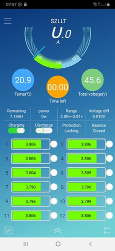

From 0.04 to 0.01 voltage diff in about half a day.
Does wonders this smart BMS.
Just curious…why balance at such a low voltage?
This is a new pack and it was a one time balance. Actually it has a daly bms and I hooked up the smart bms to test it and calibrate the cells before I left them with the daly permanently.
I had cells from two different batches, that’s why the difference in voltage.
You’ll just rebalance them when they are charged?
Yes, I’ll remove the smart bms and reconnect the daly, which will do its thing as usual.
