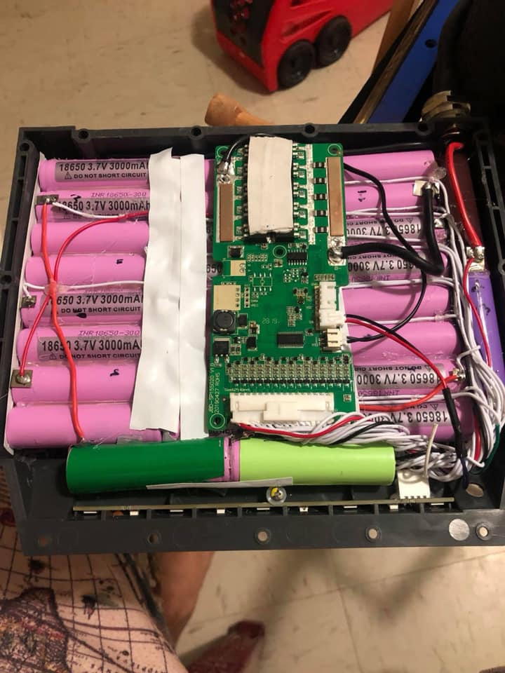

Just to be clear this is NOT MY BATTERY. I would never build something that looked as shitty as this.
This is a 14s2p with bms. Owner claims the case needed some dremel work, and the middle row of battery sits lower in a U shape so the BMS has clearance. If you do this, please do it better.
Thanks for the picture!
Not enough documentation out there
I have some manufacturing and design skills so I think I would have to copy the Two-x bumps in the clearance under the board due to 21700.
I would use HDPE to try to make it bulletproof.
Lol I kinda want to cut part of the foot pad out to get a couple cells right there because there’s so little room below.
Try messaging soren, I just got my two-x repaired by him and he swapped the prototype enclosures out for the nicer injection molded enclosure. If you ask nice, he might sell you the older enclosure. Bolts up nice, and holds quite a bit. I’d just use the rear pad enclosure and offload some of the cells into it. That way the front pad is fully clear for a floatplate and you can do curb tricks with it still.

Do you care about voltage sag at all? The sag of a 1p 40t pack might disappoint you if the onewheel actually does pull high( 20-30 )amps…
30t, although 1000mah less per cell, might be your best bet for a sagless experience
Yeah I just set the date to buy it for friday, I’ll figure out what I can fit but hopefully a 14S2P 21700.
Seems like adding a custom enclosure is very possible. There just isn’t a lot of room to expand into.
