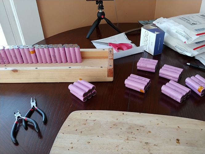

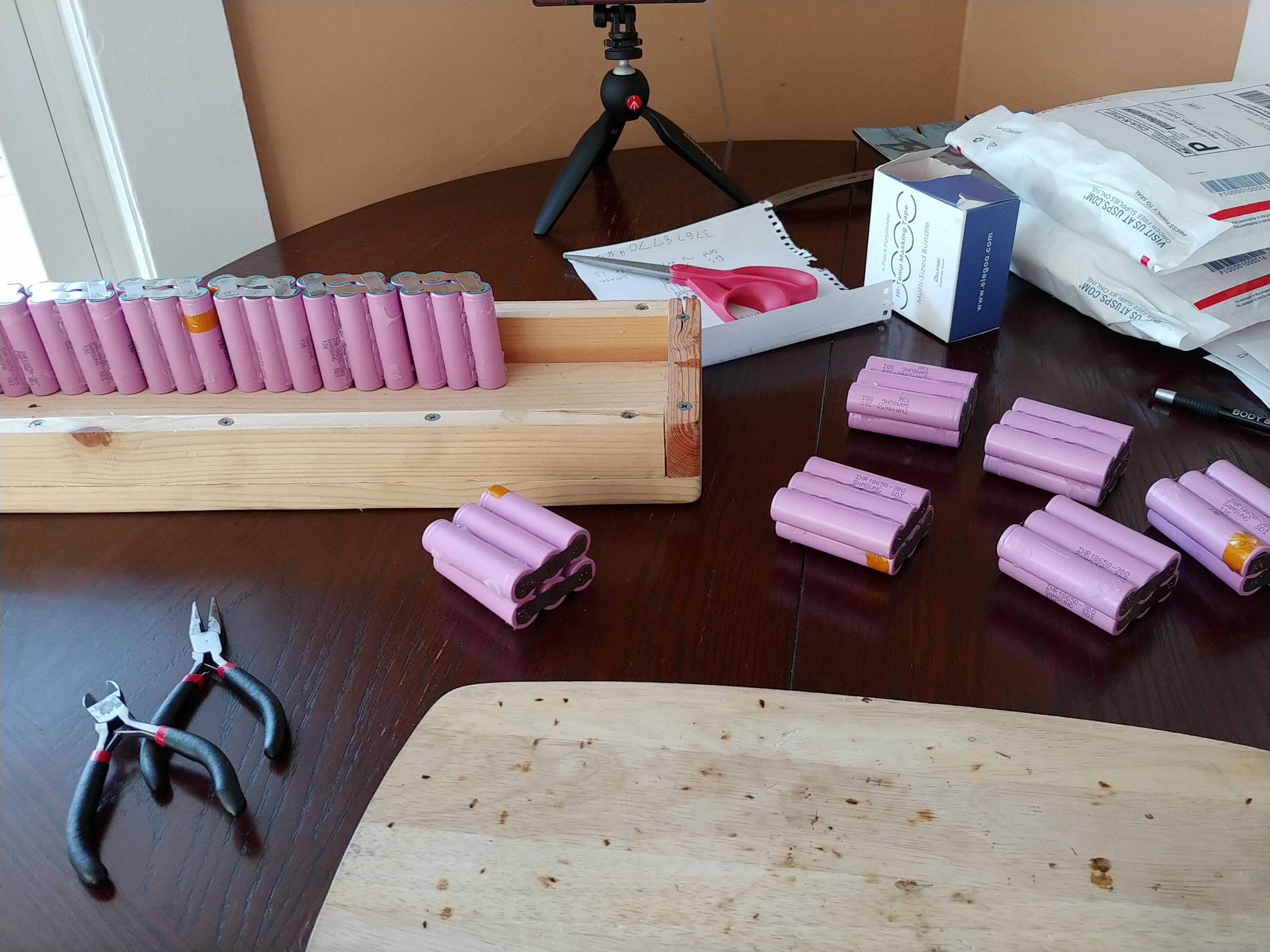

I’ll add my 2 cents here… Made a rookie move lol… I spaced out while glueing but made all my 6p offset packs the same instead having half mirrored… If you dont know what that means it means that when I flip every other pack during assembly they wont line up and lock in… =(
So had to tear down the packs and restructure…
Good news is all.my weld were nice n solid… Bad news… Time to break out the dermal for some clean up…

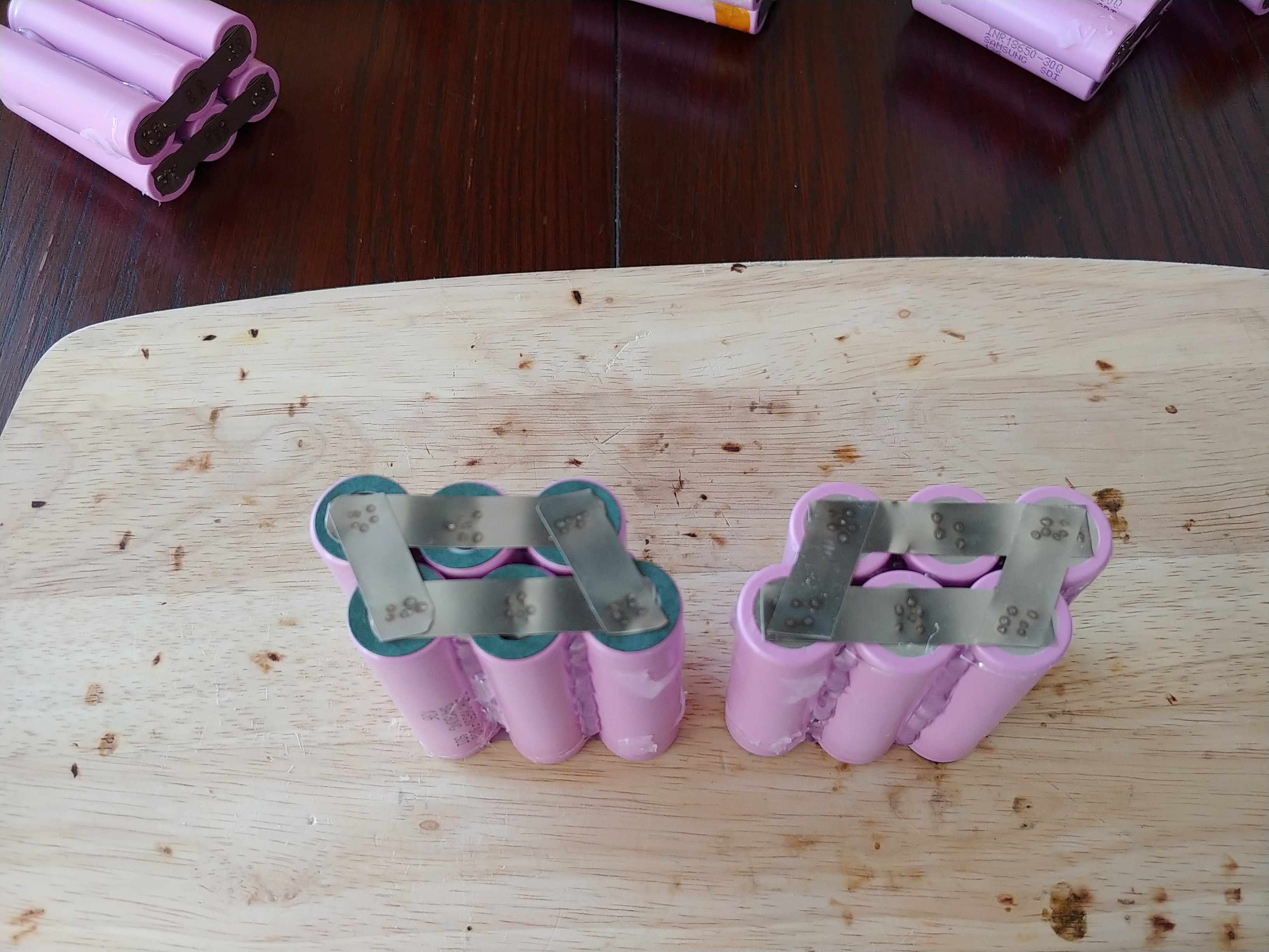

Are you sure those welds are strong enough?

yup…pictures were taken before i posted, and posted after i ripped em apart… wish I didnt have to do clean up but its also confirmation the welds were good

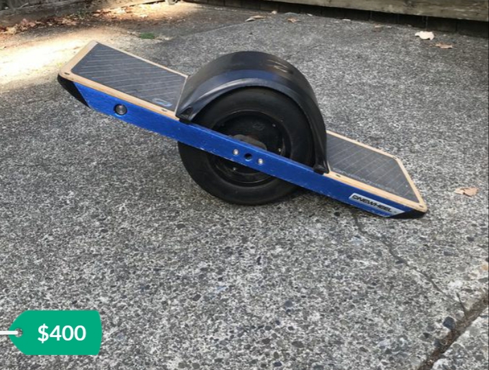

So that’s a V1 onewheel. I would look for a + model. The motor just isn’t as strong on the V1, higher top speed but not much tourque. For the most part people have abandoned it. For $400 though, I guess just slap one of the ego batteries on the fender and wire that direct to the controller and call it a day.
Stock battery is a 16 cell NMC battery at 59v fully charged. It can be swapped for a 14s li-ion battery. Or you can use both together if the stock battery isn’t entirely screwed. That way you still get accurate percentage readouts in the app and the on/off button still works normally.
Huh I actually kinda thought it was a plus. :upside_down_face:
I was also thinking about controller swapping it, but you say it’s the motor that is worse than the +/XR.
They are all rated 750W is it different KV or something?
I guess I won’t try to off-road it much.
And yes battery on top of the fender is the plan.
I could make a battery that fits the concave.
Different KV and stator design. The + and XR share the ā€œhypercoreā€ motor which is custom. While the OG V1 used a modified off the shelf motor.
You can tell it’s a + by the footpads, the + and XR will share the newer style.
Controller swap won’t work either, and at that point you might as well just buy a whole XR (which happens to use 18650’s like every other board… finally)
I would avoid fender batteries, changes weight distribution and really messes up how it rides. If you want to just swap the battery, look into the two-x system. I’ve been using it for 1000+mi with no issues and it gives me the range I want. It works on the V1 as well.
