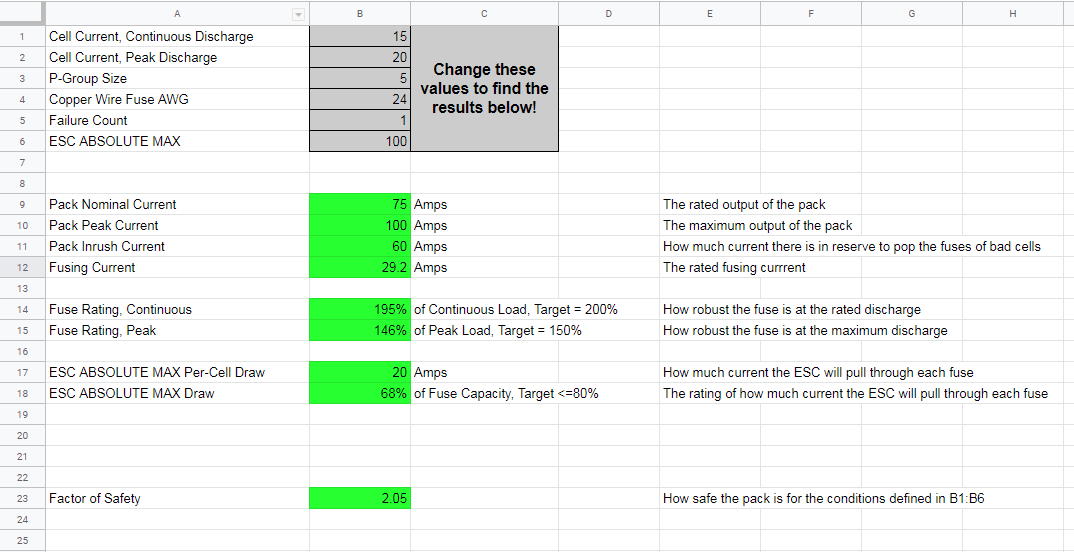

Nice! What size for fusing a 30q?

There is no on-size-fits-all answer for determining cell-level fuses.
This calculator is a good starting place.
Let me walk you through the sheet
This is my 12S5P setup, running 30Q’s
Define your pack in B1:B6
  • The rated discharge for 30Q is 15A (B1)
  • The peak discharge for 30Q is accepted to be 20A (B2)
  • My P-groups are 5 cells (B3)
  • The copper wire I’m using for fusing is 24AWG (B4)
  • I’m willing to allow a single cell to fail in this scenario (B5)
  • I’m going to allow the ESC’c to pull a combined 100A from this pack (B6)
Cells B9 through B12 describe the characteristics of the pack defined in B1:B6. This should be self-explanatory.
Cell B14 is the ability of the fuse to handle normal discharge currents. In this example the fusing current of the 24AWG wire is 29.2A. This 1.95 times more current than the typical 15A discharge of the cells.
Cell B15 is the ability of the fuse to handle peak discharge current. In this example the fusing current of the 24AWG wire is 29.2A. This 1.46 times more current than the peak 20A discharge of the cells.
Cell B17 is the maximum current the ESC will pull though each fuse.
Cell B18 is the rating of the maximum current drawn vs the fusing current. In this example the ESC is pulling 20A through each fuse, which is 68% of the fuses’ capacity (29.2A)
Cell B23 is the factor of safety. The higher the number the better. The definition here is Pack Inrush Current (B11)/Fusing Current (B12). Basically, how much current is in reserve to operate the fuse(s) of the bad cell(s) as a fraction of the fusing current of the fuses. In this example, I have 60A of Pack Inrush Current (15A*4), so 60A/29.2A = 2.05. Translation = I have twice the amount of current I need to operate the defined fuses in B5.
Hopefully this helps!
