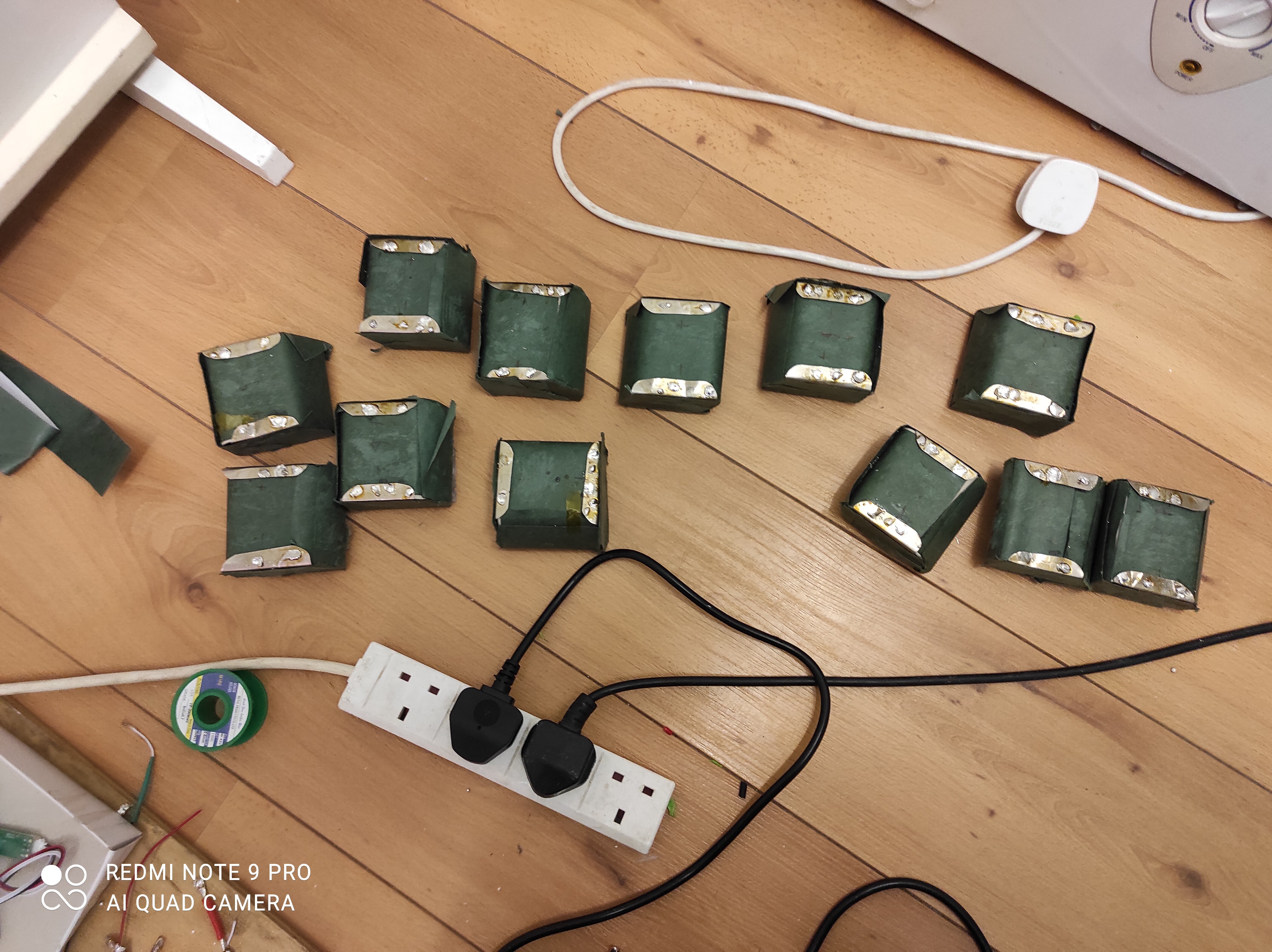

Lemme see the other side of that. Looks clean
it was very nice for a first try!!! no practice
in the front there was my special SMART BMS holder over the termails, saved about 12.5mm length and that would have made or broke then dual TB6 fitting.
not sure if I should cut to allow flex or not, it is in a Eboosed enclosure on a sendered deck so there is 0 flex there
do top mount batteries need any flex? or can all series connections be nickel?

Took apart my pack to the point that I’m just at p groups

gonna remove the positve one and use the neg for balance leads along the side
this is for a top mount pack also fishpaper will be redone as there are some holes in some place
I would just wrap them in kapton fishpaper is ass to peel off
cheers will do

anyone know nickel sources in the uk? fogstar dont have the right size as i want 30mm wide or 15mm wide at 0.2 and they dont have either of those
they have 20mm i think. can you just cut that down to size?
just checked they have 25mm could always cut that down. its all the same price anyway so not like its costing any more :man_shrugging:
yeah i know just cant be bothered cutting 25mm is just to small to cover 2 cells and 20mm is to big to cover one
if i have to i will
