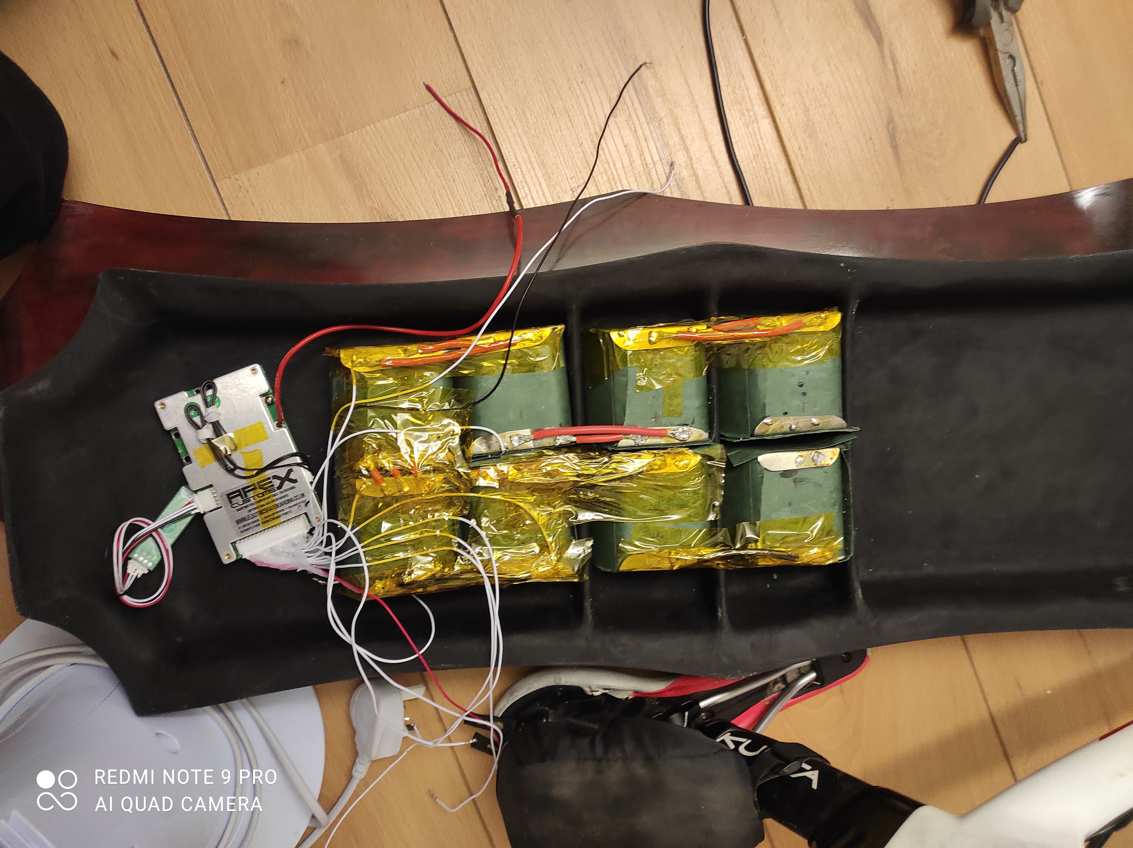

lets go half done desoldered and started resoldering then gotta put all the kapton and etc back on and also balance leads
will be a long night

disconnect the balance connector from the BMS, before you solder and desolder to the groups.

yay finished soldering and still measuring 42.7v
surprisingly the pack was actually really not that hard to do
now gotta work out where 10 balance leads go and protect the whole thing
woohoo fun day ahead

Because it measures voltage across each p group.
For it to do that it needs to connect to the ends of each group. To measure across that group.
Those connections need to be in order so it is only trying to measure across one group each time.
You can easily check this with your meter after it’s wired up by measuring between each pin on the plug (before plugging it into bms)

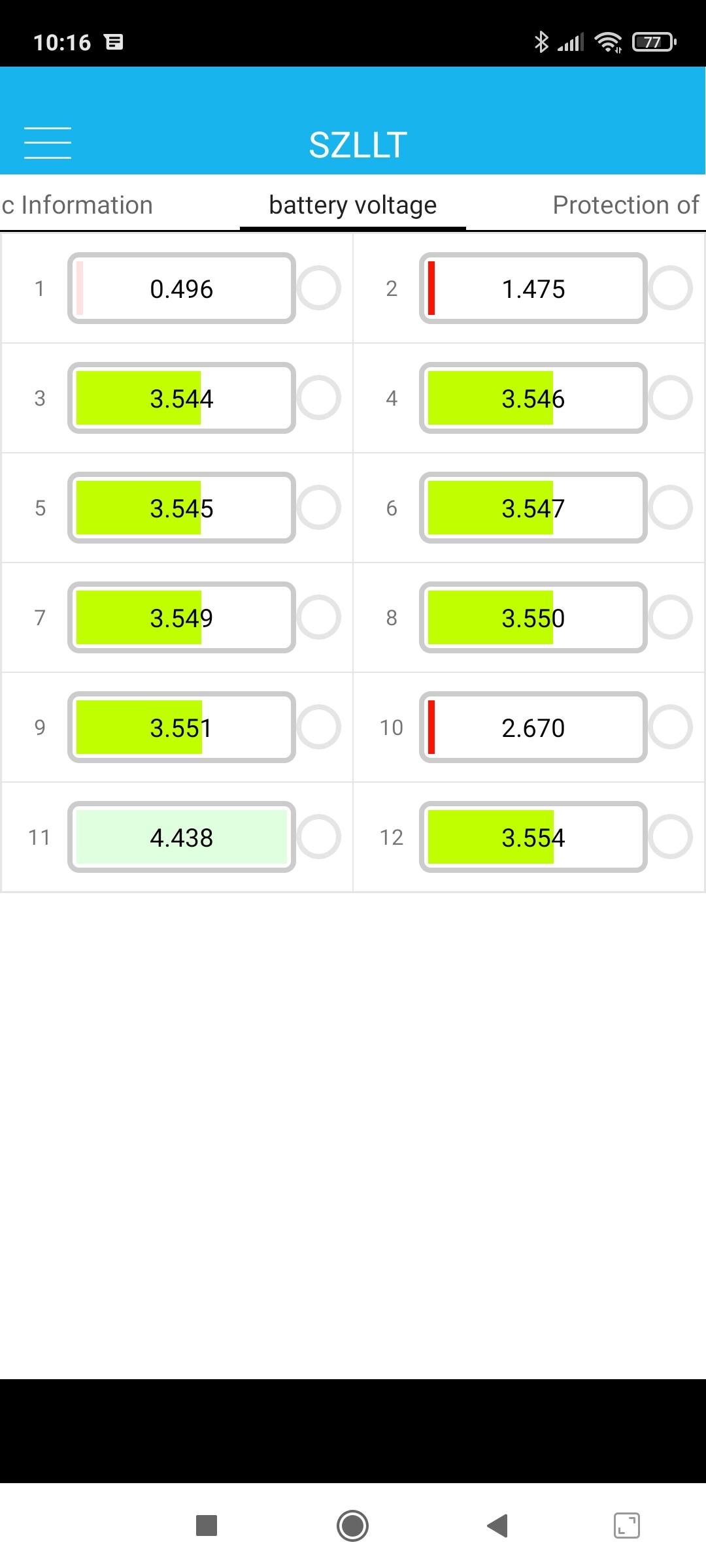

so i finished re assembling my pack and it fits enclosure fine
measured 42.6v which seems fine but then i opened the bms app and got this
what could cause it? and is this pack screwed?
