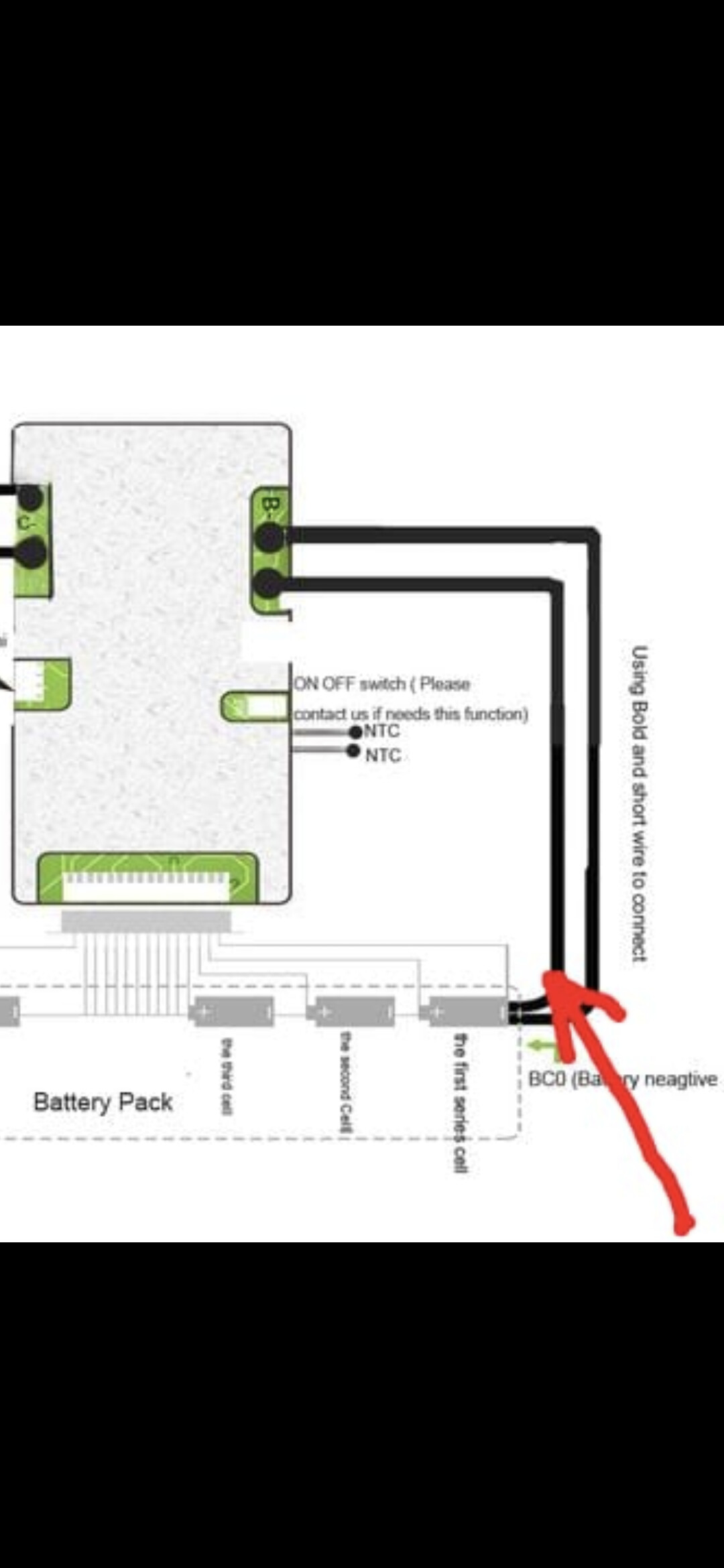

Are you sure you wired it correctly? Does it show the same voltages when you measure it with your multi meter?
so im trying to get to them now
would one be main negative?
I think you mean b-? Show us a pic of how you wired it
Did you connect the main battery - to the BMS? (Not the balance leads one, but the b- )
no i have connected c- yet do i have to?
thought it should read normal values for the moment still?
Dont need to have the c- connected for reading the correct cell voltages
Do this to check it

Did you do this connection?
Should jump up 3.5v every step
ah no sorry havent wired b- yet
will do so now and come back
also will measure on the bms thank you
Also take a picture and post it here so we can see what’s your problem (:
Yeah this needs to be connected because the BMS gets confused somehow if it isn’t

ah cheers @sebas used your thing and found the dead group
one of the bms leads was torn slightly and i hadnt noticed. gonna reattach and then put together thanks a lot

nope the p group was fine just the lead was a bit dead
all good now thanks a lot
