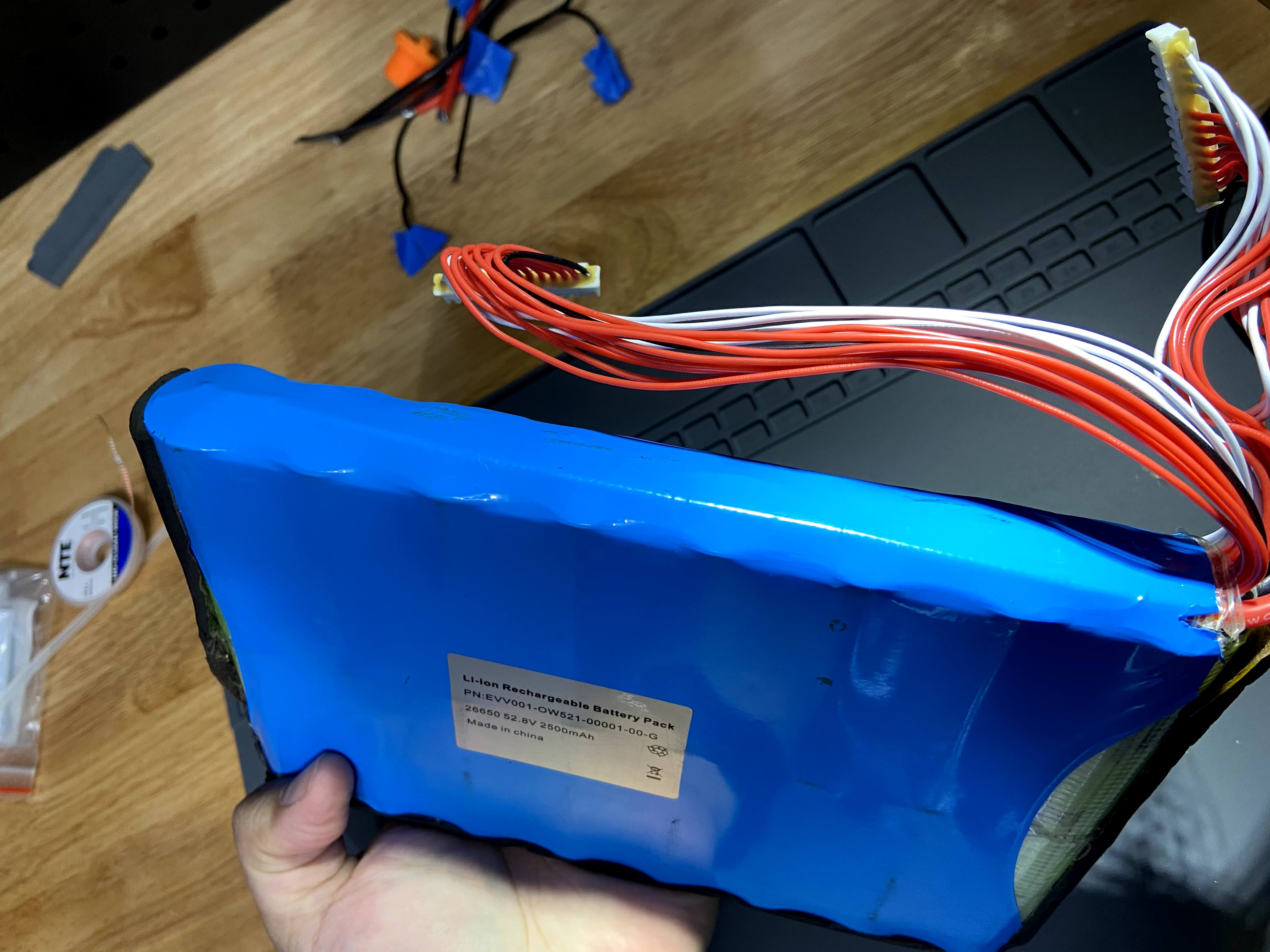

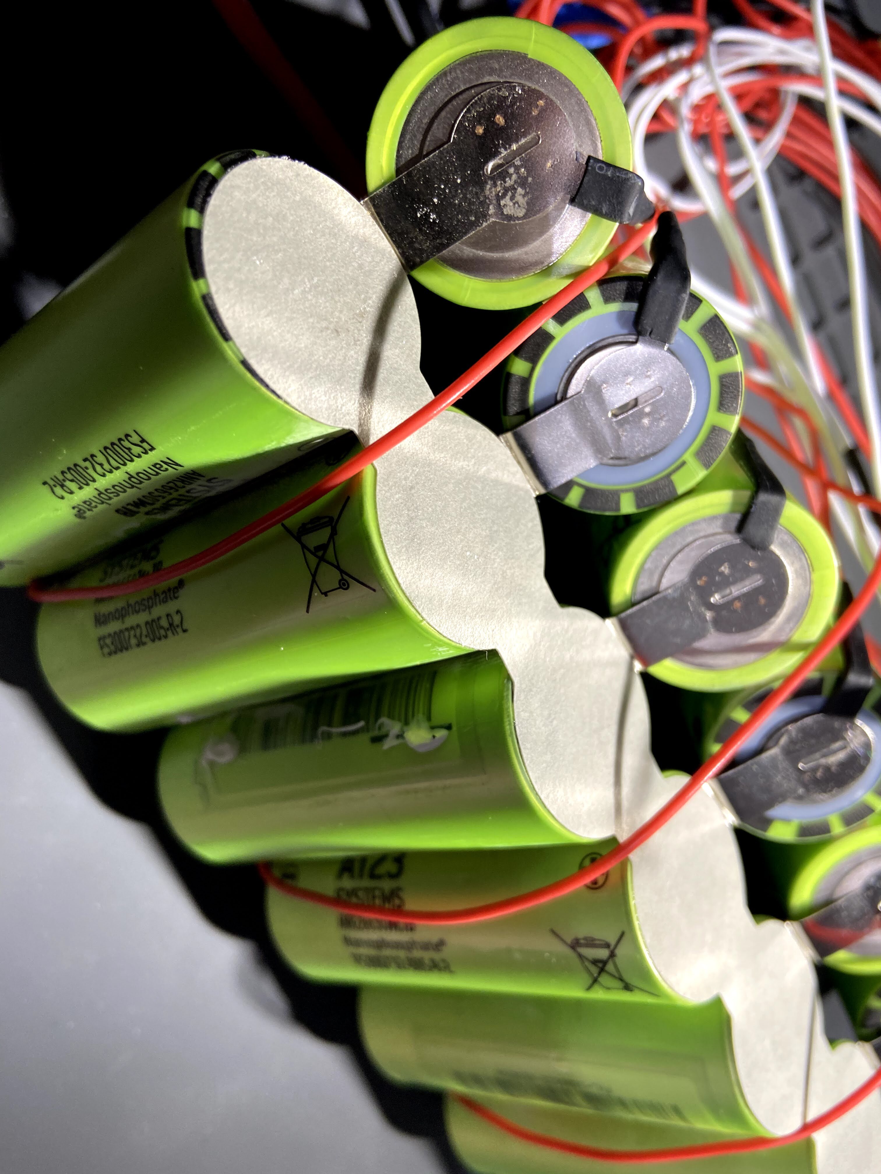

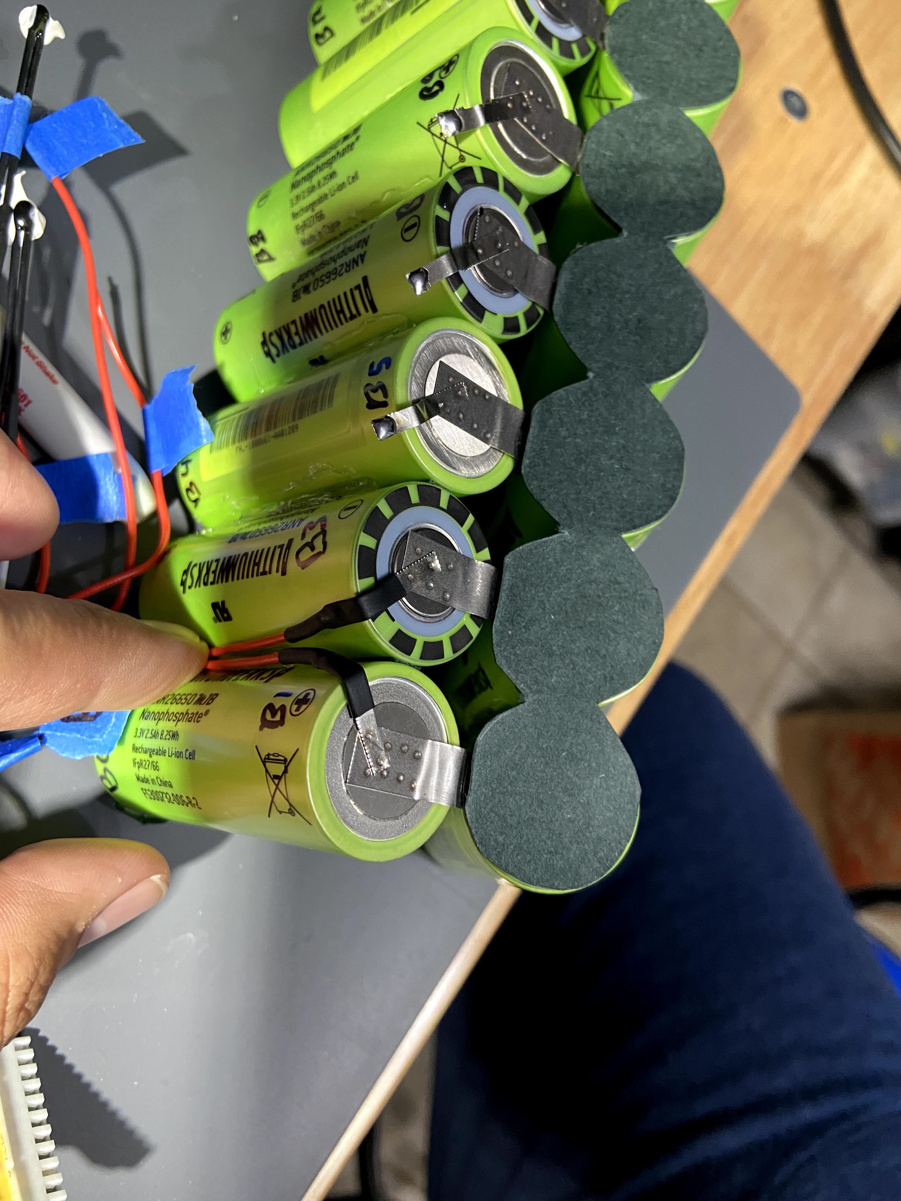

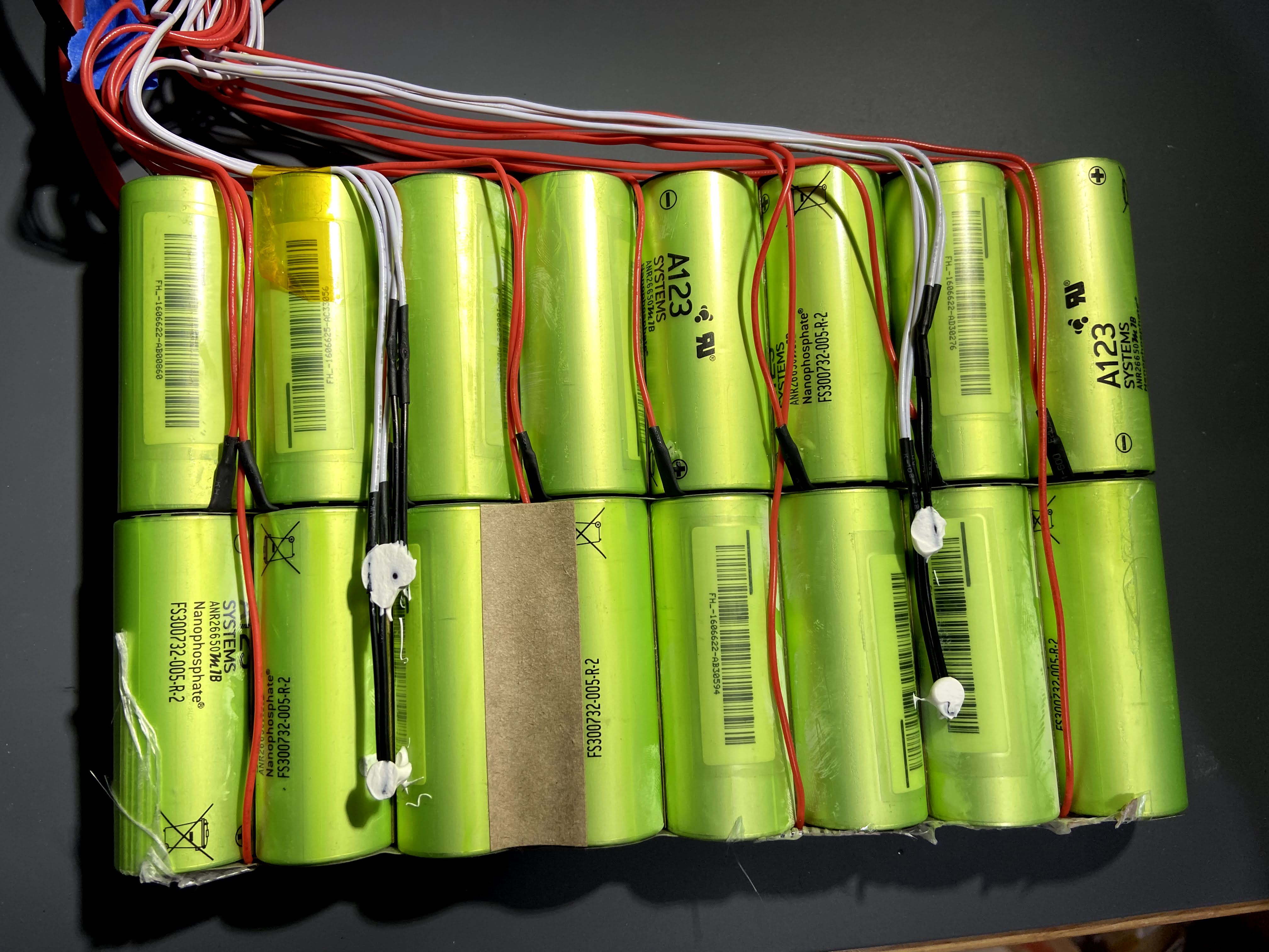

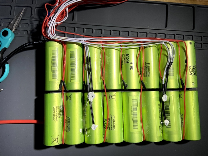

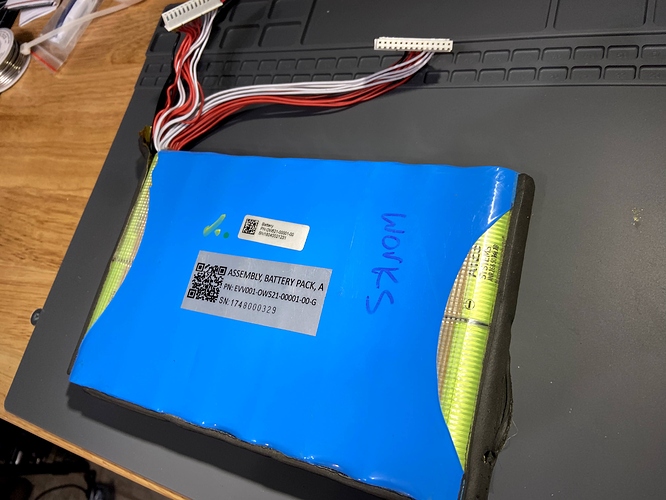

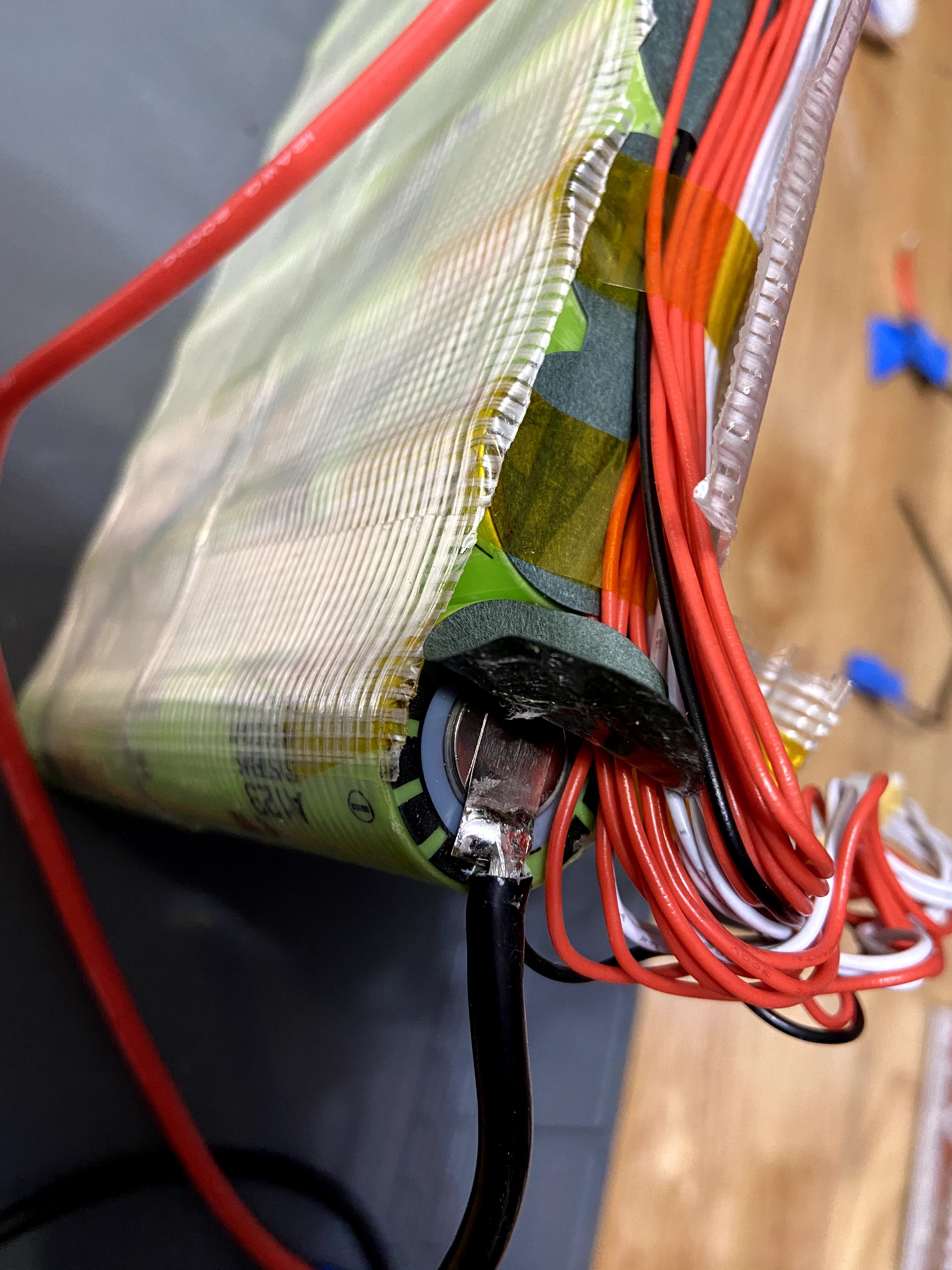

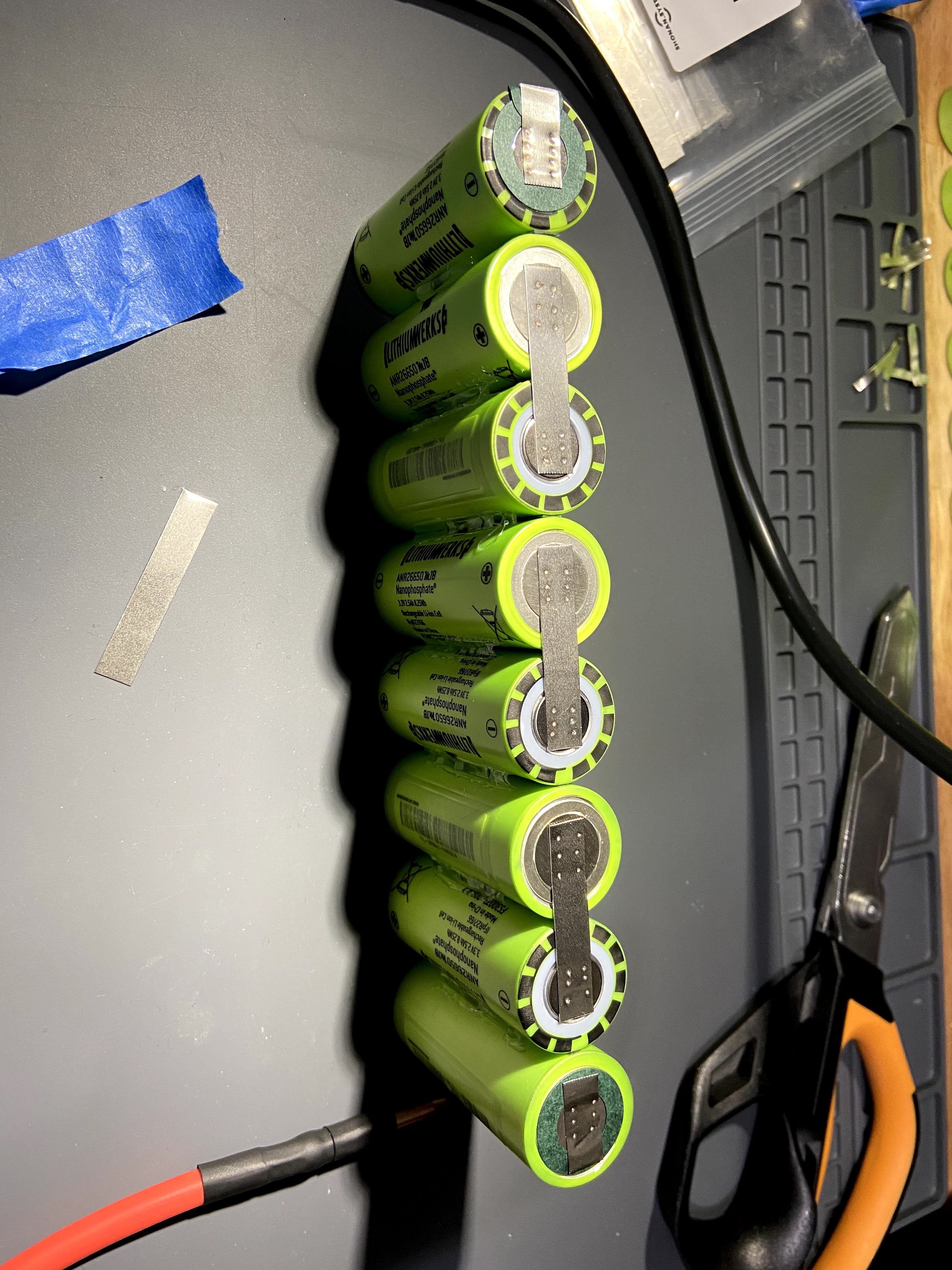

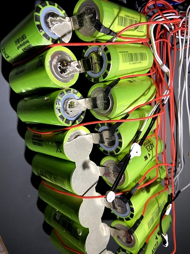

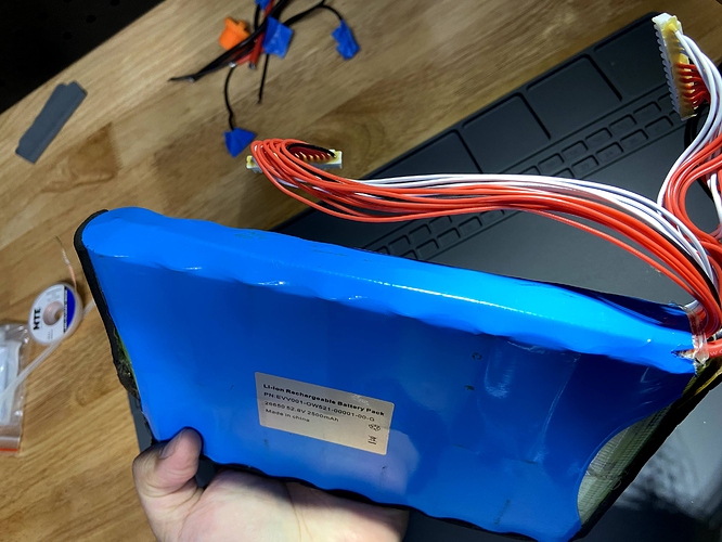

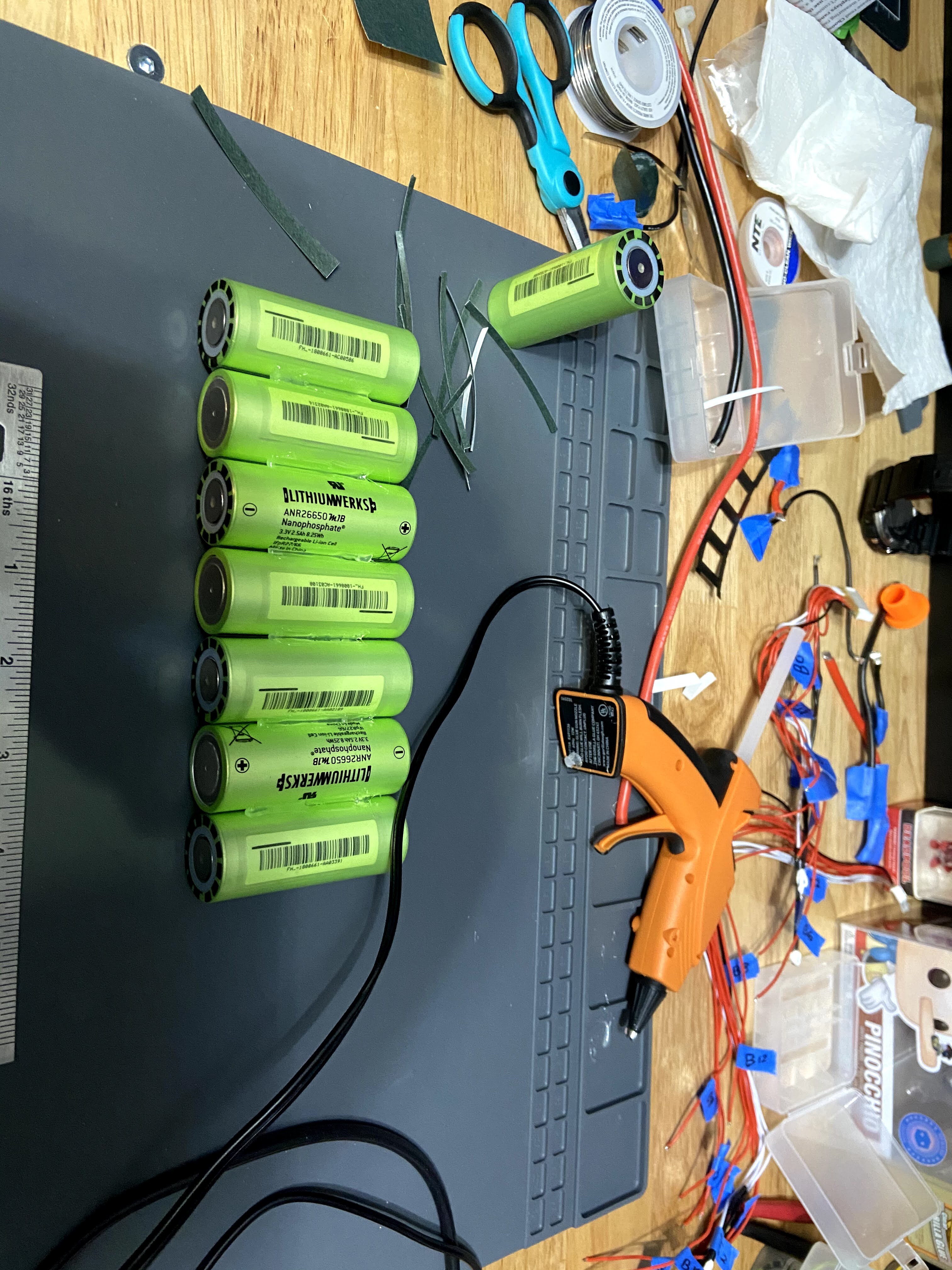

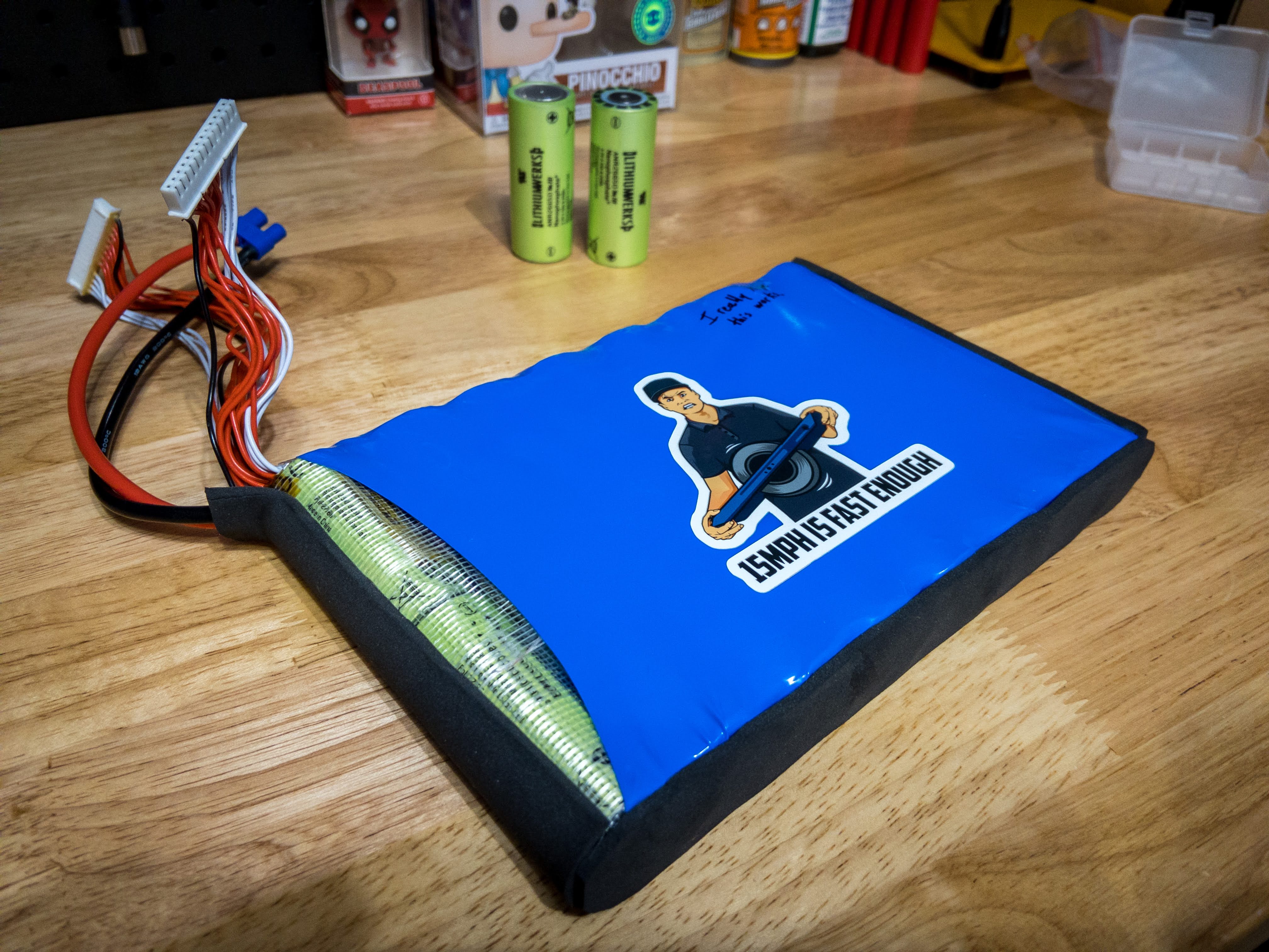

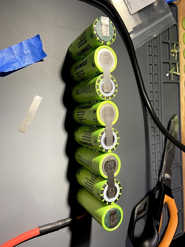

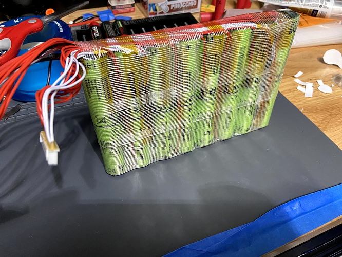

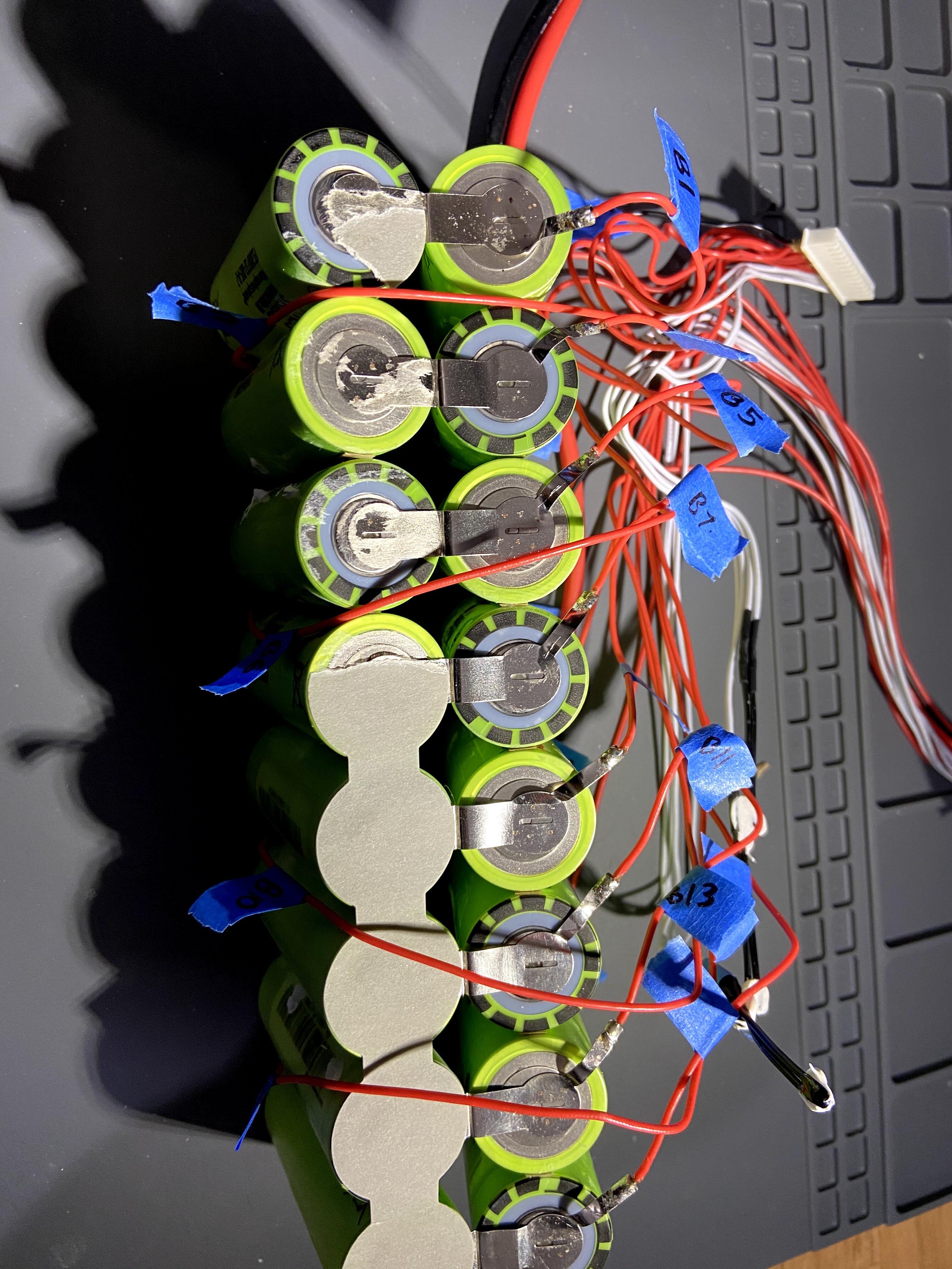

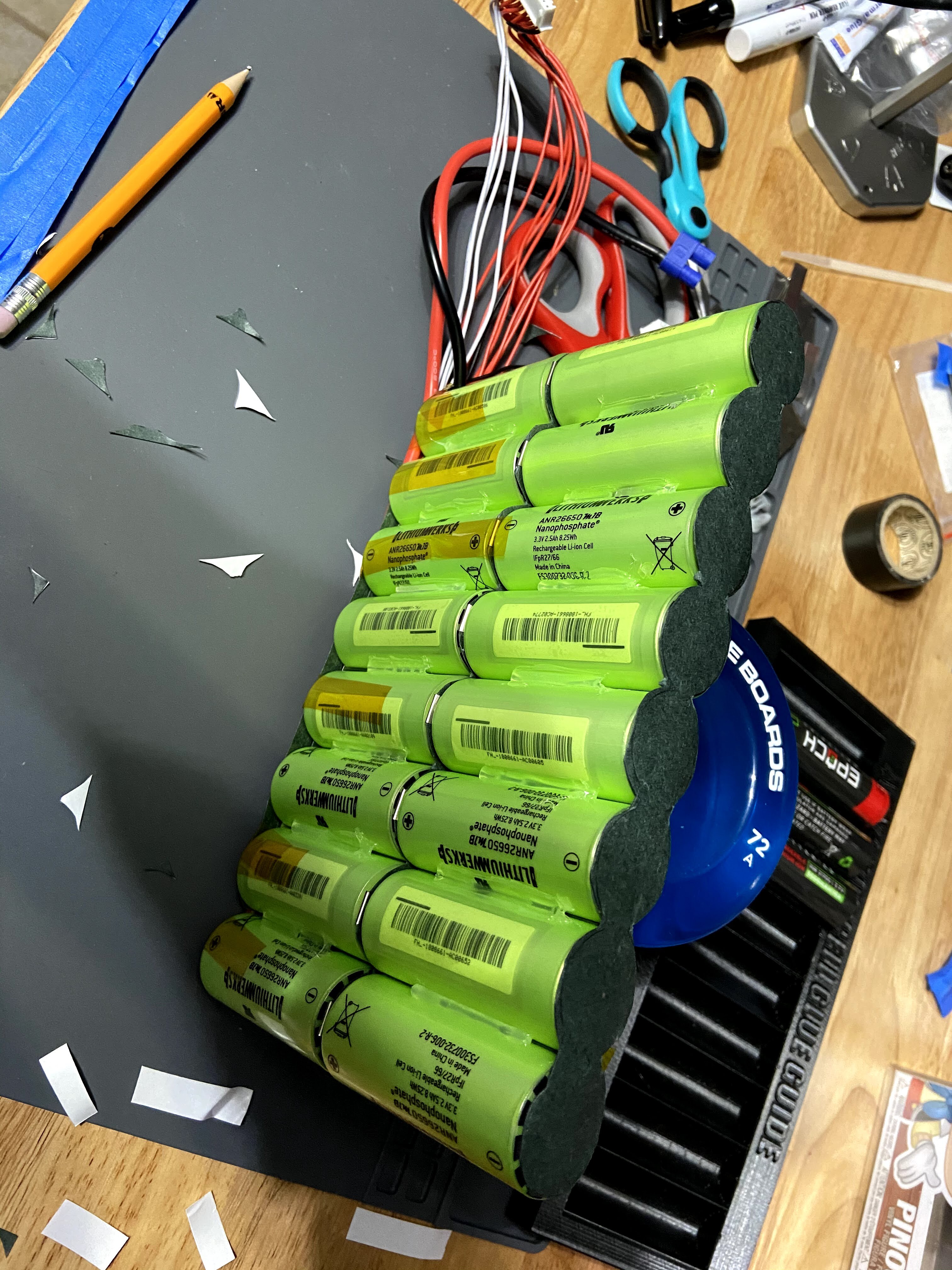

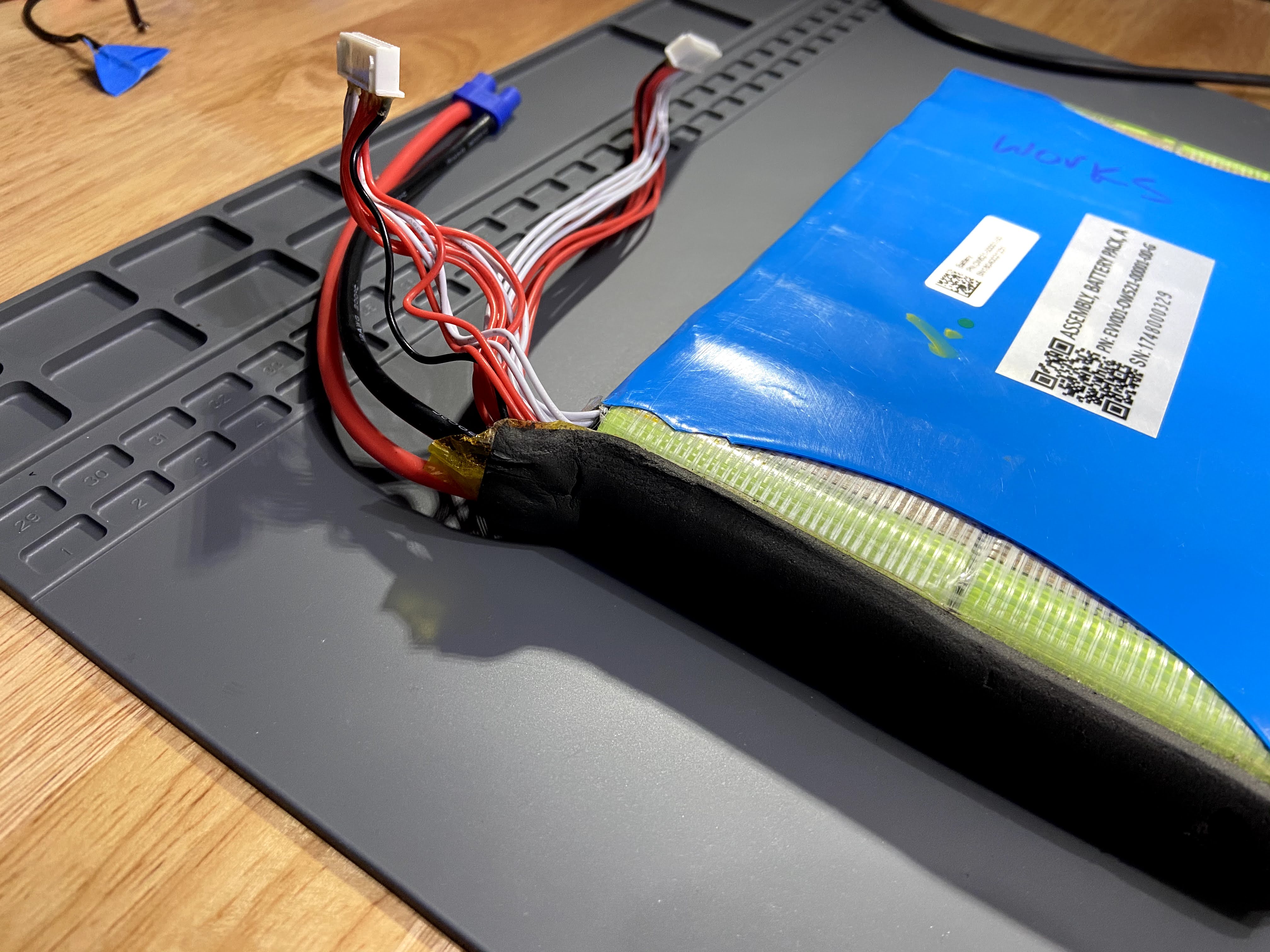

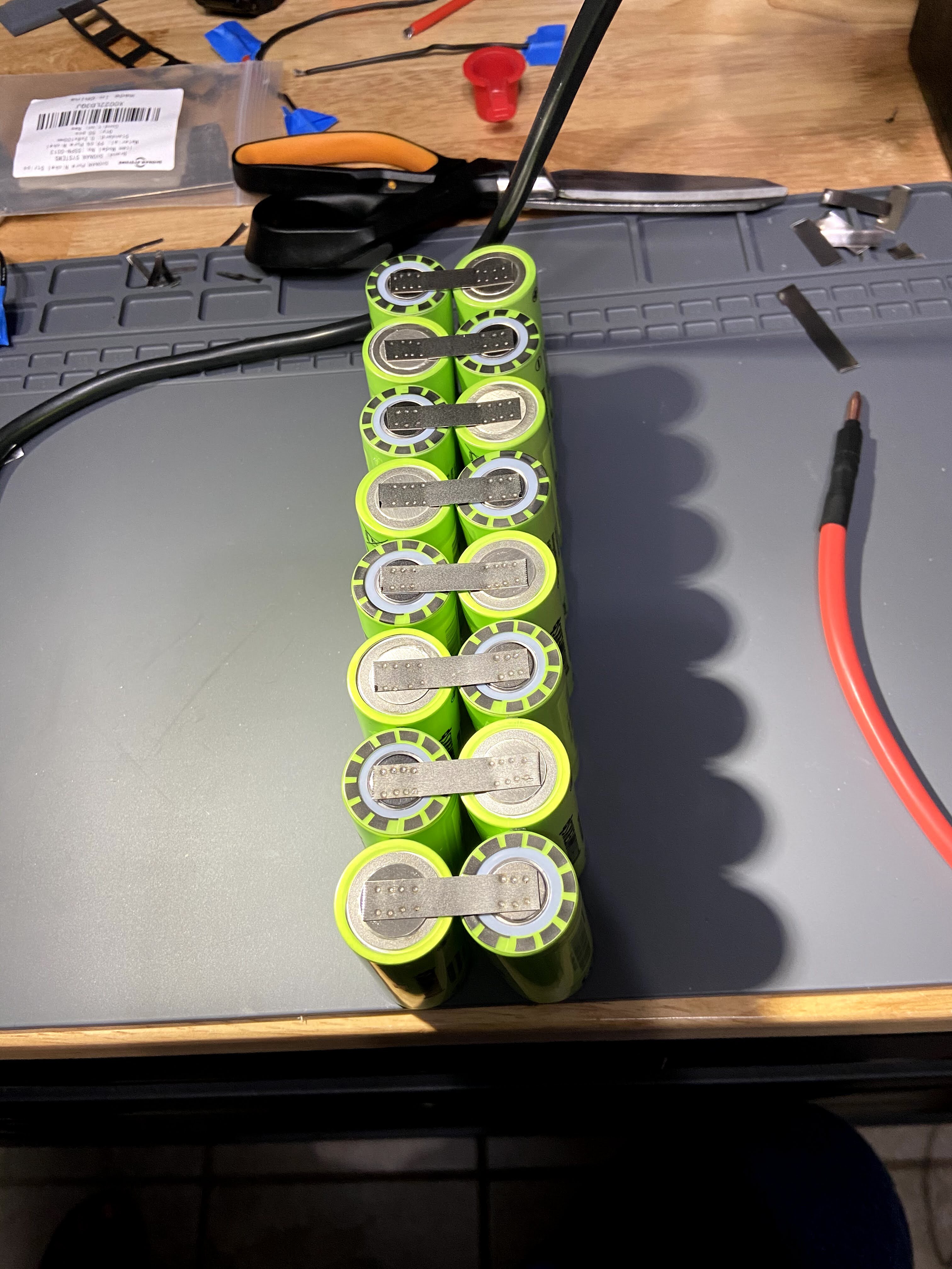

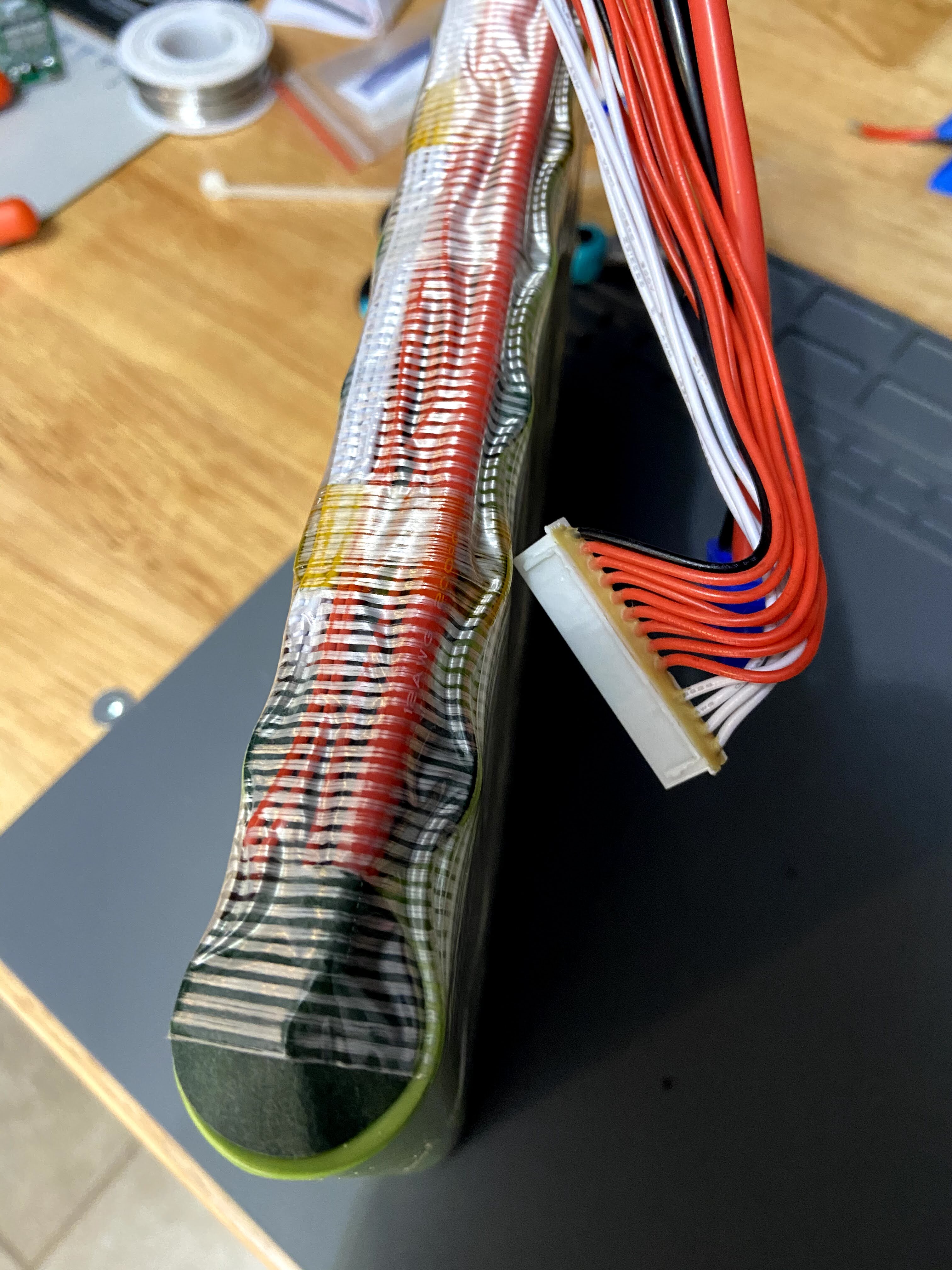

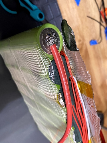

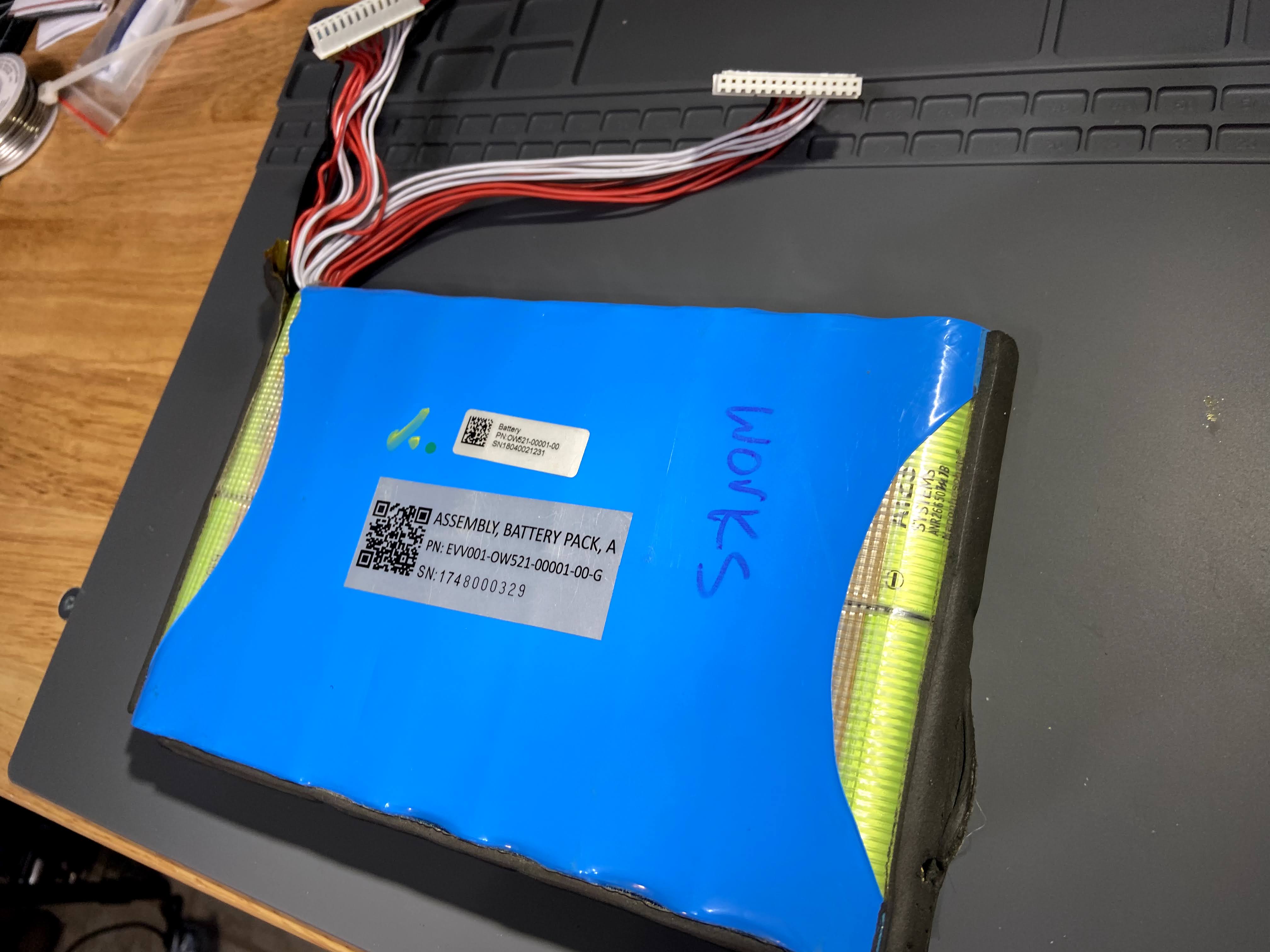

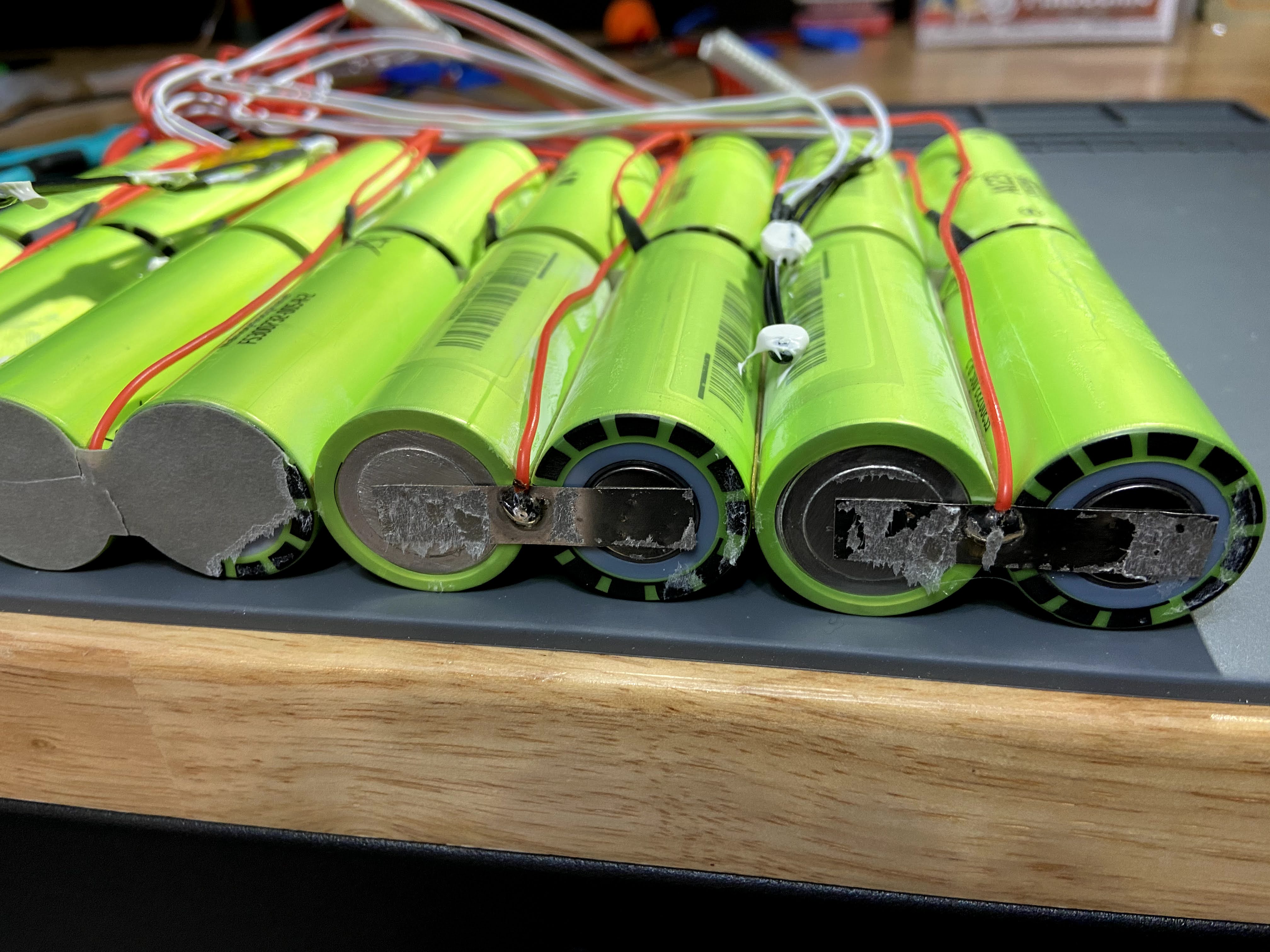

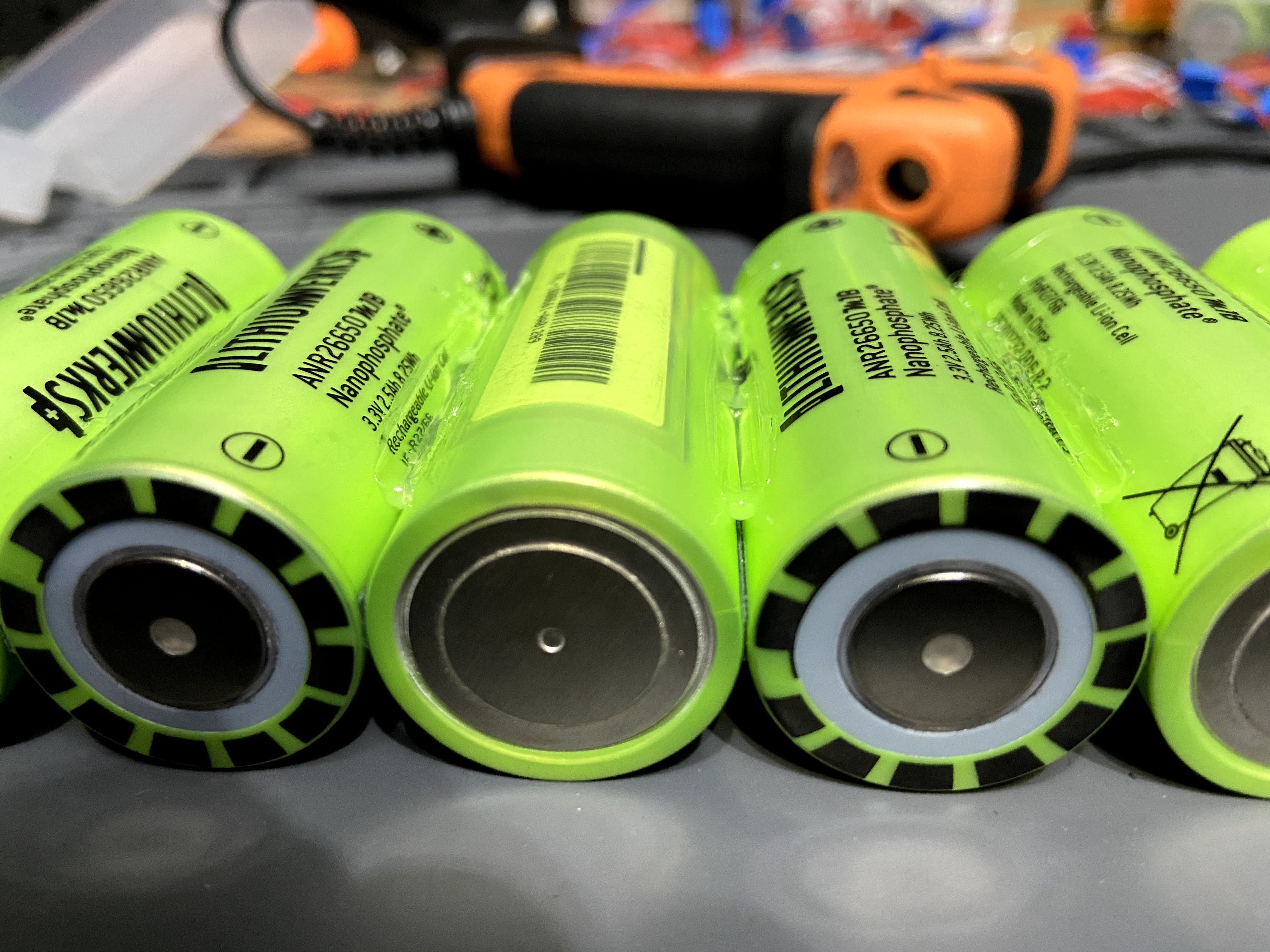

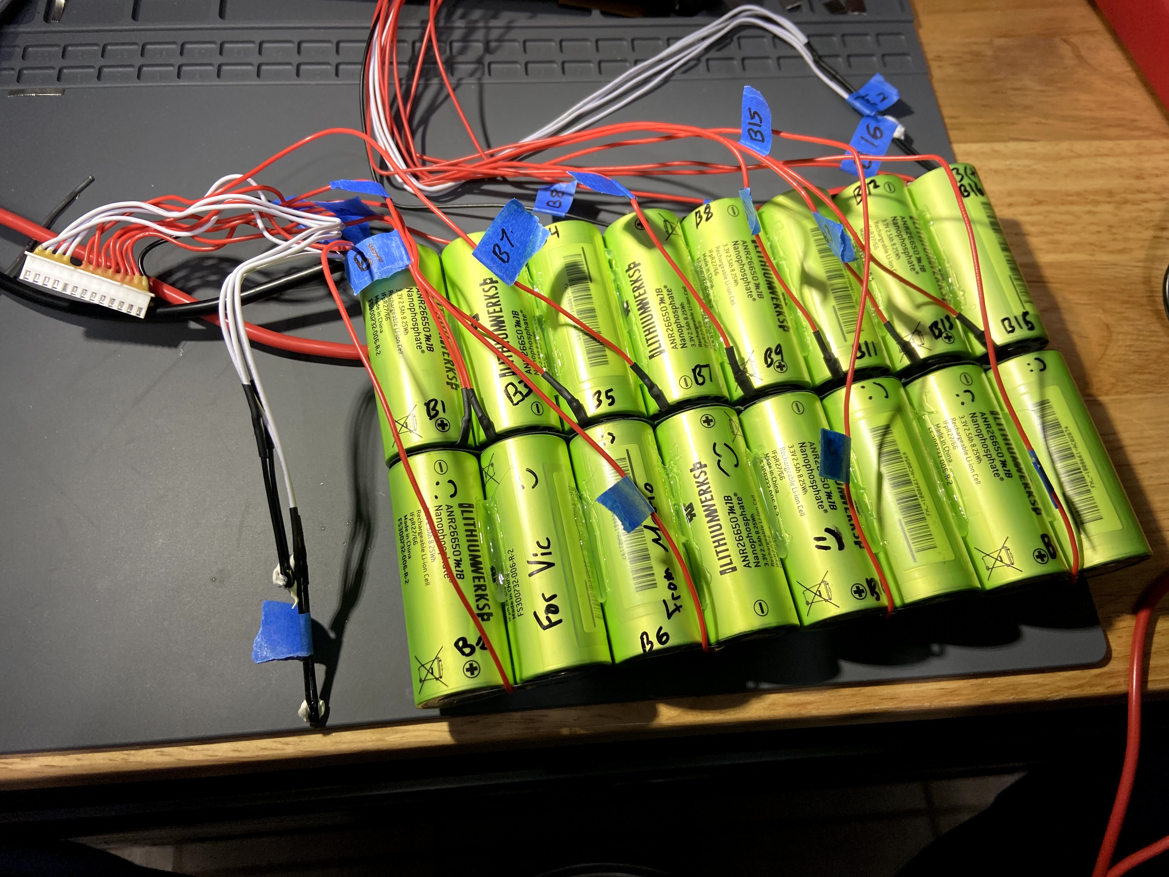

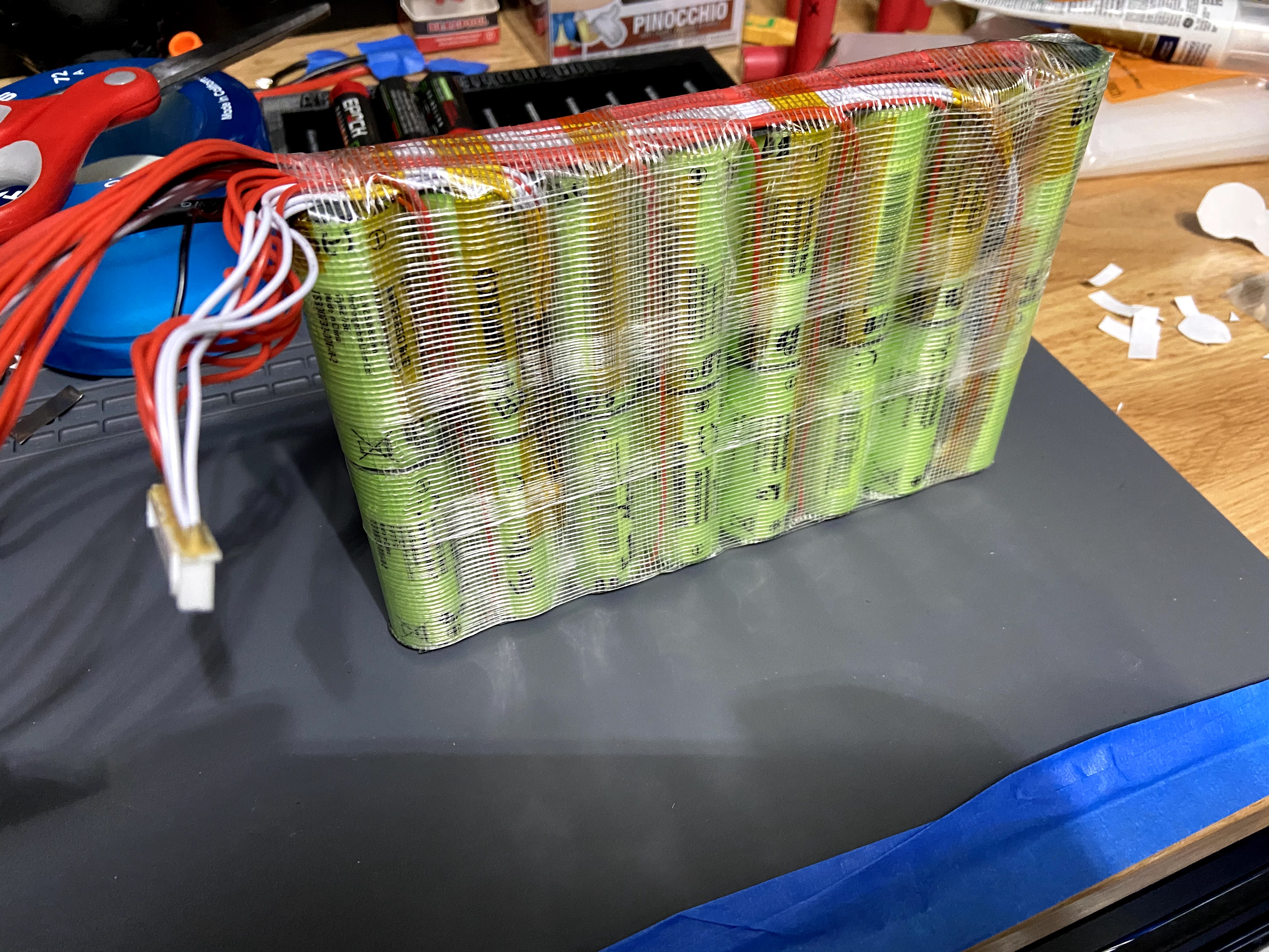

I figured I’d post this since it’s a good look into what went into the original Onewheel batteries. This is a rebuild I did for a friend’s Onewheel+ battery. The battery is the same as the original V1 Onewheel. It used a 16s1p pack with A123 LiFePo4 26650 cells. Since they were bought up and renamed, the new build has the same cells, just branded LithiumWerks. Taking it apart, I was a bit surprised at how simple the build was. Not that much going on in terms of insulation, and the nickel strip connections felt like 0.1mm. Maybe 0.15, but I’m not sure. It was pretty flimsy. Also…the soldering on the main leads to the nickel strip was a bit sloppy. But oh well! It worked for years!

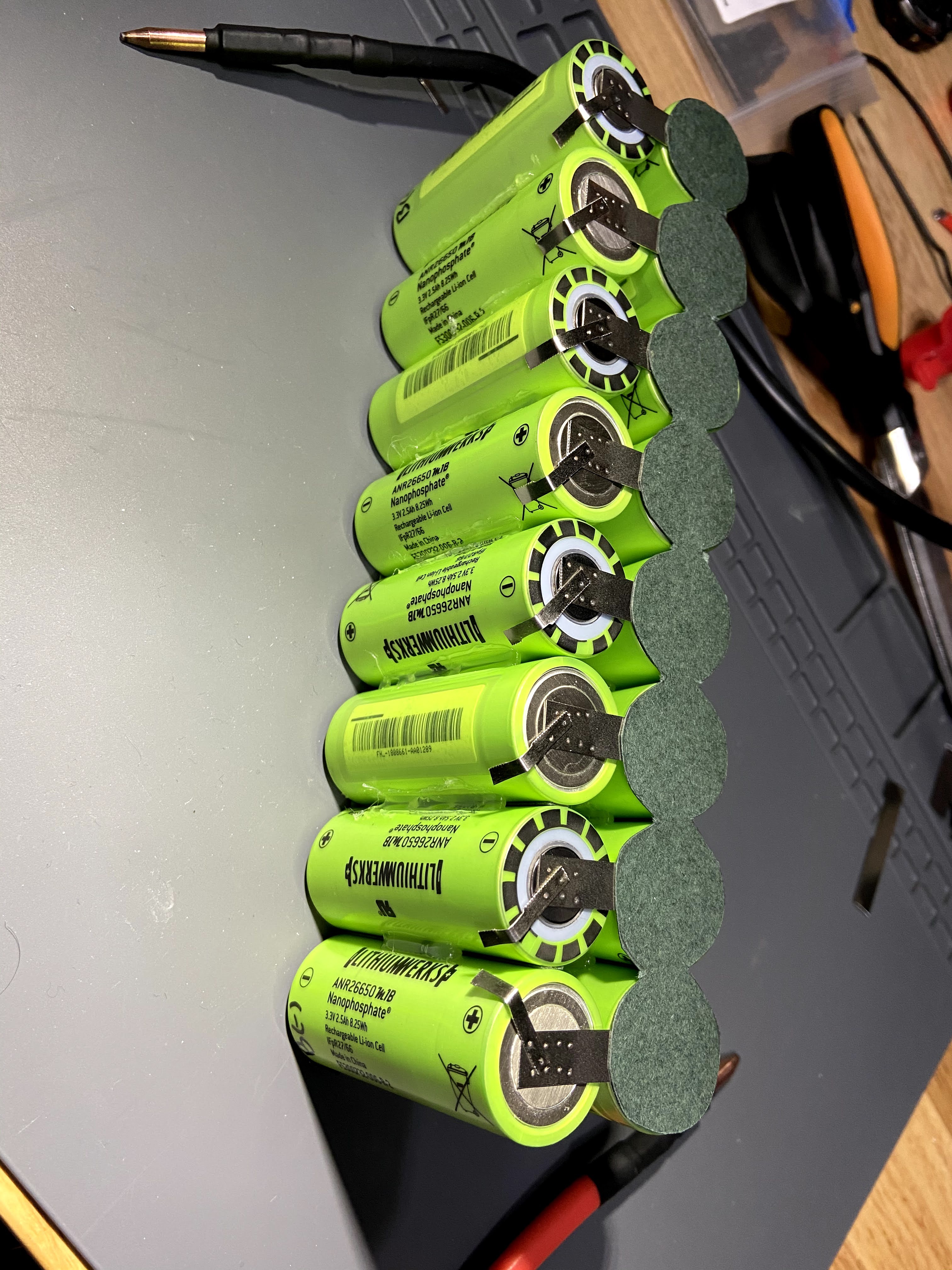

Now to make it fresh. The pictures are in reverse order. Since I didn’t have fish paper with adhesive on both sides, I used the single adhesive and just glued the cells in place. Used 0.2mmx8mm nickel, and just swapped over the wiring harness.
My custom sticker of Big Daddy Kyle adds an extra 10 miles of range.

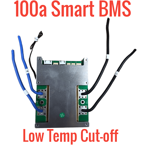

Anyone got a 14s smart bms for sale in the US ?
hit up @kevingraehl the 16s Daly can be solder-bridged to support 14s…
I’ve “heard” he’s only stocking 16s lately as they are configurable…
EDIT:
oh you said smart… no clue, I don’t use that shit… i don’t want my esk8 smarter than me
