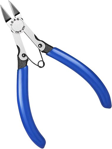

Iâm finally getting around to planning a battery pack build using reclaimed A123 batteries from BatteryHookup. These batteries are still welded to the thin nickel plating that they came with. I would like to create a 12s1p pack from these batteries.
There are two approaches that I have read about here but am not sure which one is best for me.
- Spot weld on top of existing strips (cut down strips first, but leave welded nickel)
- Remove existing strips from battery cells (use pliers, grinder)
- Solder braided copper to existing strips
I do have a spot welder (not a great one), and I suspect option 1 is probably the route I will take. I would like to expore route 3 but I canât find a lot of reliable information about it to determine it is a viable option. Thoughts?
Nope, bad, do not do. The kind of heat it takes to get a good solder joint (especially with braid) seriously damages the cells, and in some cases can deteriorate the safety mechanisms built into the cell, causing a catastrophic failure. Spot welding is the safe way to make a pack. Buy a Malectrics and use your car battery to run it if you are on a budget, and a buy a kWeld if you are not.
This is super easy with these pliers:
Or any âflush cuttersâ as these are commonly referred to as. Simply slip one half of the jaws under the nickel, grip it gently, and roll the nickel off the top of the can like peeling up the lid of a soup can. Be careful that you dont use so much pressure that the pliers cut through the sheilding on the shoulder of the can, causing a shoulder short. Then use some sand paper and carefully smooth out the bits of nickel it leaves behind until you have a nice smooth surface for your new welds.
