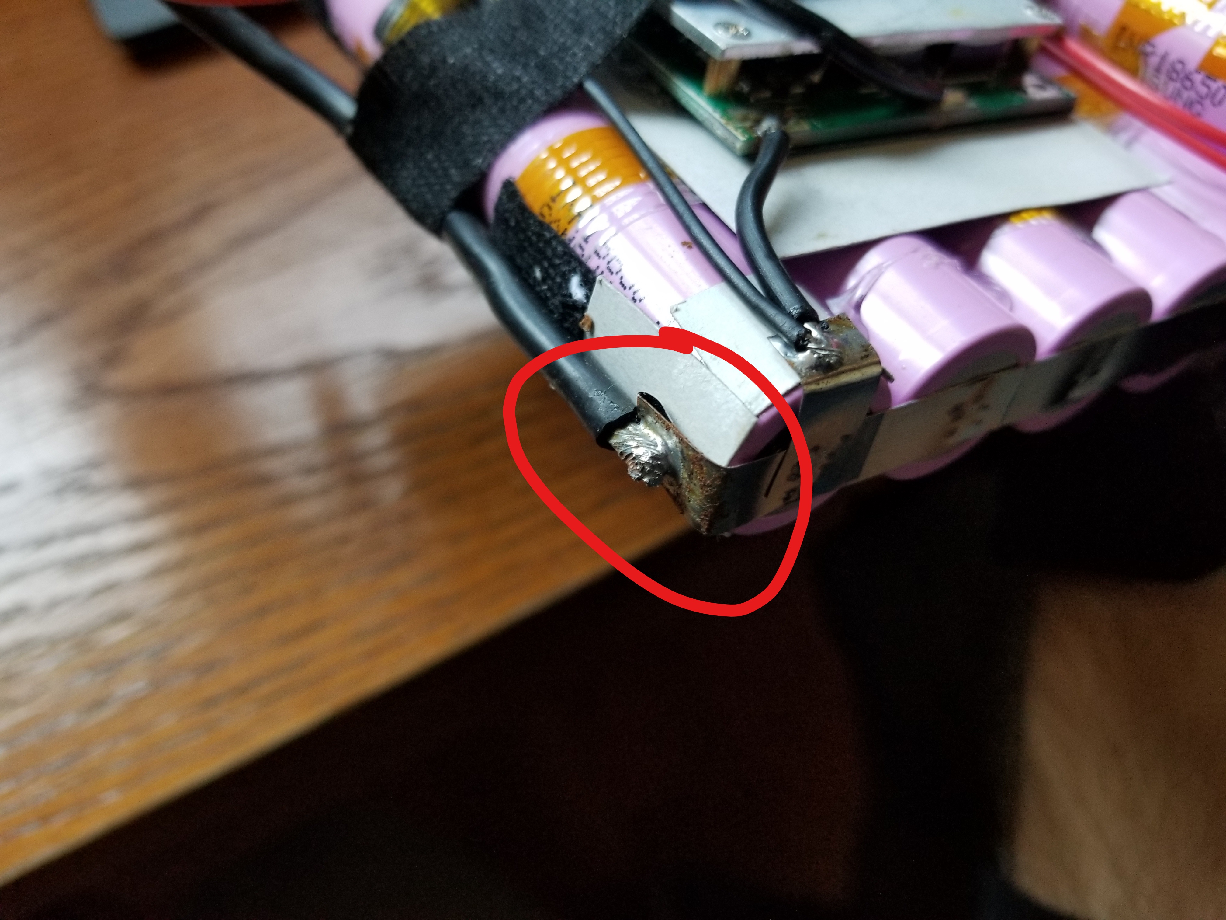

I recently bought a used (~10 cycles) 10s5p 30Q battery pack (before I learned about the quality control issues on the more recent packs from the builder :eyes:)

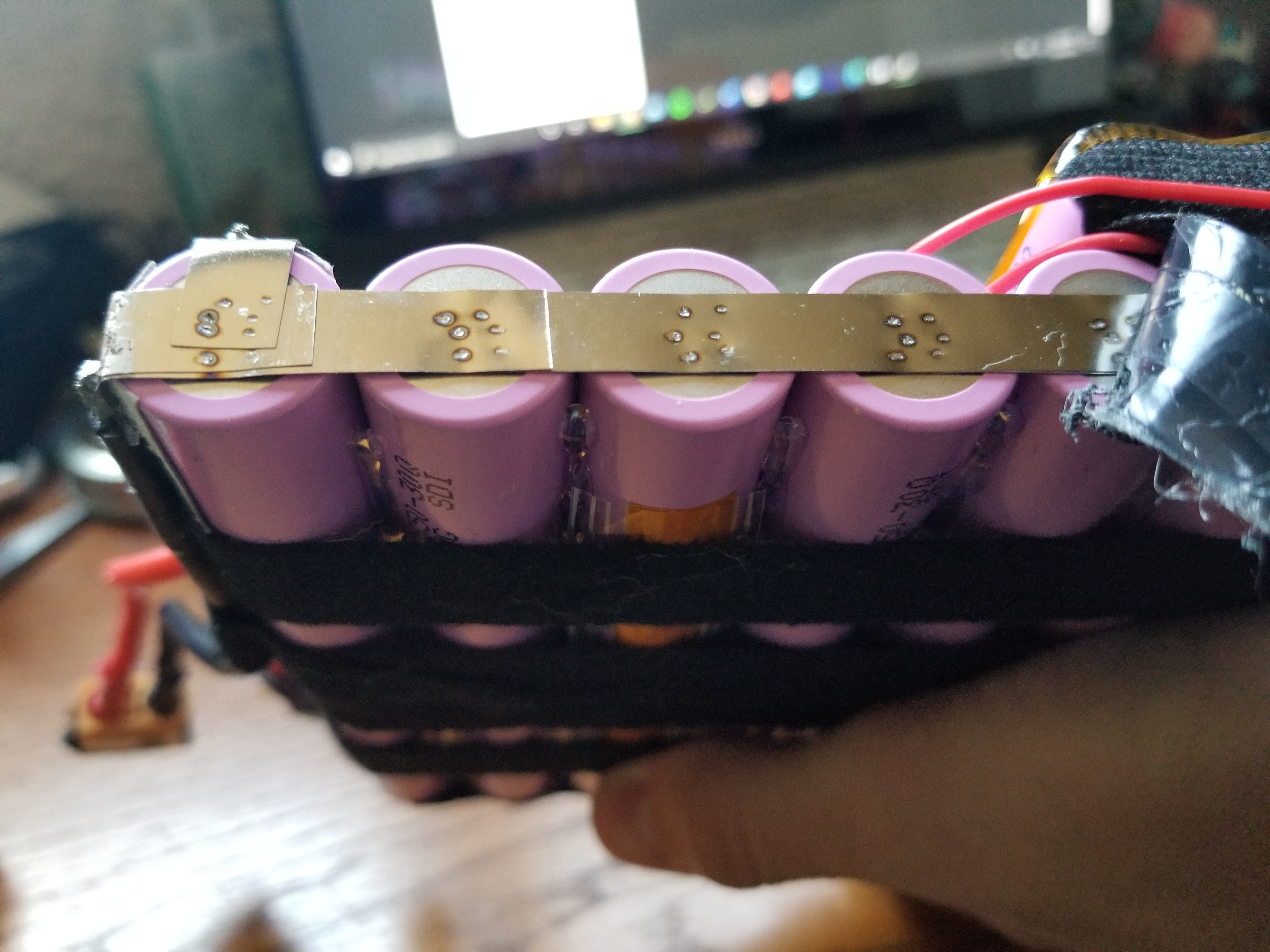

The pack seems to be built with double stacked 0.1mm x 8mm nickel for the p-groups and four strips of the same nickel for the series connections.
The battery lead connections are obviously not enough, just 1 strip of nickel. How would you guys recommend improving them? Do you guys see any other serious issues?
Weak solder joints, bottle necks from super low nickel mass and poor layout, no accommodation for flex, no parallel group insulation, messy balance leads, cold weldsā€¦dude thatā€™s sus at best

Honestly it would probably run okay, some sharp corners and touchy welds, itā€™s not the worst Iā€™ve ever seen but coming from a builder specifically it is a bit poor attention to details
Is that a single stack 0.1x 8mm pack negative? Youā€™d want to check out the conductor thread to see what you could safely pull through that. Hard to believe the pack negative is connected like that
I remeasured and the negative is actually double stacked 0.15x8mm. Should be acceptable at 35A continuous according the the chart on the conductor thread. I donā€™t plan on pulling more than 50A peak out of it, so Iā€™m hoping it will be fine. I will of course be keeping a close eye on it.
Hm yeah just be careful and pad the pack well in the enclosure. Iā€™d make sure to have foam on at least top and bottom to make sure it minimizes vibrations. Iā€™d also add some kapton or fiber tape over the negative lead to keep it in place better.

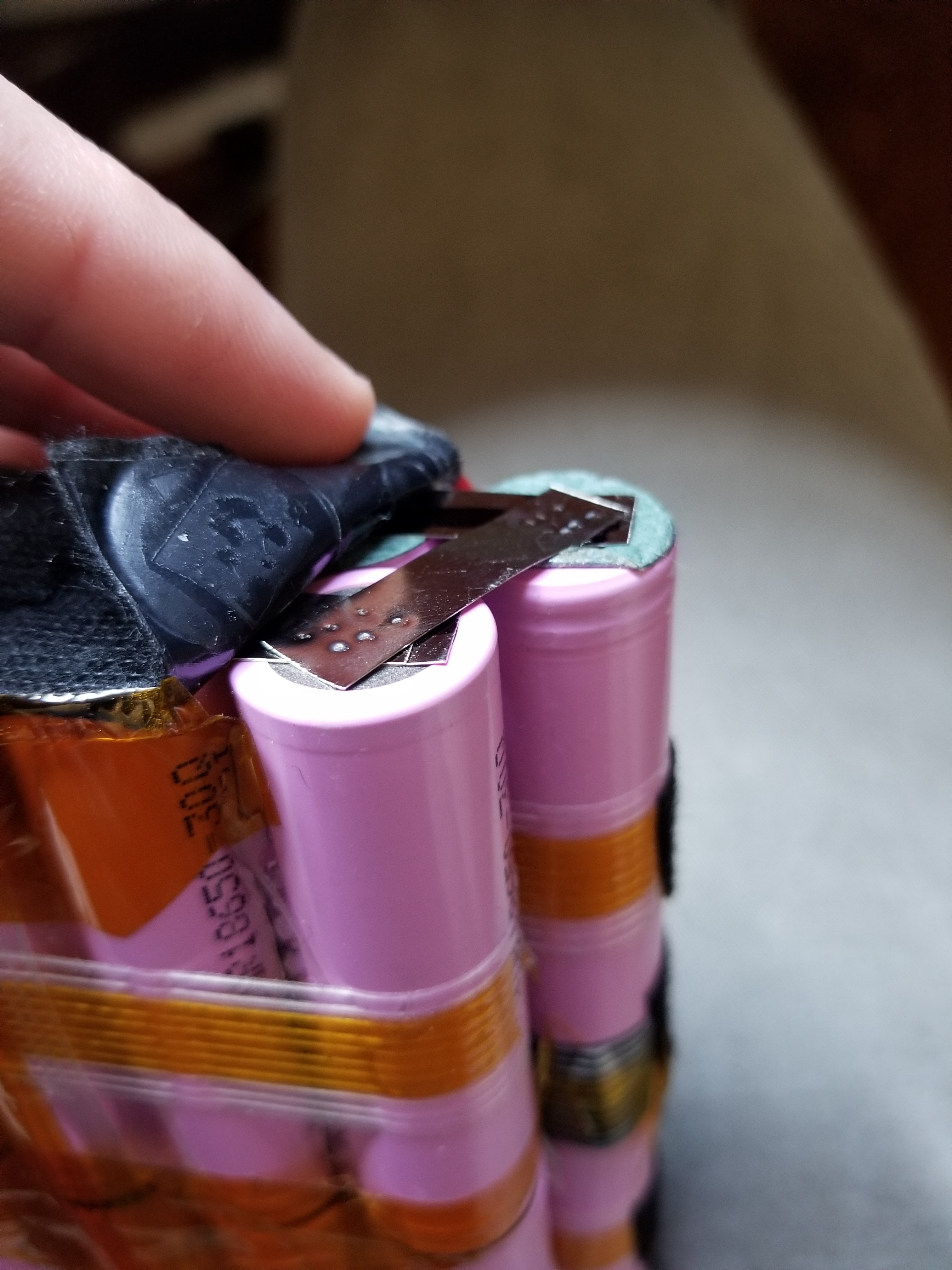

Cells are pointing north you can use folded nickle. Cells facing (Sideways)east to west you canā€™t?

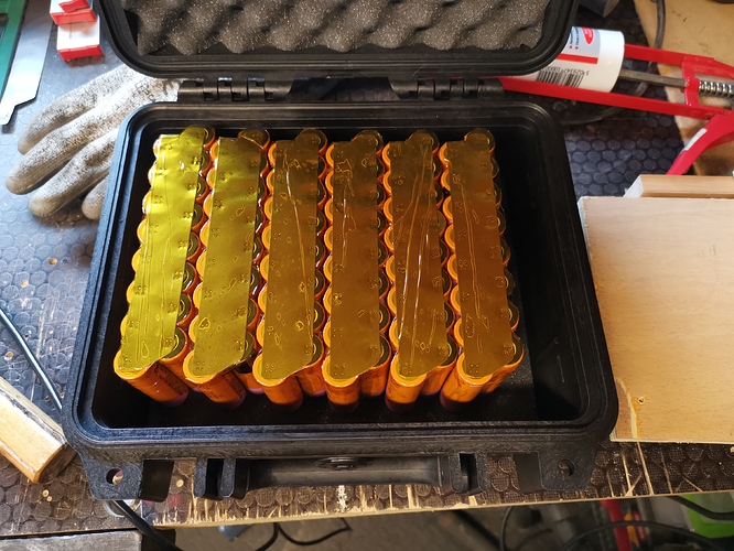

why no fish paper on those overlaps?
wait we need fish paper over overlapping balance wires? :flushed:
Cus no need. Never had an issue with overlapping wires before
Edit: unless of course you mean fish paper under the tabs which again, no need. The tape is between the cells and the tabs and then wrapped again

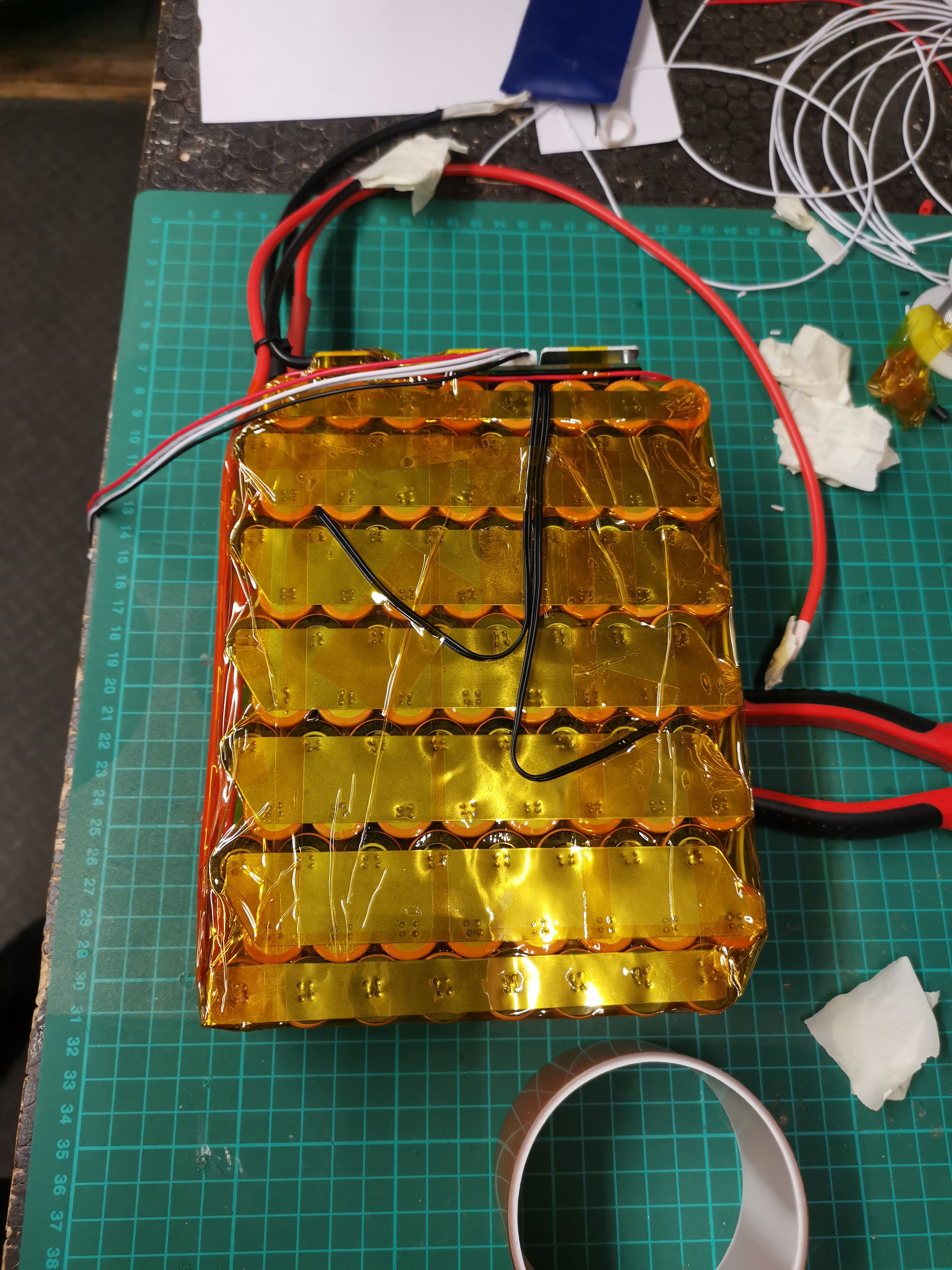

Is it possible to make a folded pack like this with folds on both top and bottom or is this a bad idea?
Lime is 0.2mm nickel
Dark green is copper braid
Orange balance wires go under the others in a fishpaper sandwich
Direction of travel is north
Thoughts?
