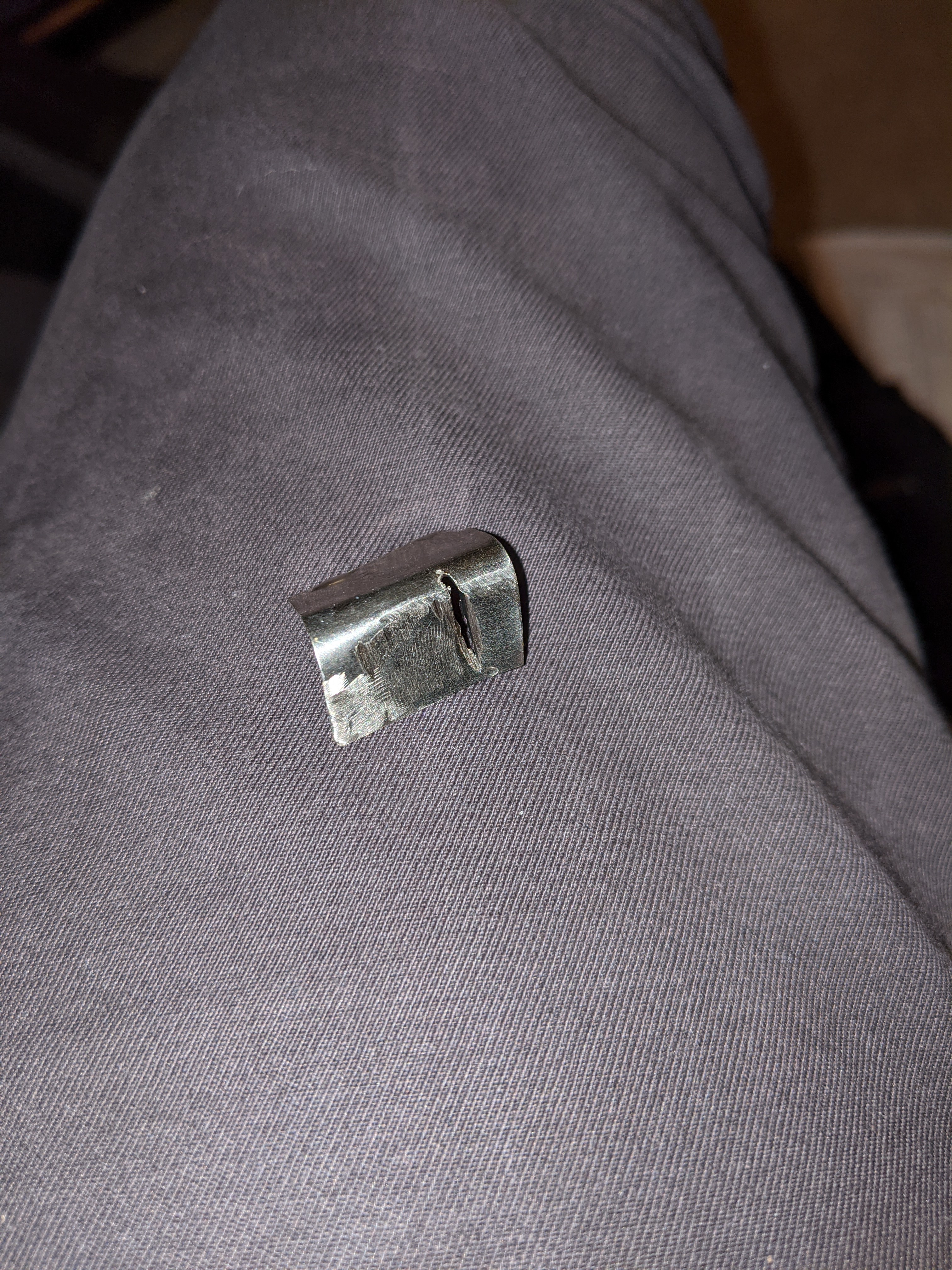

Does this look like fake nickel rust formation to you guys? 2 days in salt water brine

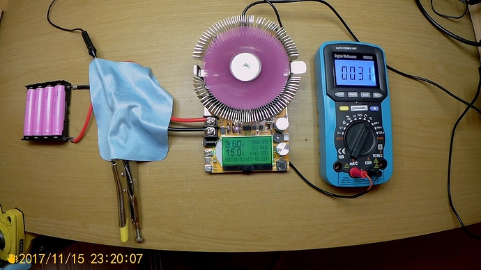

Yes. . And based off 25% of copper. I’m trying to strike up a conversation of how much one can push. Before energy losses sue to resistance turn to heat. We are all going off some possibly arbitrary spreadsheet from dozens of years ago.
Hense my question
We aren’t; the newest numbers came from an actual live test.
It’s all in the thread. Feel free to submit more experimental results! :slight_smile: It’s a dynamic document.
I’d say no.
But you give me a great idea. Next time I test, I will cut the test piece in half and toss half in the brine and keep half out so I can directly compare.

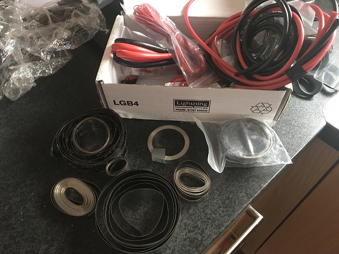

Ok you want officer tables my regs book I use for work if I want to pull 90 Amps I use 25mm2 CSA copper cable after iv calculated grouping thermal factors. Nickle only conducts 22% vs copper. 0.2 X 10 IS 2mm CSA so 50 strips should do it if want to follow BS7671 standards
A car starter motor normally uses 100A ish to start up look at you car battery cables
@Battery_Mooch you said you might look in to nickle and cables. I would really like to know what temp the nickle gets to when sandwiched between battery’s
100 amps at 11 volts it’s not the same at 45 volts
When talking about ohmic (resistive) heating of materials it’s exactly the same. :slightly_smiling_face: The heating loss in watts = current * current * resistance.

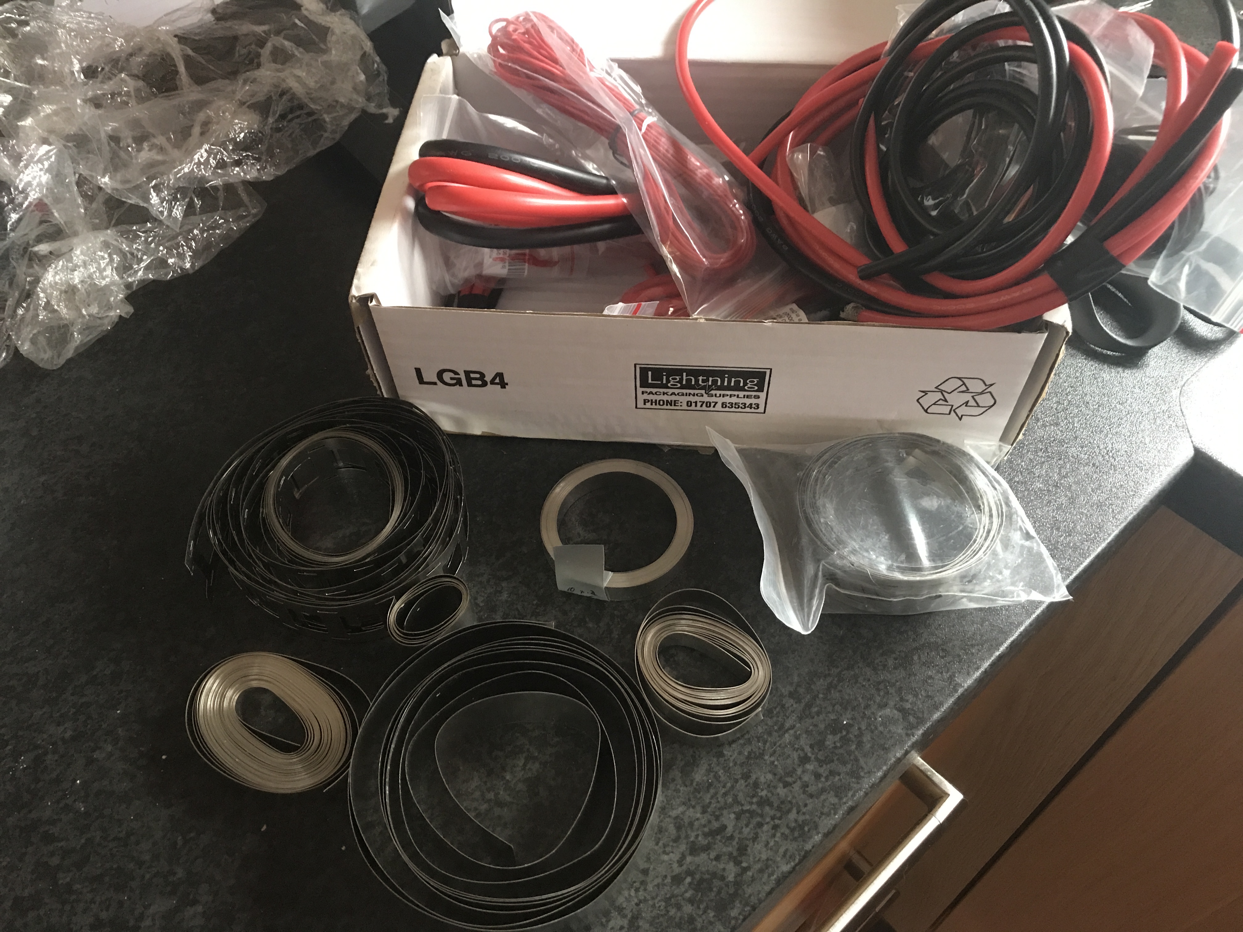

Someone is sending me a few samples of wire/strip to play with and figure out what testing I could do that would be of use to the community. If anyone has a good variety of strip (thicknesses, metal types, widths) give me a holler. :slightly_smiling_face:
The biggest problems are that there are voltage drops and heating at any current level. The higher the current, the greater the losses…of course.
Where does the loss become unacceptable? That depends a lot on the person’s priorities and the size/weight/dollar budget for the build. The community will have to establish limits for losses and then test to those.
Or, if a go/no-go limit is not needed the losses can just be recorded for various configurations and each person determines the losses for their setup and decides what widths/gauges of strip and wire to use.
It gets a LOT more complicated than that depending on the build’s configuration as each component contributes to heating or cooling of another nearby component. But, rough numbers can be gotten.

4153412281. I’ll send a shitload
