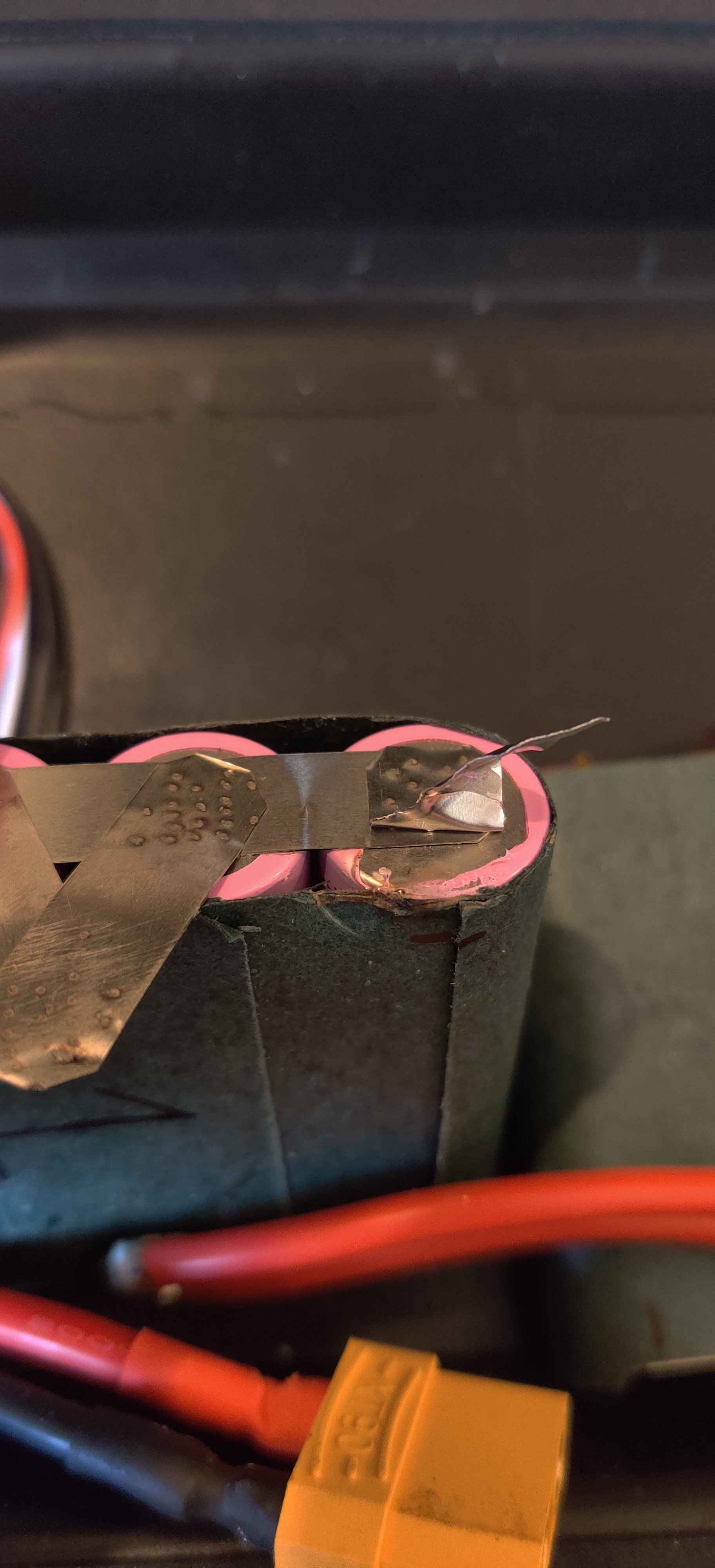

So uhhhhh my dumbass shorted my p groups on accident (I wasn’t even working on my pack at the time, but they should’ve been covered anyway, I know :cry:)
I don’t see why I wouldn’t need new cells, but lmk if reusing them is okay. I think I’ll only need to replace one on the far left in the first picture, and maybe the one on the far right in the last picture.
My question is: is it okay to make new p packs or replace cells in a p pack with new cells at potentially different voltages? Since I’ll need new ones. I think I may have read that it isn’t okay, but I can’t seem to find the thread anymore (or its on the old forum, and its either down right now or something is wrong with my computer). I don’t see why it would be an issue though, since they would balance when its charging right?
But if not, are there any tips for discharging cells if the voltage is too high?

If they are at drastically different voltages when you connect them in parallel, you will have a spark and a big rush of current while they try to balance out. I think @janpom did the calculations for exactly how much current flow there would be depending on the voltage difference. Either way, best to limit the voltage difference as much as possible.
Just because those are the only ones that fused the nickel doesnt mean they saw more or less current. All the cells in parallel shared the load at the time you shorted the pack, so all the cells are going to be equally damaged. I would replace the whole p-group.

Damn, I guess ill need 12 new cells then :cry:. I will definitely tape up the ends that aren’t being worked on next time.
Charging them all to full is the easiest way.
I would do this, but I’ve already made all my P groups; any other methods?
