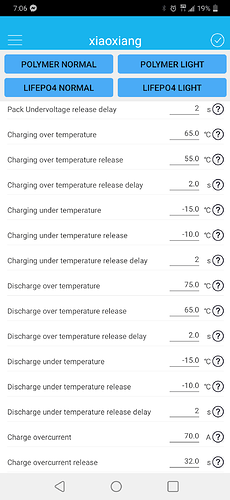

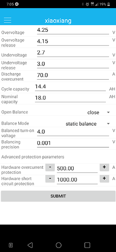

Anyone who know why the percentage always stays at 100% no matter the voltage level?
Is it because I don’t discharge over the bms?
First time having a smart bms and I have to say it annoys the shit out of me… the app looks like trash to me (xiaoxiang)

check the settings.
if the pack voltage max (or whatever) is too low it will never drop below 100%

I think there’s a PC app that lets you tweak settings inside the BMS. ( i’m only 60% sure here. looking for confirmation ) do the android app let you do that?
Yes the Android app gives you about 60% of all the tweaking possibilities, and if you have the usb module for the bms, you can plug it into your PC for full tweak ability.

I bought the 10s version so I think that shouldn’t be the issue
these are the only setting I can change. @Flasher where did you get your favorite version from?
