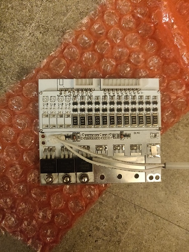

You can remove the two side pieces btw, they are ment to be broken away
