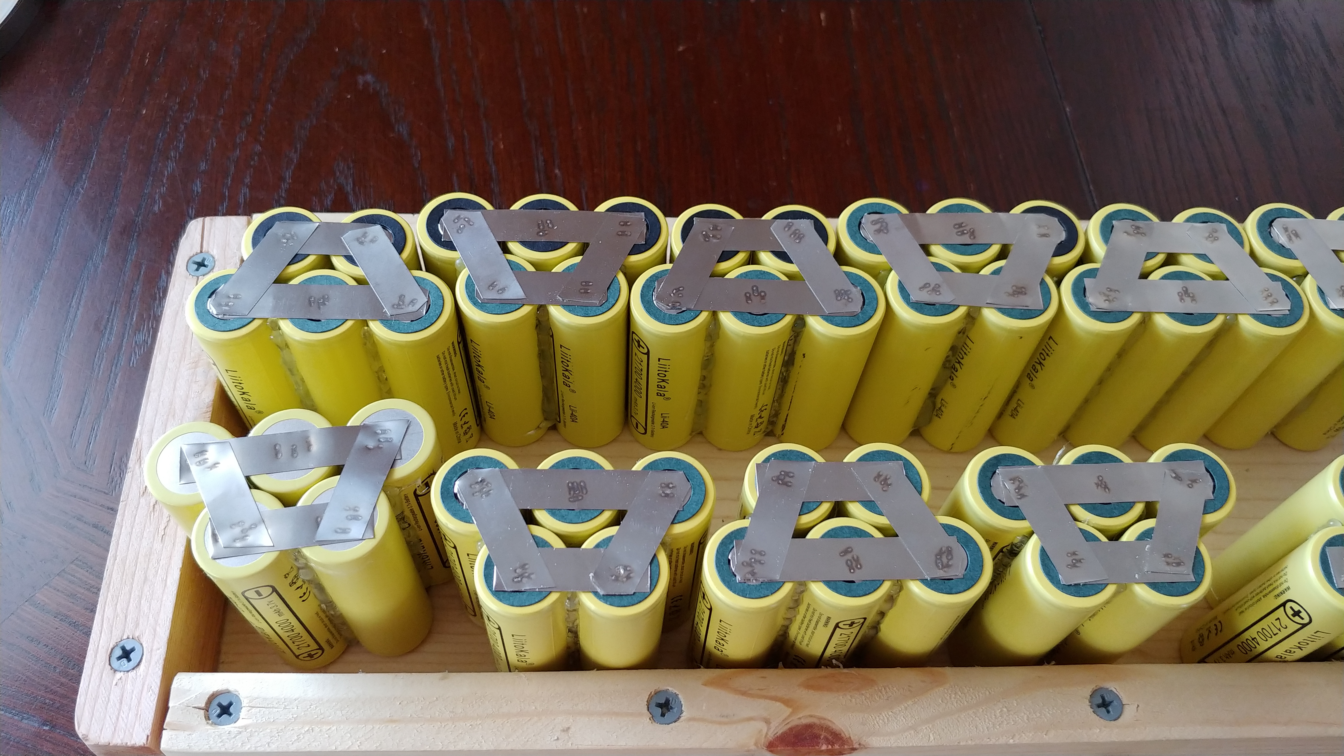

So building a pack for my Trampa. Going with a 12s4p 20700B cells and an eBoosted enclosure :slight_smile: Going to build it like they do here https://www.eboardsperu.com/product/12s4p-battery-for-hs11-enclosure/
But what is a good thickness of the nickel strips and do I dare to order from Nkon again? Know that they had issues with the nickel.
Thickness on the series cable? Is one 12awg enough or should I go with 2 (if so maybe 14awg)?

Should I use more ?
The feel to it now is that it’s quite sturdy but still has some flex to it

Thats fine, do both sides.
ive been doing a line, and the squeese the batteries togeather with the line in the middle

Is the length okay ?
