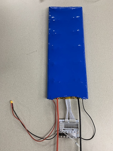

The Latest: 12S4P Samsung 40T
Complete with a fused charge port courtesy of @b264 wisdom
Last week I did something extra stupid while talking to my girlfriend and not paying attention getting ready to leave in a hurry – and the fuse on the charge port popped and pretty much made sure nothing else was fucked up besides the fuse. And I could even still ride the board right then – just needed a small, easy, cheap repair before it’d charge again. That’s the second time now the fuse has done its job. Plus fuses are so ridiculously cheap there really isn’t a reason to not have one there.
You could even argue for redundant fuses so if you make a mistake, there is zero down time. Unless both manage to blow.

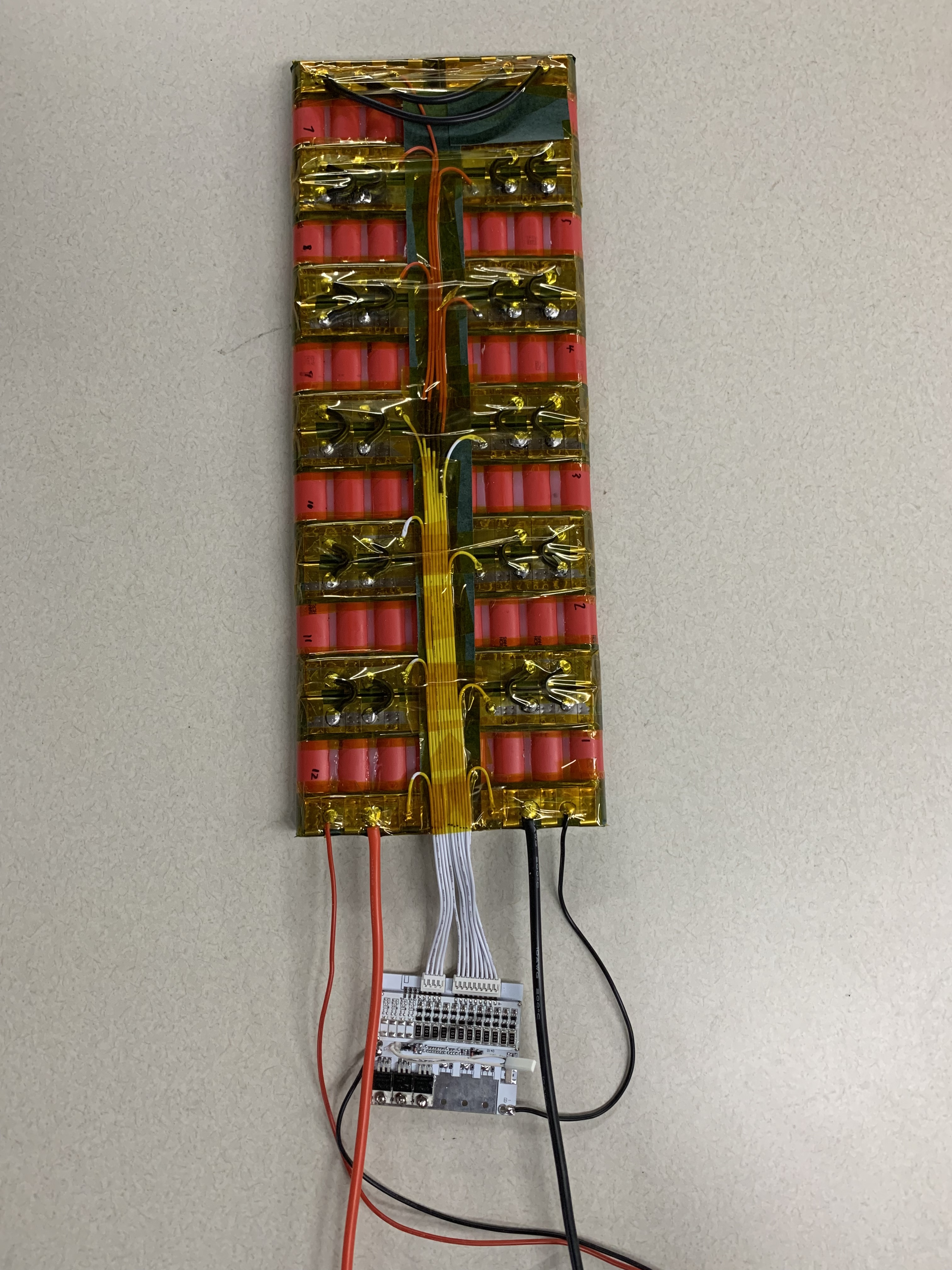

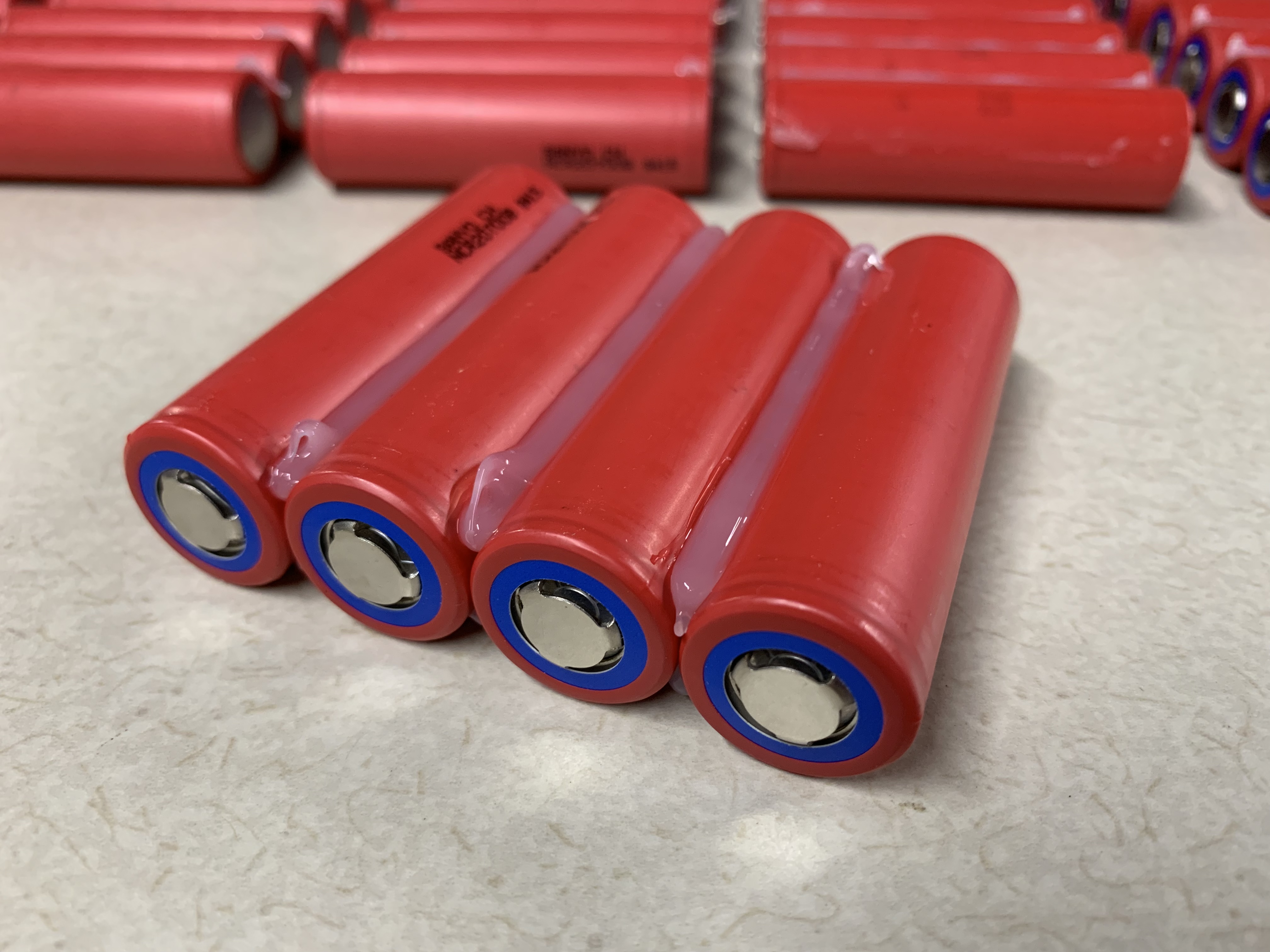

12S4P box-o-lightning.
This was my first build with folded tabs and P groups joined via copper wires… heavily influenced by @eBoosted among many other fine builders.
