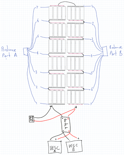

You mean do nothing with the pcb and just bypass them, use for charge only?
Well you only need it for charging right?
Yea charge only
I can’t see how that could be a problem. If you bypass the BMS, you simply don’t use the discharge features. Whether they are enabled or not is irrelevant.
Yes. You connect the VESC(s) directly to the battery as if you didn’t have any BMS. In other words, the VESC(s) will be connected parallel to the BMS. You only connect your charger to the BMS.

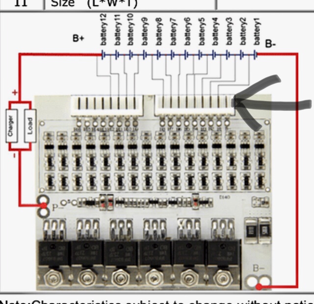

Thats bcoz i saw some of d140 that used here comes shorted circuit like they told me to do. And i was wondering why they need me to do the corrections and said its a mistake, thats why i have this confusion.
Yes this what i’m going to do, i just need you guys to convince me before wiring everything, thank you.
They sent me another email, I just leave it here incase someone also have same question about this.
Dosent the BMS need a battery neg to balance the first cell the first pin that the diagram dosent use might be a battery neg that’s just not been labled see arrow.
The difrance is do you want the battery power passing thro the board or not? What advantage would this give apart from adding more resistance?
not sure why anything needs to be short circuited, just use it for charge only and leave the discharge circuit unused.

Yea their explanation confused me, that’t why i’m asking here just to make sure. I’ll wire them like your drawing, thank you.

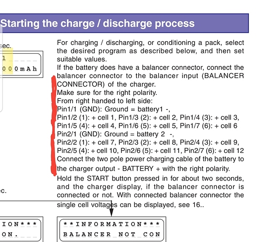

I’m getting some strange readings from my balance charger after assembling my battery.
As a reminder, I have a Graupner Ultramat 18, which allows 12s charging using 2 6s balance ports.
Now when I plug in the battery pack in only using the balance ports and not the main charge port, I get a the following readings:

When I plug the main charge port in, all the readings change slightly, but stay around 3,4v, even 7 & 8:

I’ve tested with only one balance cable at a time and all readings are roughly 3,4.

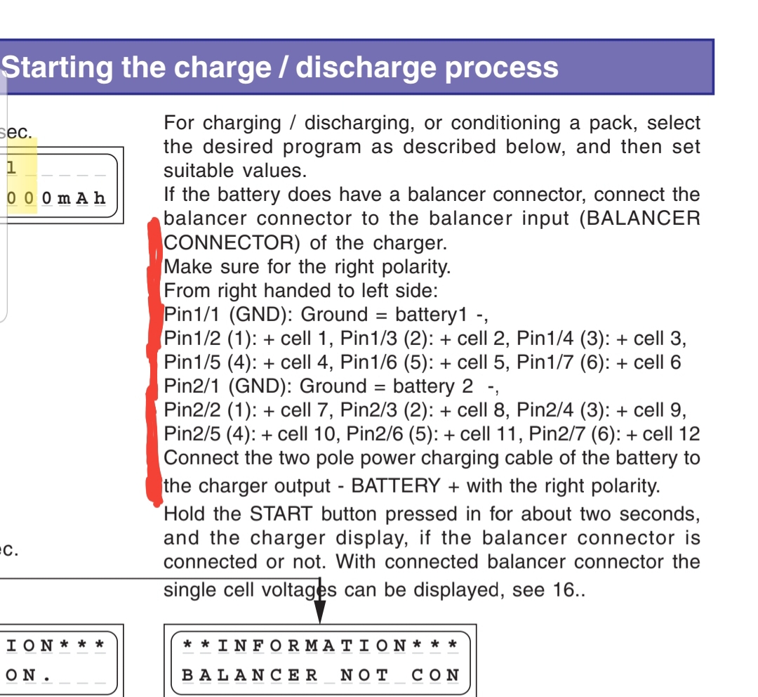

The Graupner charger has this in the manual about how the balance ports should be set up:
Any advice would be appreciated.
