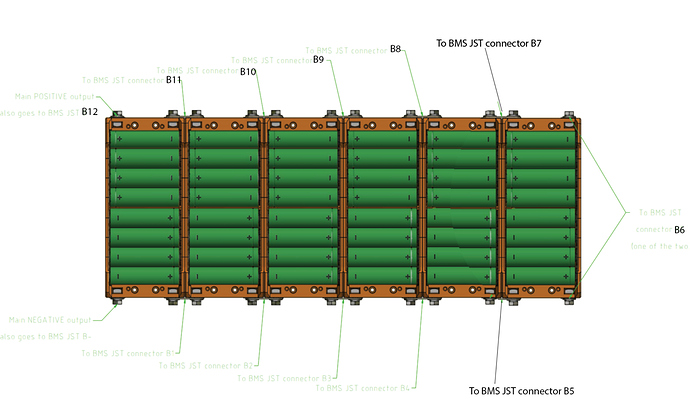

Ok, so if you would print my diagram and fold the paper in half in the middle you will have correct diagram and easier to understand :slight_smile: just need to add couple of modules and extend b1, b2ā€¦ Count to b13 for the last positive

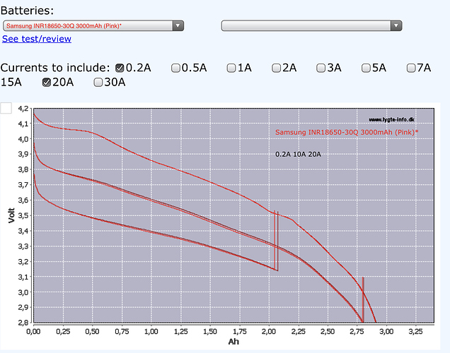

That looks pretty similar to the other graph. the 20A line stopped before the end of the discharge and your graph doesnā€™t go down to 2.5v
A discharge test till 2.5V isnā€™t really what you will ever have.
Or would you want to use your cell only for one discharge cycle and than through it in the trash.
So to take the capacity differences at 2.8V we are easy over the 5% difference.
And you are right the graphs are similar. Didnā€™t see that yours go down to 2.5V.
And you probably wont ride your board below for example 50% charge( or 3.2v or so idk) because the board will feel weak and slow

I am not saying to discharge to 2.5v but that is the point where you can compare capacities at the same voltage. When the cell is discharging at high load, it is sagging so if the discharge is stopped, the voltage will increase; you can see that in your graph. So when looking at these graphs, donā€™t take the voltages as unloaded voltage values (except fully charged and discharged voltages).
I donā€™t think I am explaining this very wellā€¦
My point is that cells donā€™t loose much capacity with higher discharge rates, it just seems like it because the voltage goes lower sooner while under higher load. For example, at 10A discharge if i wanted to have my cell at 3.1v i would discharge to 2.8v while under load then it will rebound back to 3.1v once the discharge is stopped (as your graph shows)

Ok, ive redrawn the diagram, just to be 100% if got it right ā€¦ can you confirm this is ok?
also, hereā€™s a picture of my BMS - there are 11 white leads, when the diagram you supplied would suggest that I would need 12 (since im making 12s and not 11s).
alsoā€¦anyone elseā€¦what are the wires coming out of the lower left of this deviceā€¦asking for a noob friend
12s battery has 12 negative terminals, black wire lands on the first one, the next white wire lands on the next one and so on, last red wire lands on main battery positive terminal. Black wire is the one that you think is missing. The wires in the lower left are temperature sensors
Thank you, I understand. 2 more questions.
  1. so the negative terminals in the drawings are located in between the packs - on the metal thing that bridges/connects themā€¦is that correct? (also is the drawing ive now ammended 100% correct?
  2. ā€¦where is the ESC plug/soldered on? - or do they not run through the BMS (I canā€™tā€™ see why the ESC would need to go through the BMS)
ā€¦and i guess the temp sensors don;t need to be plugged into anythingā€¦theyā€™re basically good to go as-is?
Looks correct to me.
