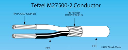

Tefzel Wire 22 Gauge.
That should get you started
Re: teflon insulation, it’s common in Mil-spec wire, I’ve got a couple spools left over from my old job and it’s interesting stuff.
AWCwire.com has a gigantic selection of wire and cable, and while their regular prices are more suited for… industrial sized orders, they also have a bargain bin section where you can often find great deals on partially-used spools of all kinds of interesting stuff, including teflon. It’s where I got all my flat copper braid, and a couple sizes of heat shrink tubing.
would you in your opinion class all teflon insulated wire as better insulation?
or is it like all wire… know your project and pick what best suits you…
seems weird I haven’t at least run across PTFE insulated wire before…
now I gots bunch a reading… thanks @glyphiks and Ryan!!!
EDIT:
fack this is purrfect for running a noisey temp. sensor motor wire…
To be honest, i prefer silicone wire. But this stuff is super handy for battery building with space constraints.
I definitely wouldn’t use it in a high movement/flex environment.
so it’s like expensive plastic insulation… it must solder kinda like silicone insulation??
Solders more like plastic insulation, gets melty, but not as bad as plastic.
I need to buy some
for science
thanks kiddoz!!
I just bought some. I like it
Esp for balance wires
Bit tougher than silicone and has great heat resistance.
