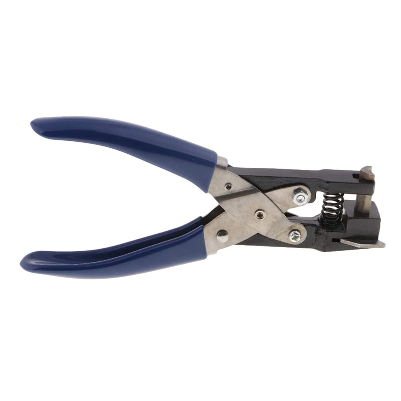

found it on amazon, did not really look too heavy duty to me, stamped metal and plastic & did not see any replaceable die or way to disassemble. Nickel is fairly soft but it would wear the tool much faster than cardboard. It is on prime tho.
For the money this appeals to me more, but not sure what corner radius to get? I’m guessing 3mm is the one you want to cut the radius for a neat positive terminal on a 18650/21700 cell
options are 3mm, 6mm etc, of course the China delay thing. The dies looks pressed in I guess it could be removed and sharpened eventually, I actually did not find spare dies for it, that part was a total fabrication.
Yeah it’s not the most spectacular quality but I needed one ASAP for a build so even if it only lasts a couple packs it’s worth it
I’m probably gonna get a better one down the line but now I can afford the China shipping times

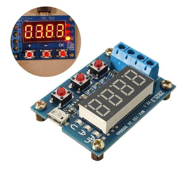

I bought one of these little coulomb counter boards from the usual scumbags, and I use it for all my cell capacity checks.
Doesn’t really matter what you use, as long as you use the same thing each time and it’s repeatable.

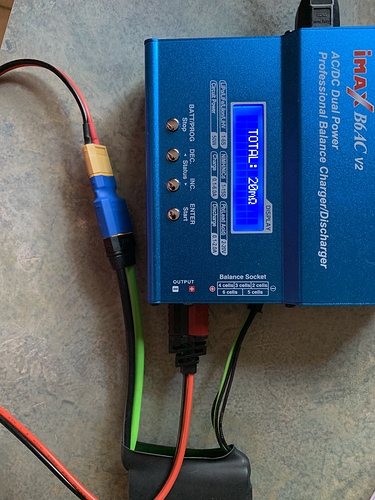

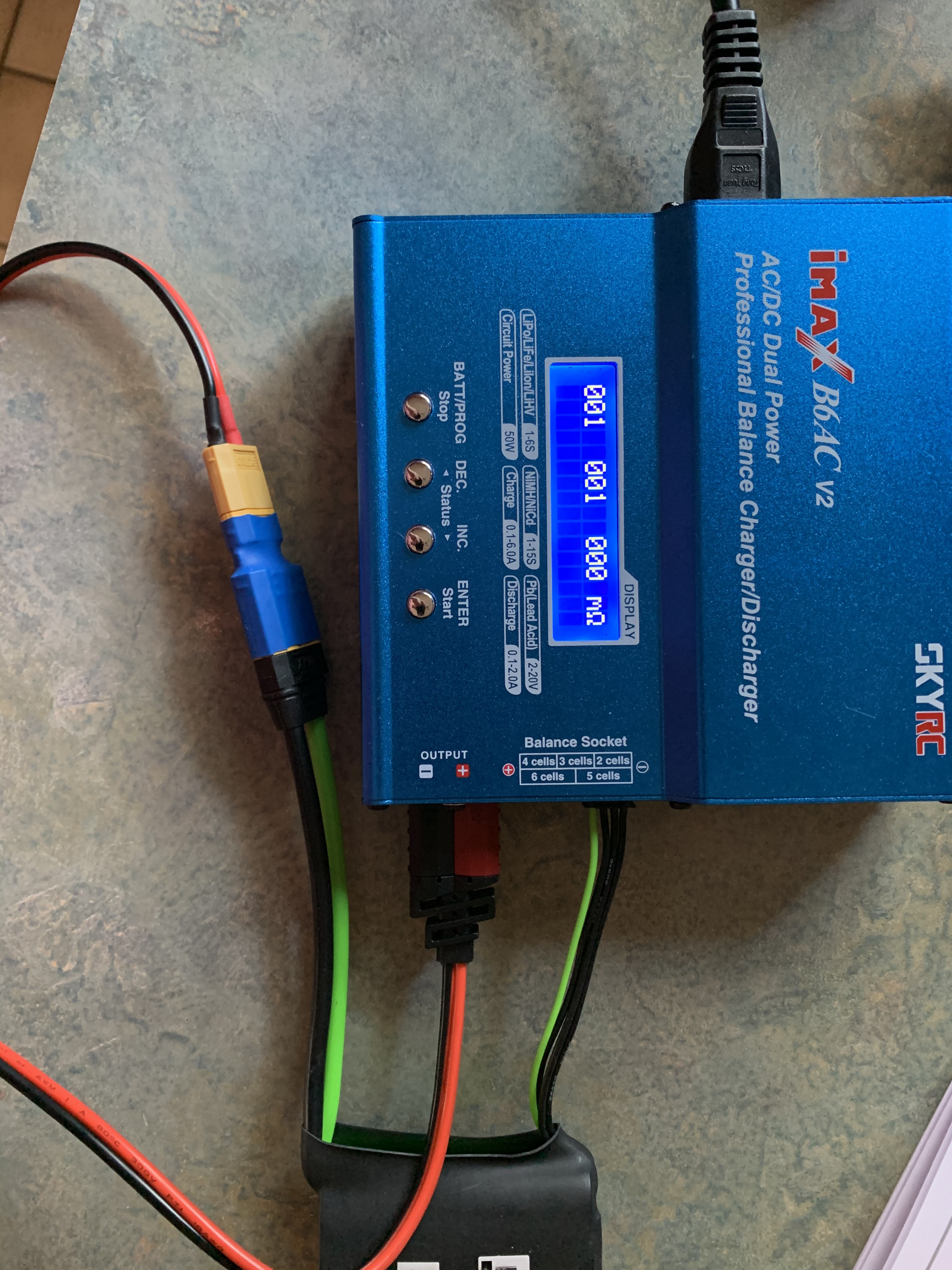

@kook or anyone else please send help? Why do the number not add up? I was checking my 3s lipo and if I have the balance leads it reads 1/1/0 total 2 but with just the main leads it’s 20. I triple checked and the numbers are consistent

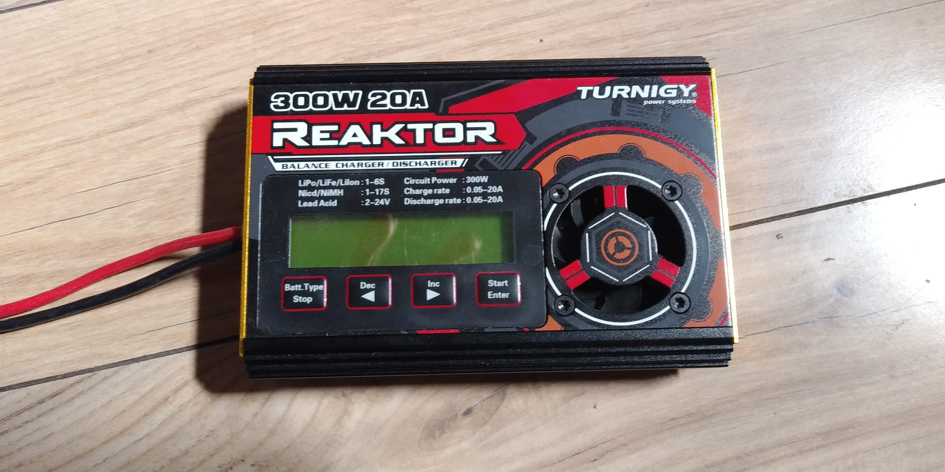

Look into ISDT chargers. Amazon carries some. Great chargers for the price. The reaktor stuff from hobbyking is ok but older tech. ISDT is newer, more compact, with better balancing. Some do IR as well if I remember correctly.
weird.
the docs don’t mention running it without balance leads. but it clearly gives a reading. I wonder why it’d be different.
maybe there’s some extra resistance somewhere in the main leads that isn’t in the balance leads?
also, is 1mΩ expected there? which reading seems more out of wack?
do you have any other cells you can check?

My corner chompers have done thousands of chomps and still going strong dude, they are a great tool
@Zach that’s weird…
you have the balance and the main leads connected correctly with the negative of the balance lead in the correct orientation
I’m unfamiliar with your charger, mine auto detect the number of cells
can you get voltages of all cells? is total voltage similar?
maybe check all the voltages and the balance lead connectors at the balance JST

I really like ISDT chargers and the HOTA dual chargers are pretty fukking good as well
