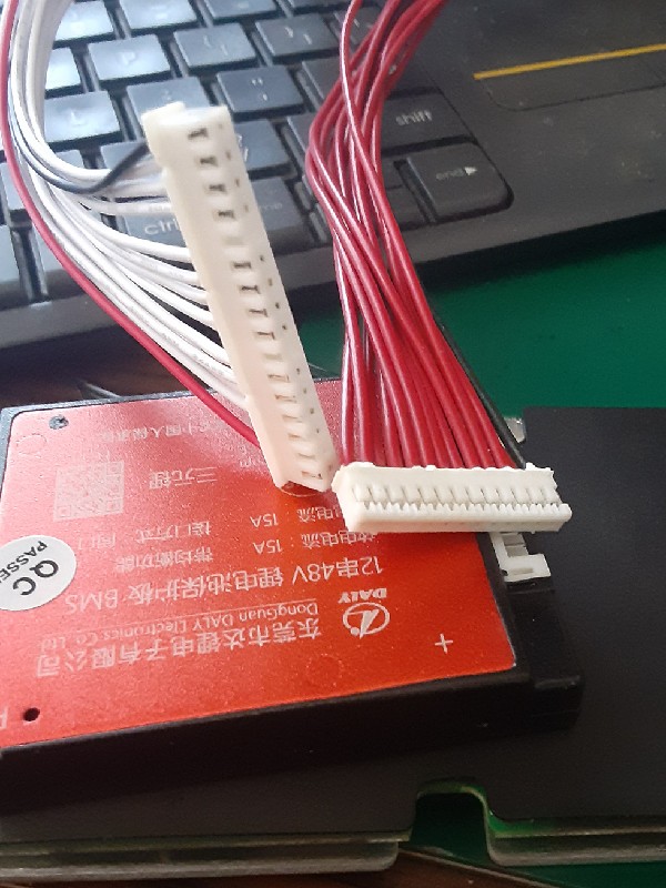

what gauge wire are balance wires typically?
24awg
I’ve seen them range from 18awg - 26awg
are the connectors always the same JST? is it JST PH 2.0 ? or do they vary?
I think 22awg is the largest that fits in those pins ?
so they must vary if you’ve seen 18awg. hmm.
ok thanks.
It was when @Skyart was making a battery for @Halbj613 and literally had nothing in 20awg or smaller
Not the same… Varies per mfgr.
Both 12s BMS
I use 20awg for pretty much everything. I have this teflon wire stuff that has really thin but strong insulation so I can use a heavier guage and still fit in the smaller connector.
Even 30awg is good for an amp and most BMSs can’t balance that fast so I don’t think it makes much different
