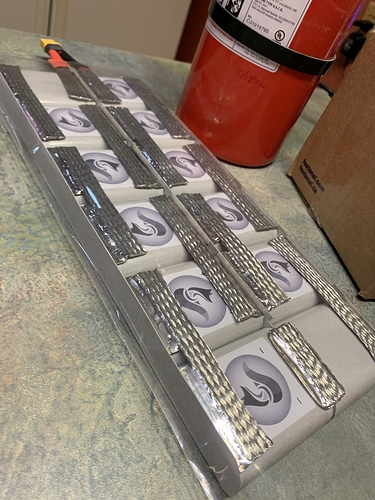

You boys said clear? I really wish I didn’t have to put fish paper in between
It’s thinner, the stuff I have (12AWG equivalent) is about 0.75mm tall.
It’s cheaper if you buy a big roll, I think I paid like $20 or so for 80 feet.
You only need one piece per series connection, so that also means cheaper.
You don’t have to strip any insulation.
@tinp123 The copper braid I have is the equivalent of 6awg silicone wire (101A) and is only 1.5mm thick…the 12awg silicone wire (41A) runs 4.5mm
Ah for there I will use around 3 layers of fishpaper. Or you can do the cutting board idea too

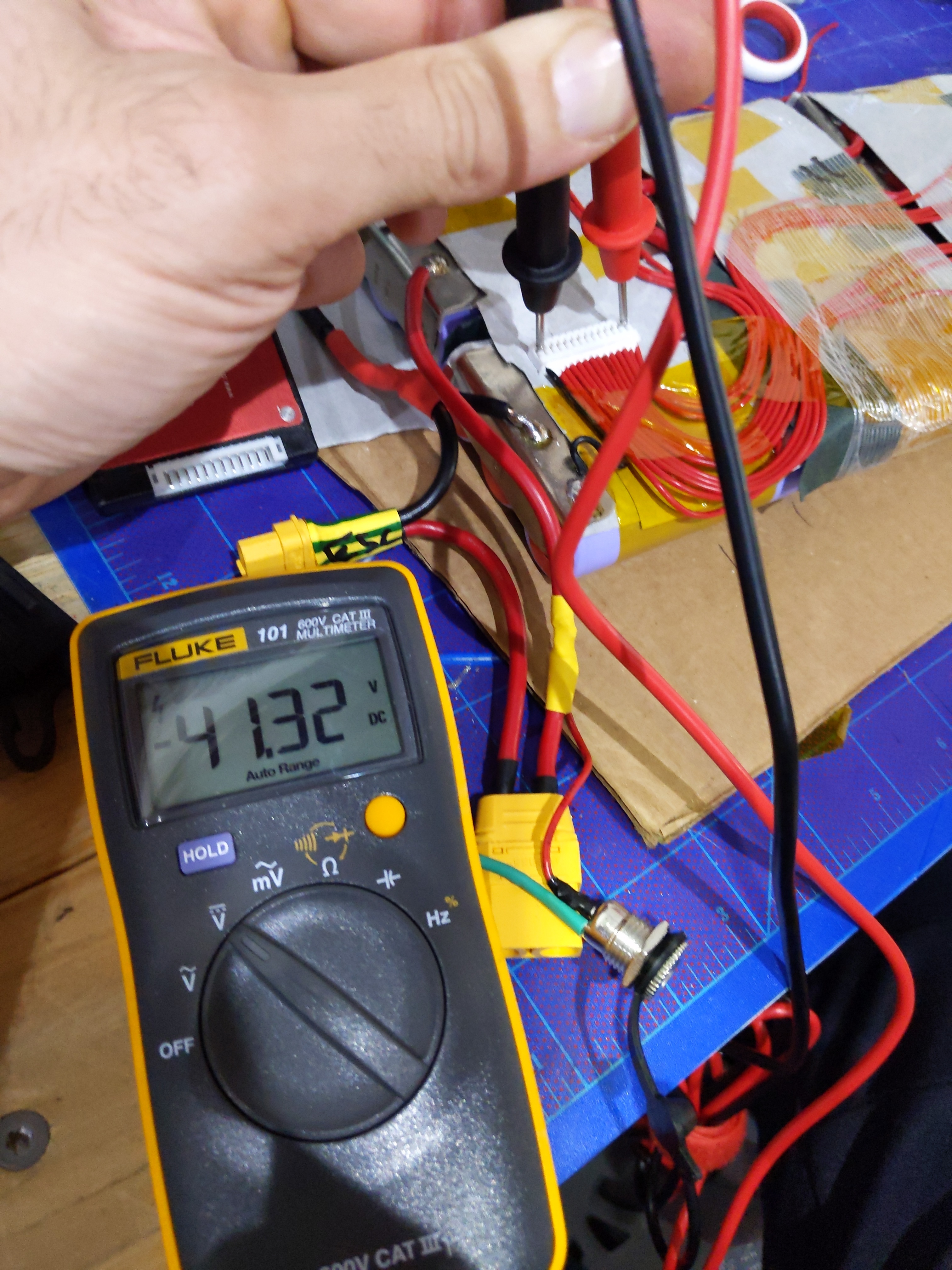

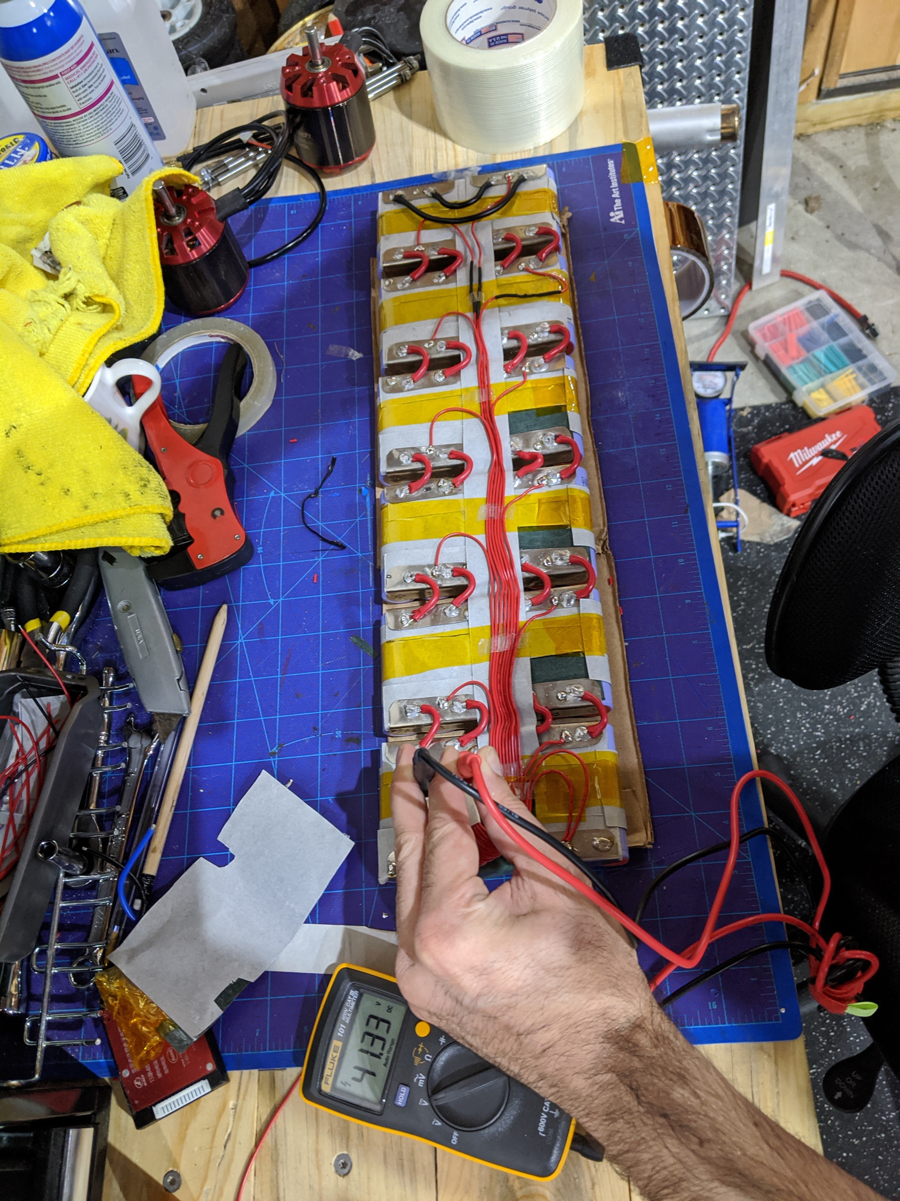

Ahh too late…if this bitch don’t balance I’m blowing my brains out
Cover it cover it cover it. My brain is screaming “FIRE!!!”
drop anything close to those leads and you’ll be screaming the same word :joy:
Haha don’t worry I will, it’s in some shrink wrap until I finish it
Gotta do the charge port tomorrow
Remember that one really cool time?
I fixed it. Pack design credit @Skyart
