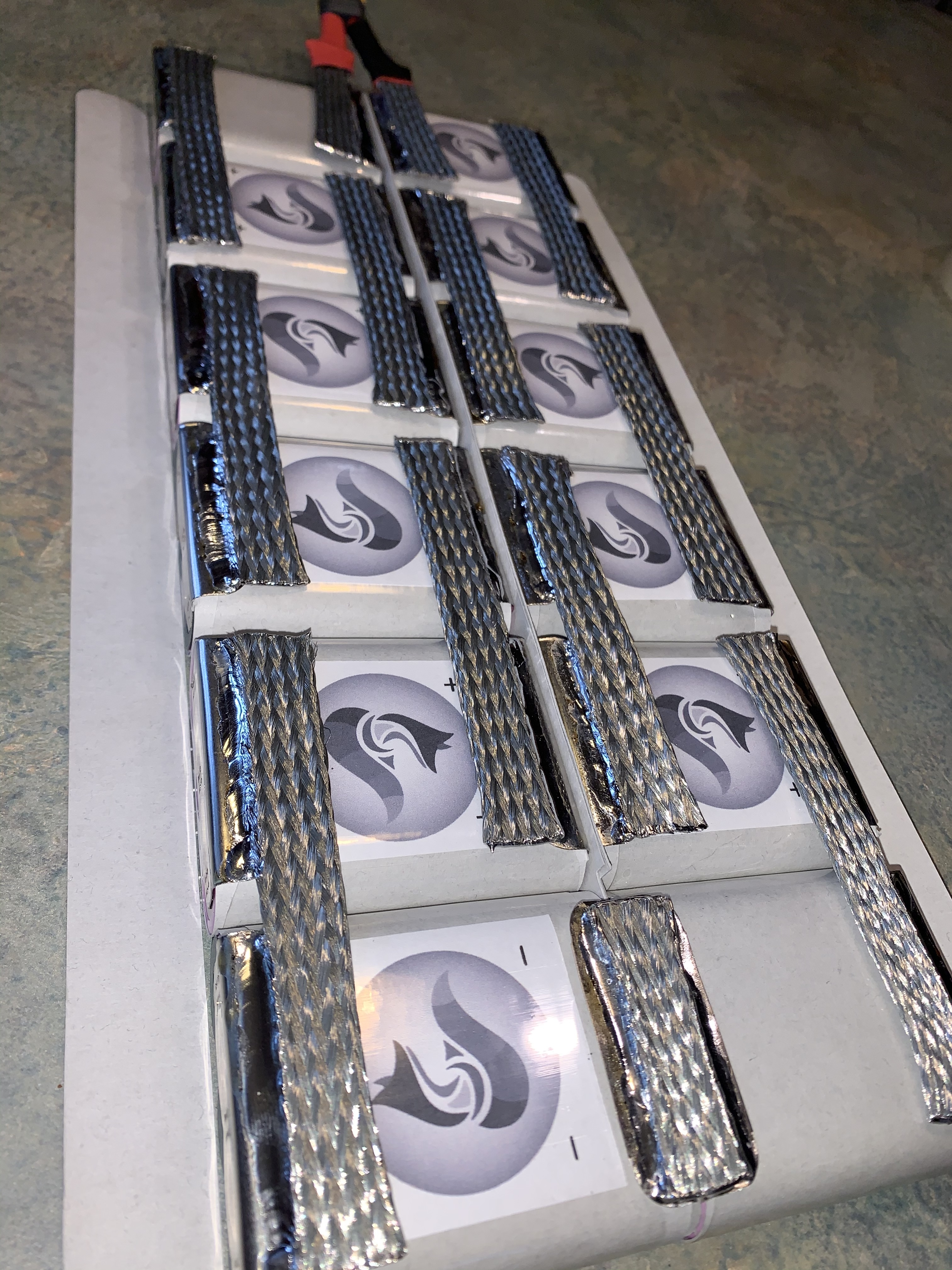

I’m not cranking these out left and right, but I want the quality to be as high as possible
@fessyfoo haha it’s all the same now

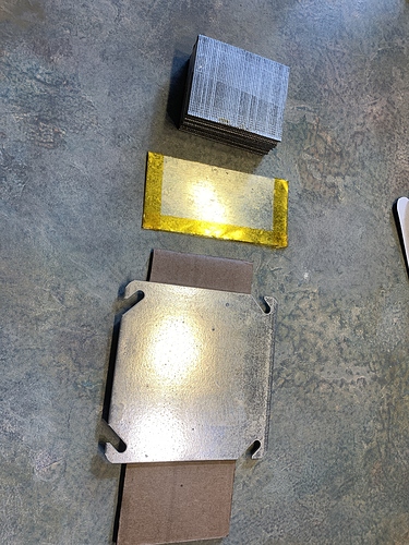

Heavy block has the thermal mass, thin plate protects the cells, big plate radiates it all…I’ll have a pic of it in use soon
I like the heat sink thing, but things can get sparky quick.
I just use some metal clips, just enough to wick that heat away and not soak the braid
Those packs look good, I’d buy one.
Aww thanks!
I was worried about sparks so the thin plate has kapton under it and the big one is hot glued to that big cardboard plate
what is that heavy block?

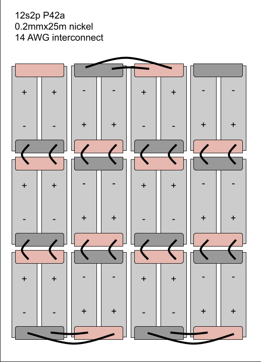

This is the battery layout I’ve been considering for my 12s2p tayto
seem reasonable?
I’m making literally that exact same battery for my integrated deck lol, like 100% the same design…should be totally good
Oh that’s just a block of 18 ga nails
