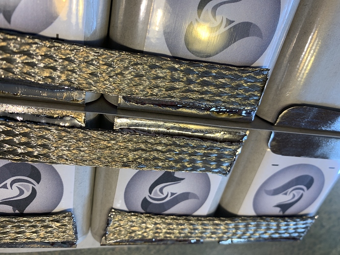

is that 3/4" braid? I got some, works good, nice work on the soldering therešŸ‘
1/2" would have been enough and marginally cheaper. But YOLO and all…
No this is 1/2", I’m gonna order some 6mm stuff though
Yeah I understand the tradeoff. I’m hoping to be able to take the modules on a plane as they are all under the flight limit.

Lol, thats crazy. Why not cut the braid down so it spans from the middle of one group to the next?
…I want it to look pretty? I want to sell batteries through the next couple years to pass the time stuck with online classes and try to even out the prices on some of the parts I bought, this is the example pack so I really want it to look good
Which now means you’ll be stuck using that size braid and length on every pack. When a battery is sealed, I refer to the builders example pack
IMO it would look prettier with the braid landing in the middle with a small solder puddle just at the end of the braid.
If your intention is to solder to the whole bit of nickel, you’re gonna have a shit time and end up with a stiff series connection.
Haha but you see, that’s where you’re wrong, if found a way to make the solder joint look like a professional TIG weld yet there’s only a little bit of solder wick…still hella flexy!
Fair point, I’m gonna take pictures as I go for each pack (liability reasons) so there will be an understanding for what’s under the wrap
What do you guys recommend for separating the end to end parallel groups? Is a layer of fish paper good enough?
I wrap mine individually. Especially in a flexy setup. But I’ve used partial pieces between P groups in some.
Glue, fiberglass tape, adhesive fishpaper
So how many layers between the nickel? The can to can contact has a layer of paper and heat shrink on each
I’m thinking I’ll have a strip on each side so it’s just the paper that makes contact with another piece of paper, all the nickel is rounded so it’s pretty smooth and flat
On the 21700B cells I built a pack with recently, any where that I had a folded connection or a positive terminal that had to come over the edge, I would build up to the top of the positive terminal.
For those, I used two of the fishpaper rings on each cell. I try to build the fishpaper up flush with the top of the P terminal so the nickel is bending straight from there. Less chance of it getting to the cell body
For the sides, i think if each P group has a fishpaper later you’re good. Ideally it’s fishpaper against fishpaper.
