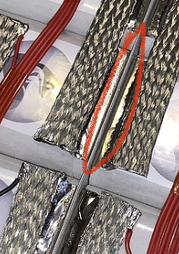

Haha I was hoping nobody would catch that. The wire sat better if it was under the braid so I desoldered the connector and flipped them, I’d have rotated them instead of switch and flip but the wire isn’t centeted
I forgot heatshrink looses like 5% length would have cut it longer otherwise

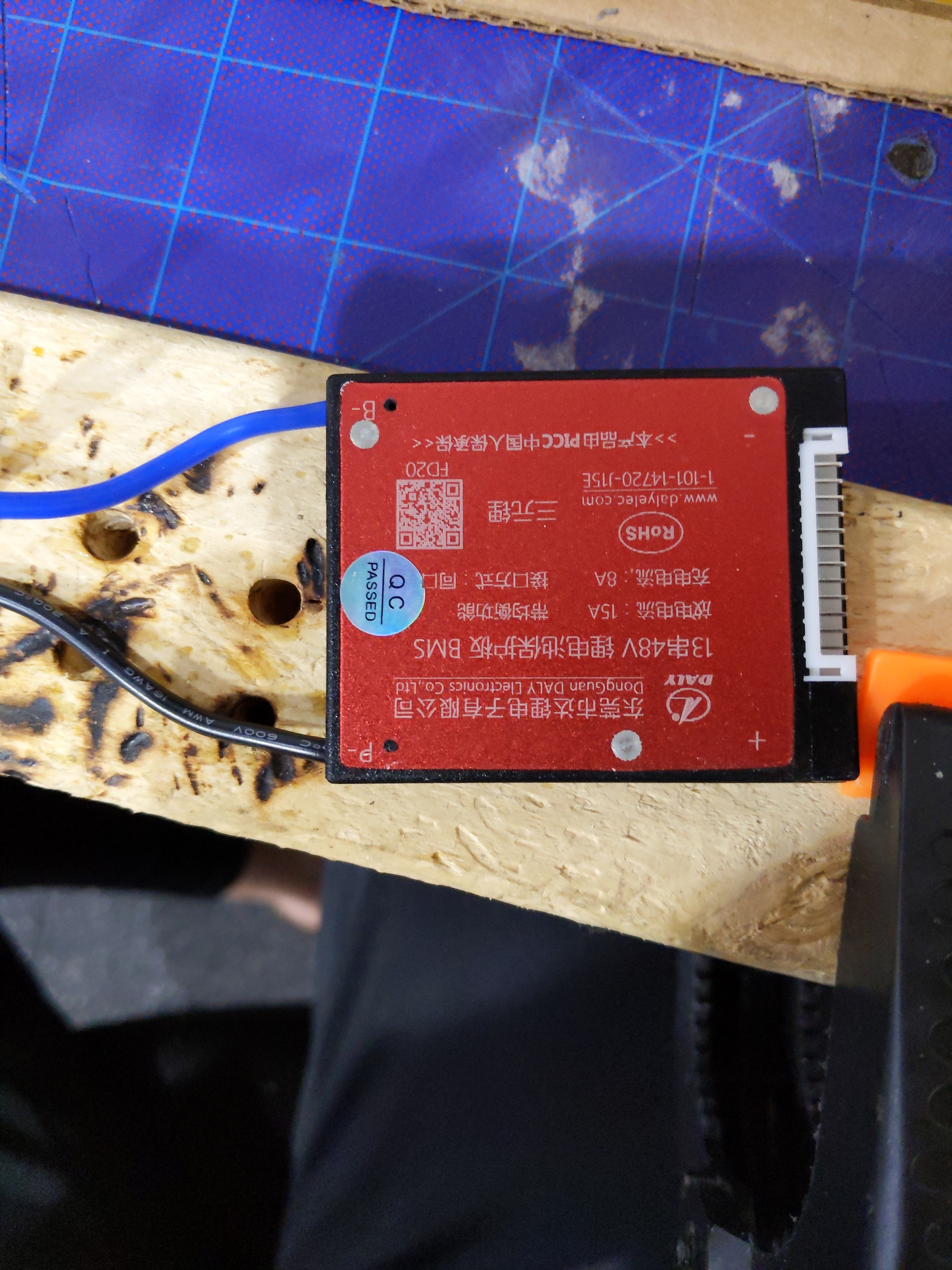

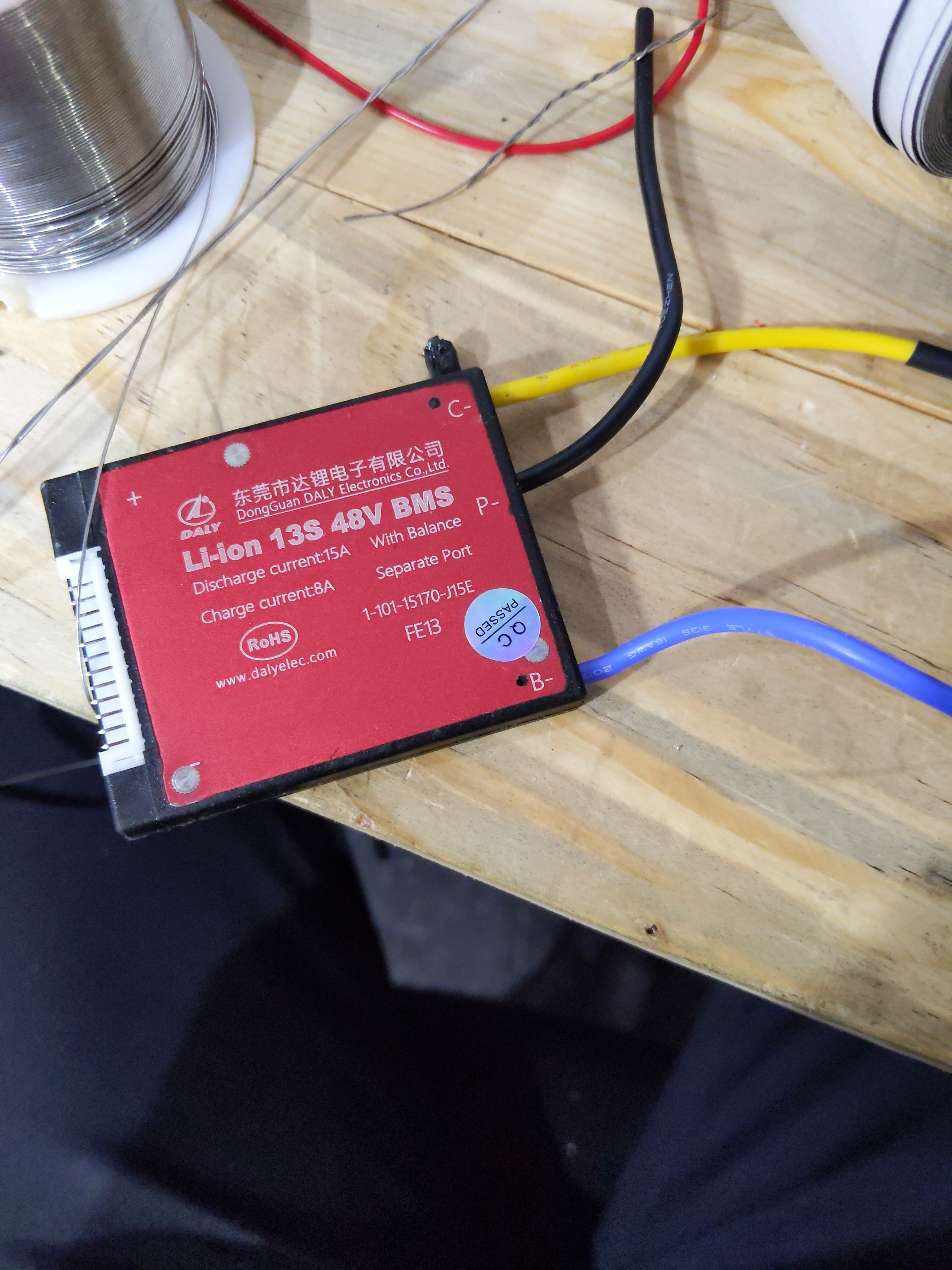

Hmm my old BMS that I blew, I had wired through the C- and B- wires, and just didn’t use the P-. This DALY BMS only has B- and P-…
Do I just solder everything like the P- on the new BMS is the C- on the old one?
Just as recommendation on the side, I would regularly open up the enclosure to check the braided copper connections. Especially on the place where you go out of the pack there will be movement which can break the copper over time.
I didn’t follow the progress all the way, so sorry if it was mentioned before.
The clear hear shrink is going over the braided copper as well?
Those places look pretty close to each other.
If not isolated properly that might cause issues one day.
Yes there will be a layer of fish paper over the top and clear shrink wrap over the whole thing, the center divide has 2 layers of fish paper and the metal is very rigid so the metal won’t make contact unless the pack is badly damaged or both layers of fish paper are compromised
The pack is not for me, it is going into a modded Halo Board, I have asked the owner to regularly check on the state of the battery to ensure the shrink wrap isn’t damaged on the braid high points and they agreed. The sides and bottom are flat and have a layer of fish paper and shrink wrap so I am confident they will last longer than the top
Edit: the fish paper divider is taller than the battery, it’s hard to see but there is no line of sight between the sides except the end where I cut a notch for the 6 to 7 group bridge

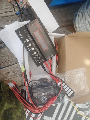

Voltages check at 22.2/22.3/22.4/22.3
Can anyone tell me what’s the maximum voltage difference there can be between lipos for my series and parallel connections? Don’t want a fire cus
0.01v would be better…if your feeling cheeky you can plug resistors in-between the balance leads of the packs you want to connect in parallel so each cell is the same, and worst case is you blow up a resistor
I’d match the .2 and .4 so they all end at .3
So I’m currently good to go as long as I don’t put 22.2 and 22.4 together?
Do you have a balance charger? Set them all to storage and they will end at 22.2v
Yup this little guy
But if you have 7 resistors on hand you can take the .2 and .4 and bleed power from the .4 to the .2 by connecting all the balance leads via resistors… negative to negative, one to one, two to two, then let it sit for a bit
Yeah just bring them to storage voltage, easy and safe
