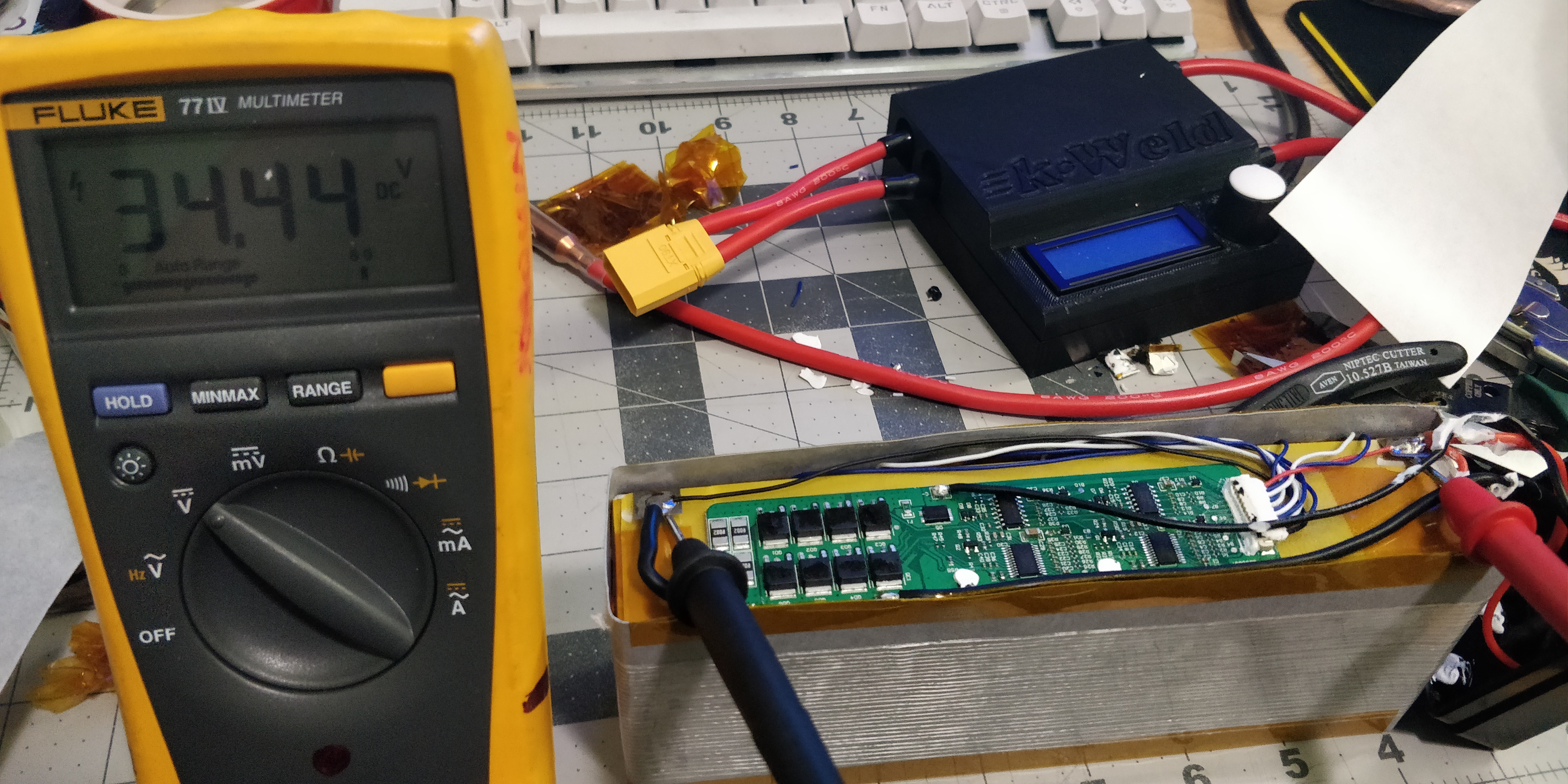

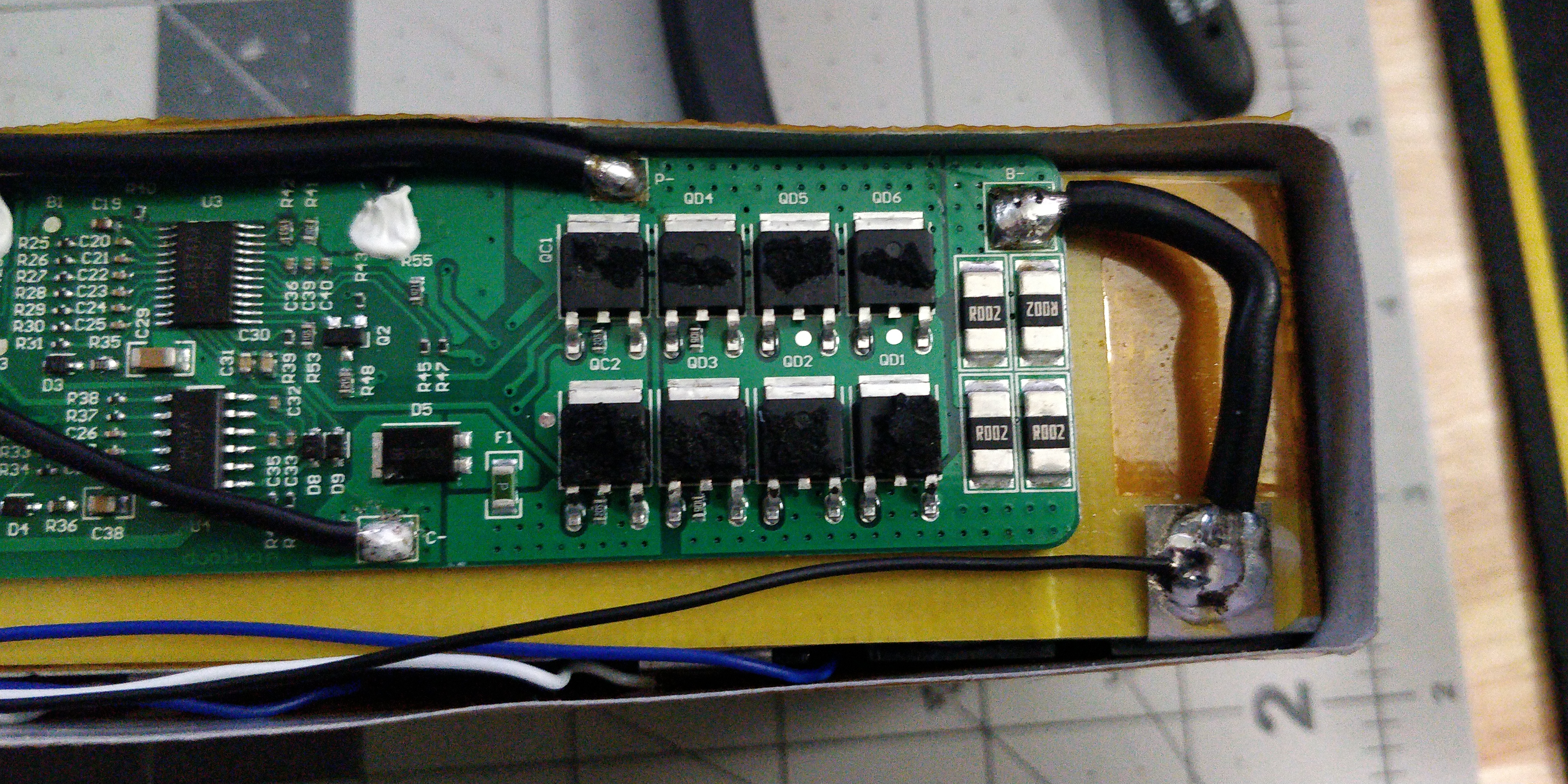

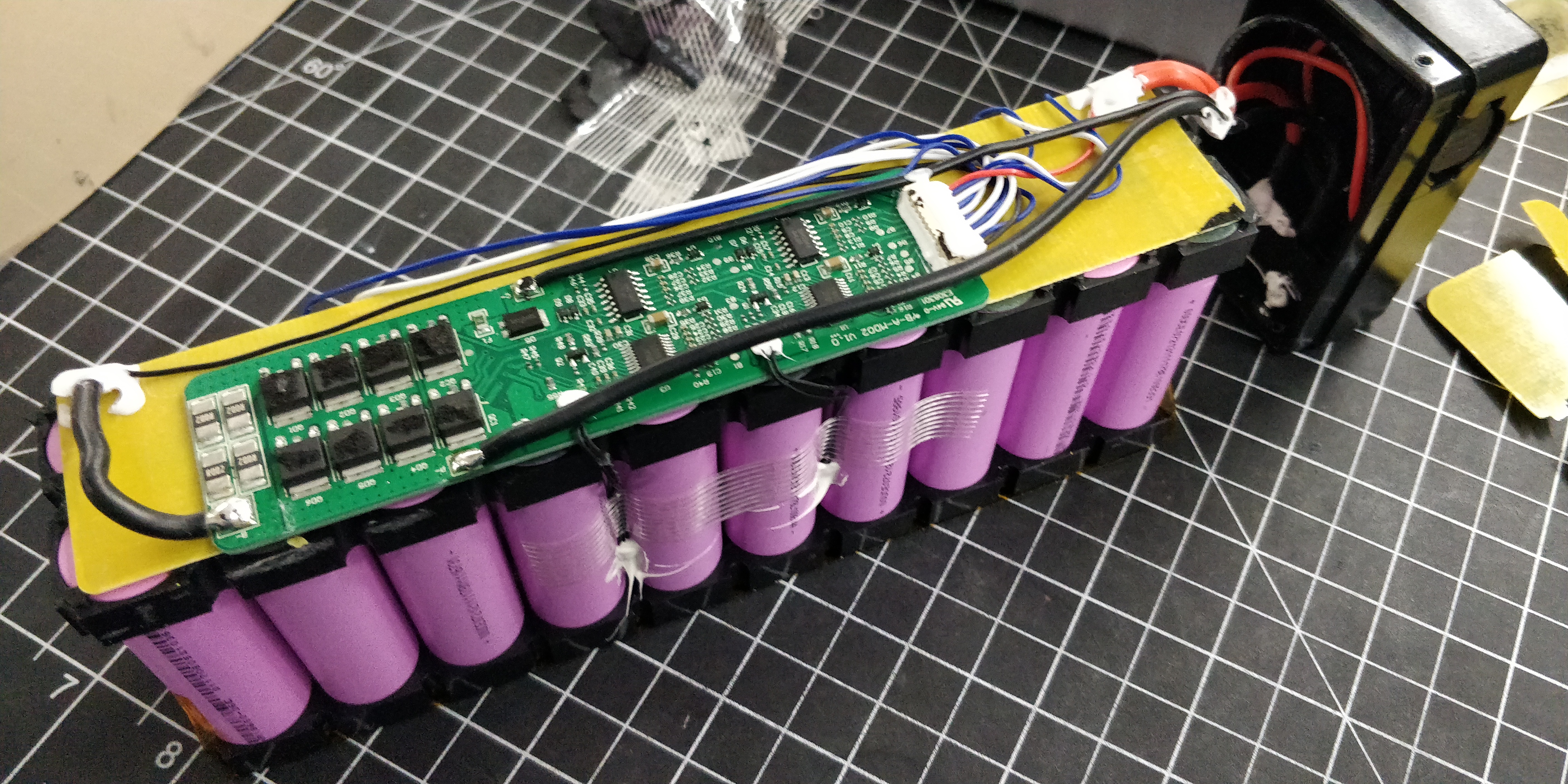

Rebuilding this 10s2p for my friends scooter due to a bad P group. Built the pack and I hooked up the BMS as it was originally but not getting any voltage out of the main connector (which is connected to battery positive and P- on the PCB)
I get 34.4v between battery positive and battery negative though
And this is how it was originally wired
BMS has probably tripped from a fault. Verify balance and restart the BMS, see if she plays nice after
I’m dumb, I forgot the BMS probably tripped lol, lemme try that
Power cycles my guy… When in doubt, always start with a power cycle :grin:
