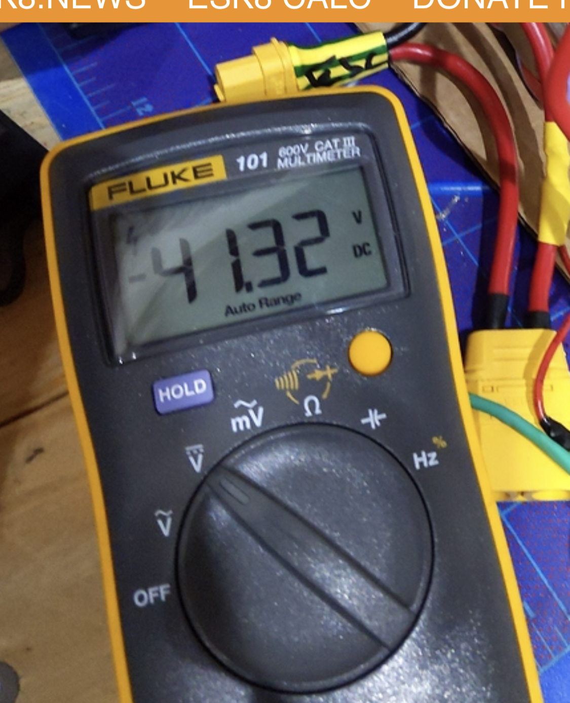

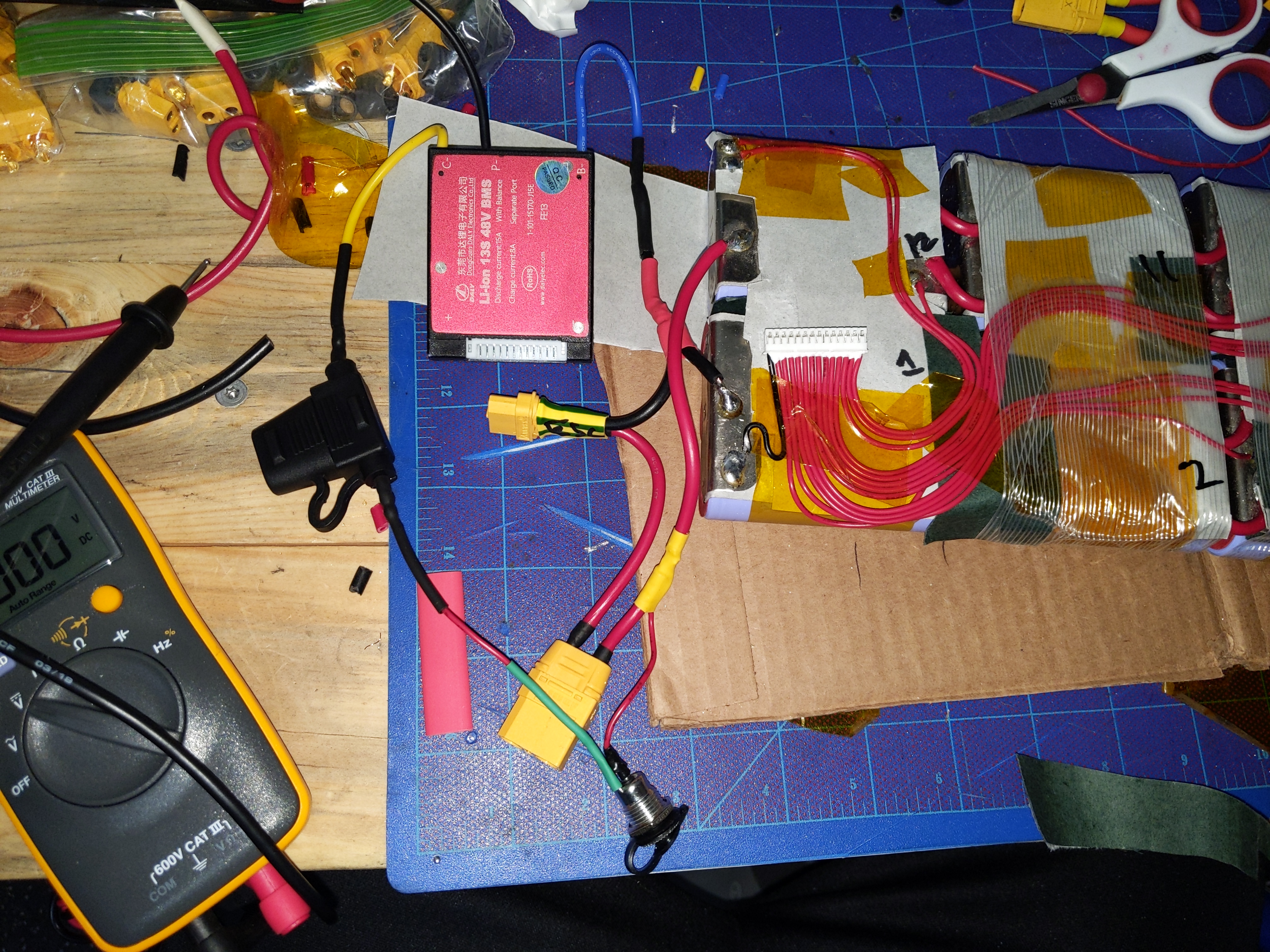

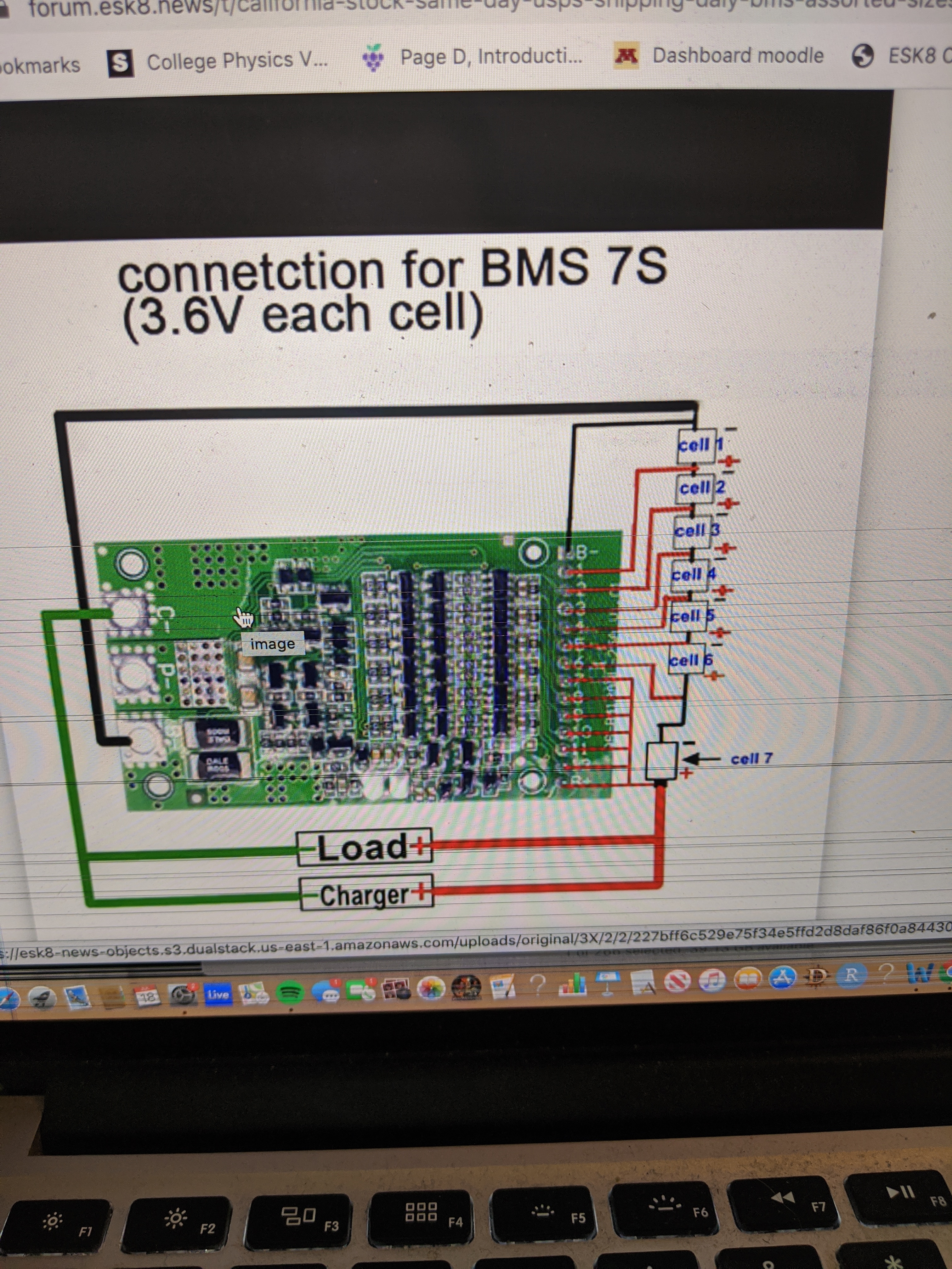

So I think I shorted my Daly BMS. Just got everything all finished, charge port and loop key and everything and went to plug in the BMS at the very end and got a spark near the end leads. I’m not readying any voltage through the XT connectors either. This is a 13s DALY BMS and I followed this diagram to wire it for 12s:
When checking the voltages through the balance plug, the voltages all check out for each group as they should, and the last two groups through the plug both read the pack voltage, which is 41.32V. Which makes sense because both my last 2 balance leads are soldered to the - of the last pack. Here’s my mess of a battery
Edit: sorry the photos don’t match the paragraphs well I’m using my phone here blahhh

Based on the wiring I should still get voltage of the pack through the XT connectors with the BMS unplugged if the connections are all good right?
I didn’t read all, sorry, but why do you measure „minus“ voltage? Maybe that’s your problem already?

I dont think the 13th lead should be on. If you’re wiring for 12S just wire for 12S.
Also, buy some black wire before you make a big polarity mistake
lol I just had the pos and neg probes switched around on the FLUKE. Thanks but that’s not gonna hurt anything
according to this and the diagram I think I solder the extra lead (13th) together with the 12th pack’s lead no?
what are you guys referring to here? I think all the wire colors are coordinated coorectly with polarity I was just reading the voltage with the probes swapped around
