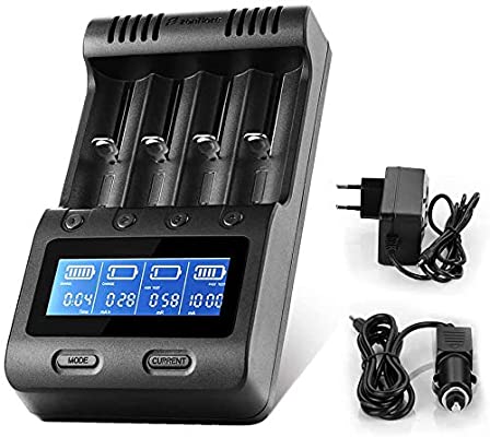

which charger is that?
It’s a cheep C4 amazonian charge capacity checker… I can look it up…
I like the different functions on this one… Especially the capacity function and internal resistance checker…
So far I’m pretty happy with the cells… But sometime tomorrow I’ll know the cell capacity
Das sum fancy pantz shittttt…

IR checker? I thought you had to have a fancy pants device for that. I want that.
looks like maybe this:

Yup that’s the exact one I have… There are others similar… Mine doesn’t say compatable with 21700 size… But you can see it fits quite dandy!
If that’s the one I am thinking over it slightly overlooks the cell’s voltage ex: Cell is 4.15 but is seen as 4.2

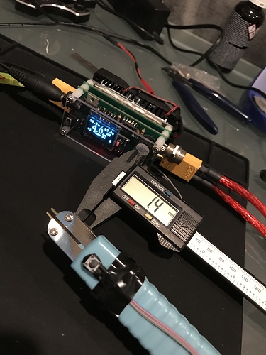

This spot welder is starting to drive me crazy. Keeps blowing holes every 3rd weld or so. I thought it was the stock pen so I got the sunkko pen and it’s still having the same issue. I make sure to lightly sand the tips before use.
Anyone else who’s used this pen have any suggestions? How far should I be gapping these tips?

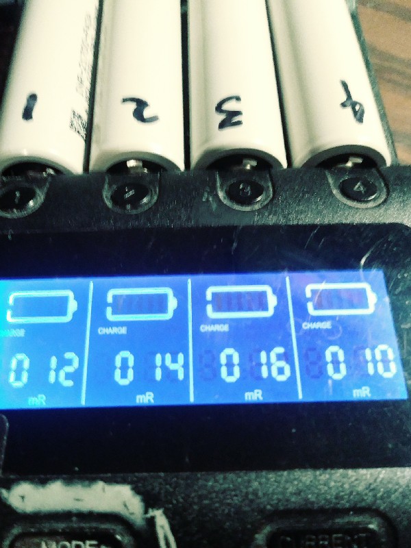

thanks, but I’m not actually charging the cells, except the NOR test, I’m looking for magnitudes of differences not subtle 0.05V differances, as long as the measurements are consistent, like I said above… I’ll bring out the high quality tools to do a sanity check.
I checked voltages, and IR and marked them down on 50 some-odd cells in 10 minutes or so… qwick and easy with this tool…
and I’m now running a full capacity NOR test on a representative sample… I’ll run 4 cells, and If I see deviations I’m unhappy with I’ll run 4 more… etc… etc… till I get enough good cells to configure and weld up into a happi-happi joy-joy pack
