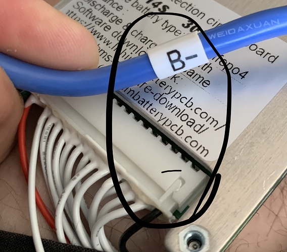

Quick question, where can I find a wiring diagram for the LLT bms’s?
Wondering about a few things with the balance wires that are different from my D140 that I would like ta figure out first
Didn’t they have one on their website? I haven’t wired mine yet but I feel like I saw it floating around somewhere
I went to the product page for this bms and they don’t seem to have it attached in any of their photos, or descriptions.
https://www.lithiumbatterypcb.com/product/12s-13s-14s-15s-36v-48v-58-8v-smart-bluetooth-bms-with-20a-to-60a-constant-discharge-current-with-uart-and-rs485-double-communication/
I get how to wire most of it up, but I’m worried that I will make a silly mistake if say; they want the balance leads 1->14 wired a specific way that may be different than my d140. Not looking to blow another bms.
well the red wire and the black wire prolly indicate something wouldn’t you think? and just to back check you could run a continuity check between the B- and the black wire pin…
Yes I know they obviously represent the negative and positive of the pack. I’m wondering about the cells order. Do they lead from the negative on the right? Or is the cell order start from the left? I would assume that they start from the negative, and that It is quite obvious, but I’m here to check and pussyfoot around this bms as to not asshat it into oblivion.
It’s hard to look at someone’s kapton and fishpaper rapped battery and try to guess their wiring when you cannot find a diagram.

mine… with a different sticker… lists B0 matching up with black negative wire… and I just checked… on the one I have there is no continuity between B0 and B- hope this helps

Black is negative then 1to 12th
B- battery minus
P- output / charge if single port
C- charge

Thx gang, I’ll get to soldering it up then!
they’re pretty much all wired the same way. (basically, what @Acido and @kook been sayin, lol)
