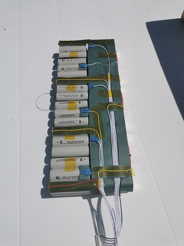

Built a few packs:
2x 10s2p Sanyo 20700b for @City-Blade-101 for his Onan X1 4WD
i did use the original bms again
Pics
8S4p Samsung 30q for my HB83
60A smart bms
Pics
12s3p rebuild with 30q cells
  • originally badly built by eskating.eu
  • did a complete capacity test on all cells and rewrapped damaged ones
  • then i did the complete rebuild
Pics
not grossly terrible except for the 47thousand pik post…
Fixed it
i lub you long time
Yeah, the build quality is very good.
@Simeon is the one to build your batteries if you dont want to DIY.
Good work, bro.
peace
