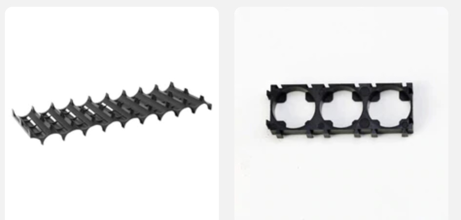

If I can 3d print cell holders. Is this a good idea to make use of? I don’t see it used a lot for esk8. I do see a lot of the powerwall grid layout builds usign them and sometimes ebikes.
but even for a 12s2p I’m inclined to make holders for those pairs to add a bit more structure. but should I?
You mean like NESE and WinFly modules…?
The main reason people don’t use them is they take up extra space. They are a good option if you have the space for them and they are a good fit and well secured
Been there, done that. It sucks, at least the way I did it. Should’ve just bought the injection molded puzzle-piece ones instead of printing my own.
As jigs, they’re fantastic for aligning cells for welding or gluing or whatever though.
No not the compression style setups… I meant just cell holders/spacers.
I was originally just designing things to help me mock up a staggered stack. I’m not going this route now
but it made me realize I can still design a pretty space efficient casing. that might also provide protection and support for the fishpaper and bus bar on top of the pgroup.
interesting. what’s the way you did it? what sucked?
I recommend getting the spacers off AliExpress…they are like $10 for $10 and hold everything nice and pretty
