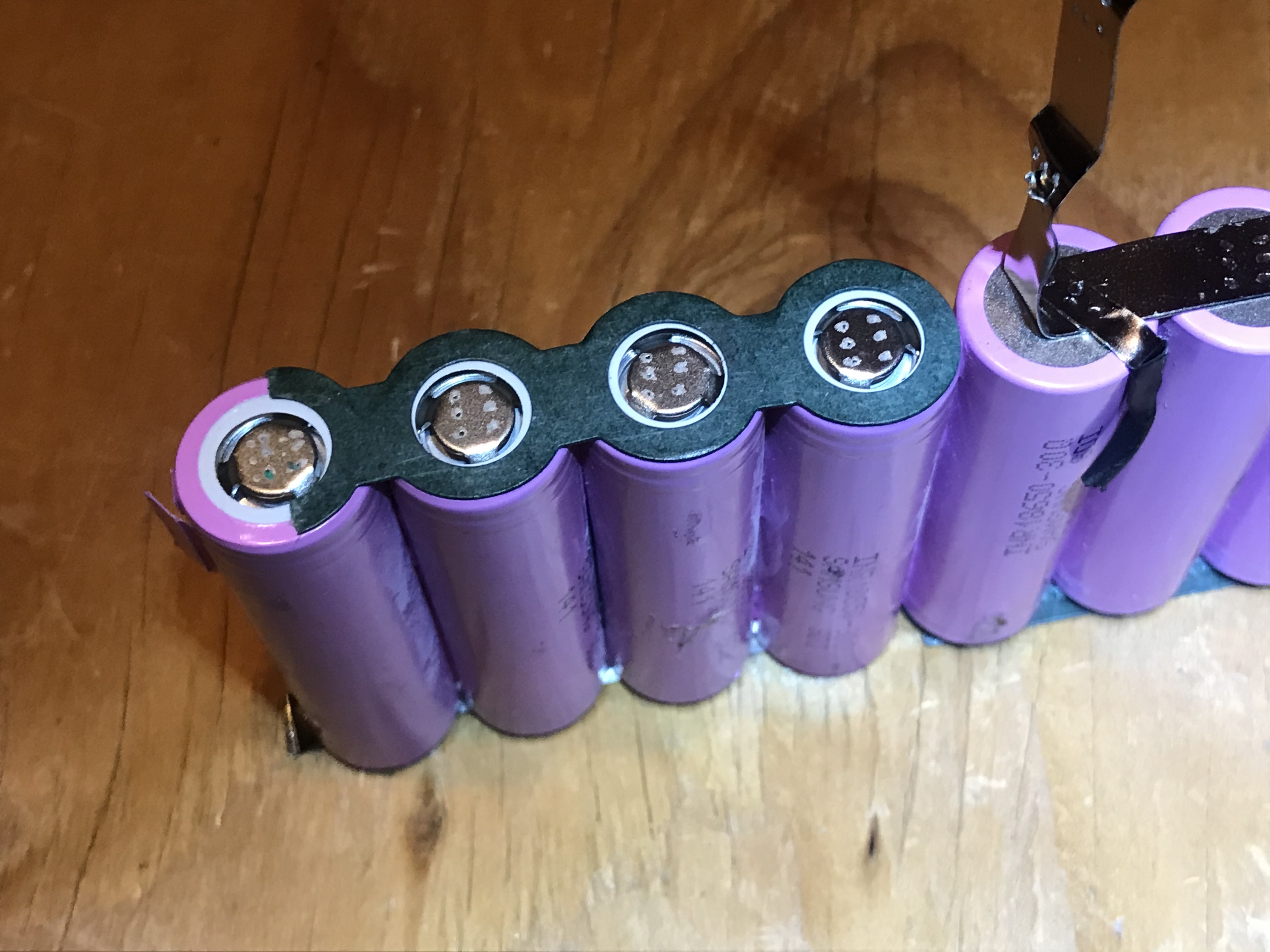

I think @Linny just did a pack with this method no? Is it sound?

Braid when done right I’m sure is sound. This pack only had it on half the series connections. So what’s the point?

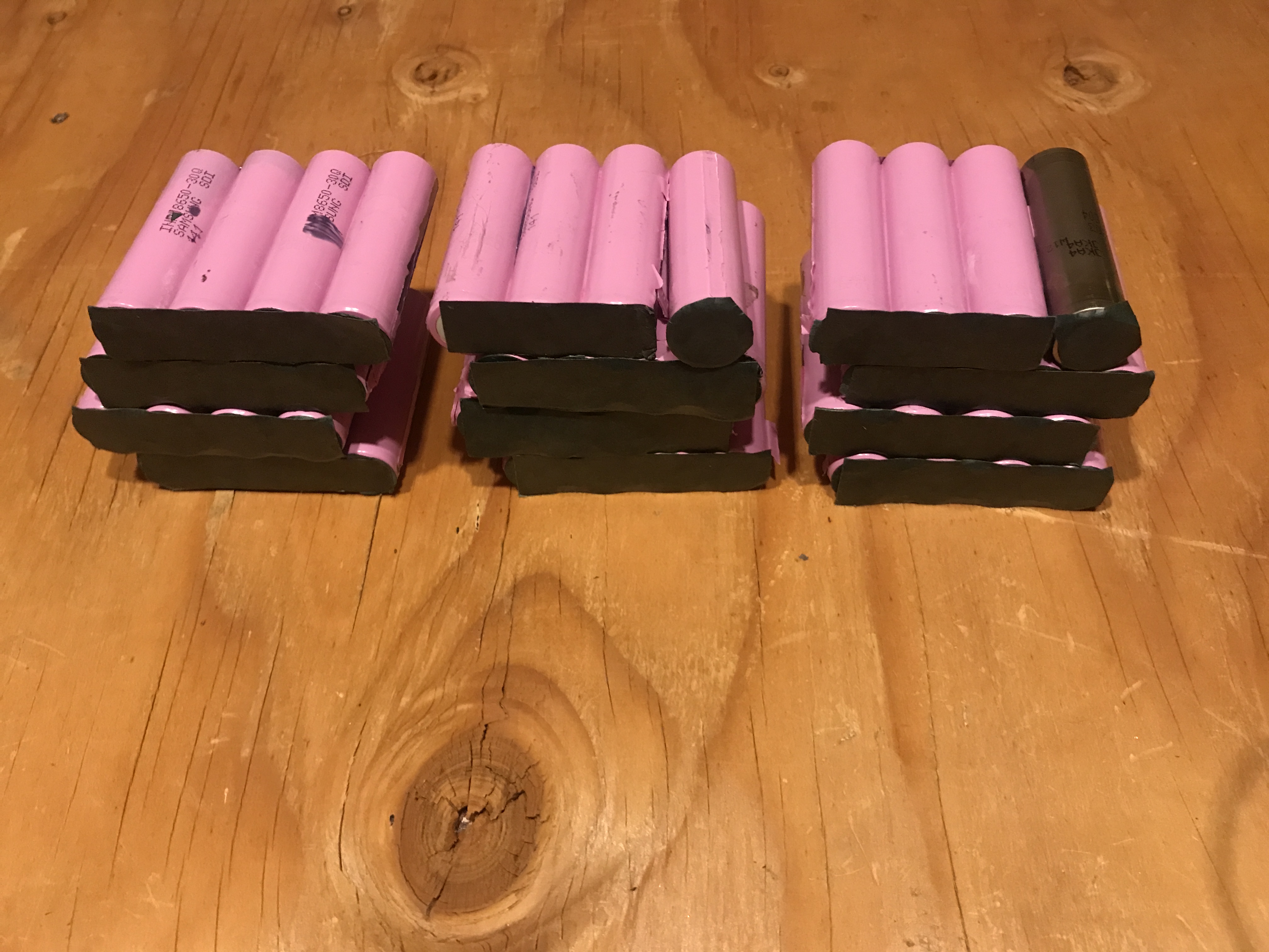

Welds on the positive terminals are all coming off clean.
On the neg sides though. It’s tearing apart and not coming off.
Yep, i used the braided wire for my series connections. I didn’t do any crazy stress test with it but i did pull really hard on my test solder on some scratched up nickel. No problems.

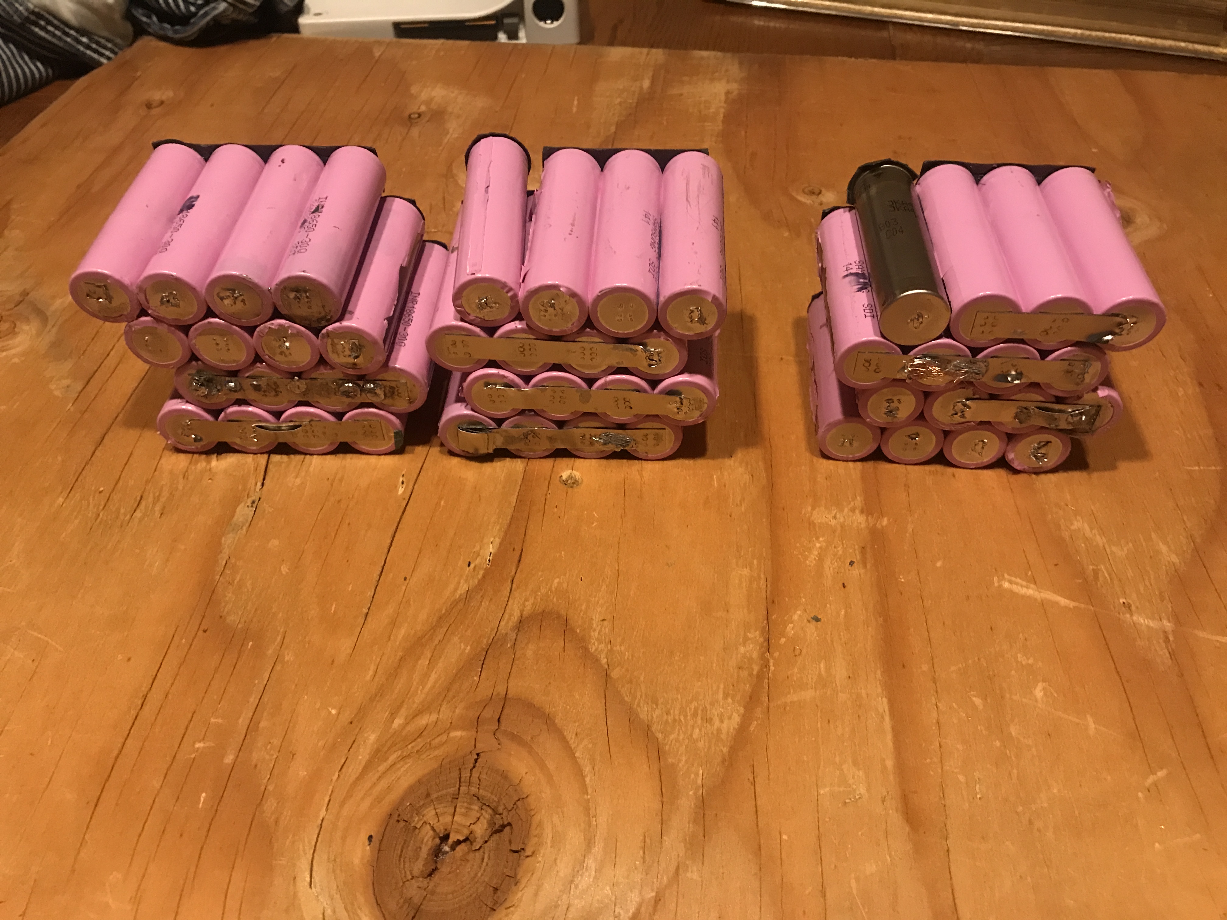

weld look weak on positives… prolly better welds on negative… maybe vents… for some random reason… have you done a cell voltage test, or is this one just dUUne?
I didn’t write it down but the I think P groups were all 4.05v except 1 which was 3.9x Cells might all be salvageable.
I got this far. Positive sides no nickel. Covered up again.
Negative still more work to do.

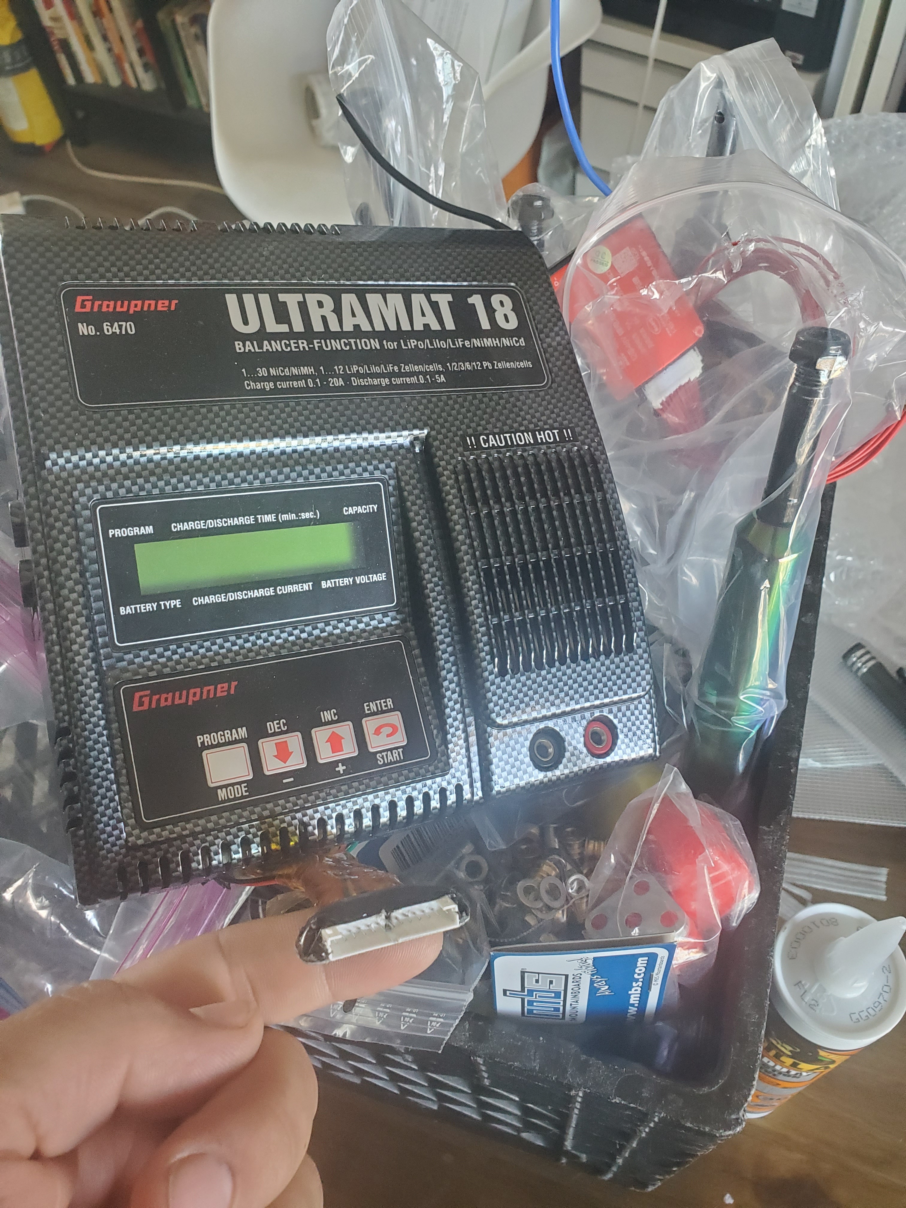

There was questions about good 12s balance chargers.
This with a jumper internally and my own just connection ( was 2 separate 6s before) kicks ass at charging. It’s only limited by the 300 watt ac/DC switching power supply inside but has dc 12 volt banana plugs if you have a meanwell or some other power supply. Works also as a non balance charger. Gives live cell by cell readouts and mAh in . And has discharge
