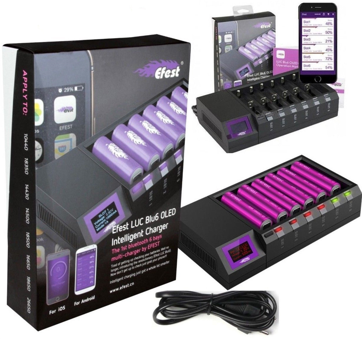

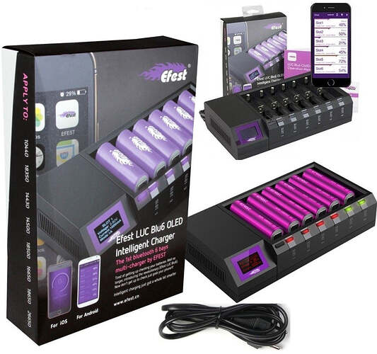

SO, tell me if this is ok:
this is the charger I’m using:
The voltages above are what I got after the charger claims they’re fully charged (just shy of 4.2V as you can see).
Is it safe to build the pack with them like this?? As in, this charged, or do i need to discharge them to 3.7?
that’s close; how much am I gonna fuck my pack if they’re .03 difference?
Whats the voltage of the rest of the pack?
Have you had any incidents happen before while you built packs?

so I’m building the pack with salvaged cells that are all around 2.6V. So I’m charging them to 4.2(ish) because this charger I have doesn’t allow me to adjust the voltage I want to charge to. It just charges to what it thinks is full (which you can see from the image above is CLOSE to 4.2 but not quite). I’m gonna wait a couple weeks to make sure the cells hold the voltages, but I wanted to check ahead of time rn to make sure that it’s safe to build a pack with the voltages I got above, So asssuming the cells hold the voltages, I plan on just charging all the cells to this 4.2-ish V, just wanted to make sure that’s gonna be ok.
I’m totally noob and the last pack (and only pack thus far)I built @iamasalmon did the welding p-groups for me so this part of the building process is new to me. =/

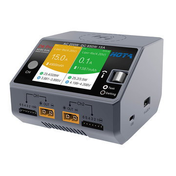

i have one of these:
https://www.skyrc.com/iMAX_B6_Charger
and one of these:
https://www.racedayquads.com/products/hota-d6-dual-channel-325w-15a-dc-battery-charger-w-wireless-cellphone-charging?variant=29230837760113&currency=USD&utm_medium=product_sync&utm_source=google&utm_content=sag_organic&utm_campaign=sag_organic&gclid=Cj0KCQjw0YD4BRD2ARIsAHwmKVkb2TpxdteFjNOVwYzmQjXwAPhRq5Hf6zUfy0pov4XmKAuh_T336MkaAlvXEALw_wcB
but I don’t see how these hobby chargers will balance cells without welding them and making a balance lead running off of them? Sorry I’m sort of confused on this process
I have one of these too:
are you saying just go ahead with welding the p-group and then balance with this later?

You could easily do that. Within the p-group those voltages are perfectly fine. They’ll put energy into each other and balance out to one voltage. The probably in P groups comes when you have more voltage difference than 0.1v or so because then the more charged cell dumps energy into the less charged cell, and if it has to dump too much it can spark or cause heating of the cell, which we don’t want.
If you were to put all of those cells in parallel right now, nothing would happen visually and they would just end up meeting somewhere inbetween all of their voltages. Once they are all one voltage, it’s basically just like it’s one big cell, and then after that when you put it in series, you’ll want to charge it up to very close to whatever the other series packs are at so the bms or balancer can balance the remaining 0.05 or 0.1v difference
