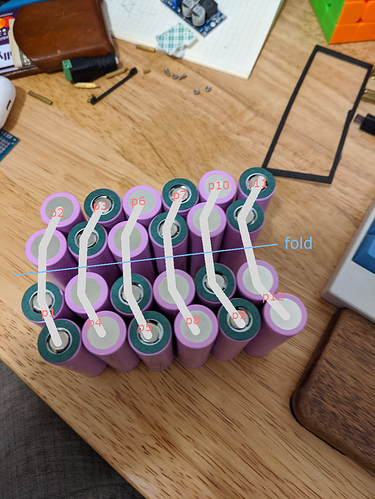

Does this configuration look good for a 12s2p? Any better ways of doing it?
use wire instead of folding?
Have you seen how people isolate P-groups from vibration, it’s a good idea.
Ask some builders with long hair about fixing a lot of batteries with folded nickel.
Thanks for the warning, I want to do whatever is safest.

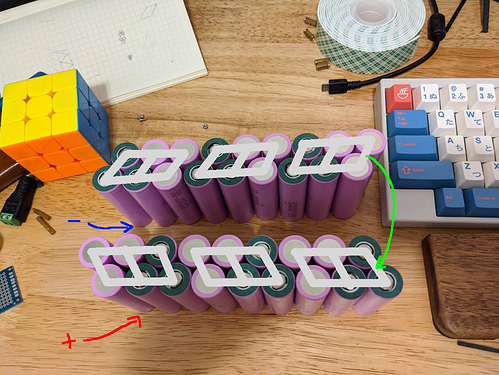

This is what I’m thinking now:
What’s a good way of connecting this two sides with wire in this configuration?
This two groups need to be flat side by side so it’s 2 rows high. (green arrow is where the wire would connect)
do you have fish paper to go between the cell walls where all the series connections happen?
if not the flimsy PVC wrap is protecting you from a battery short.

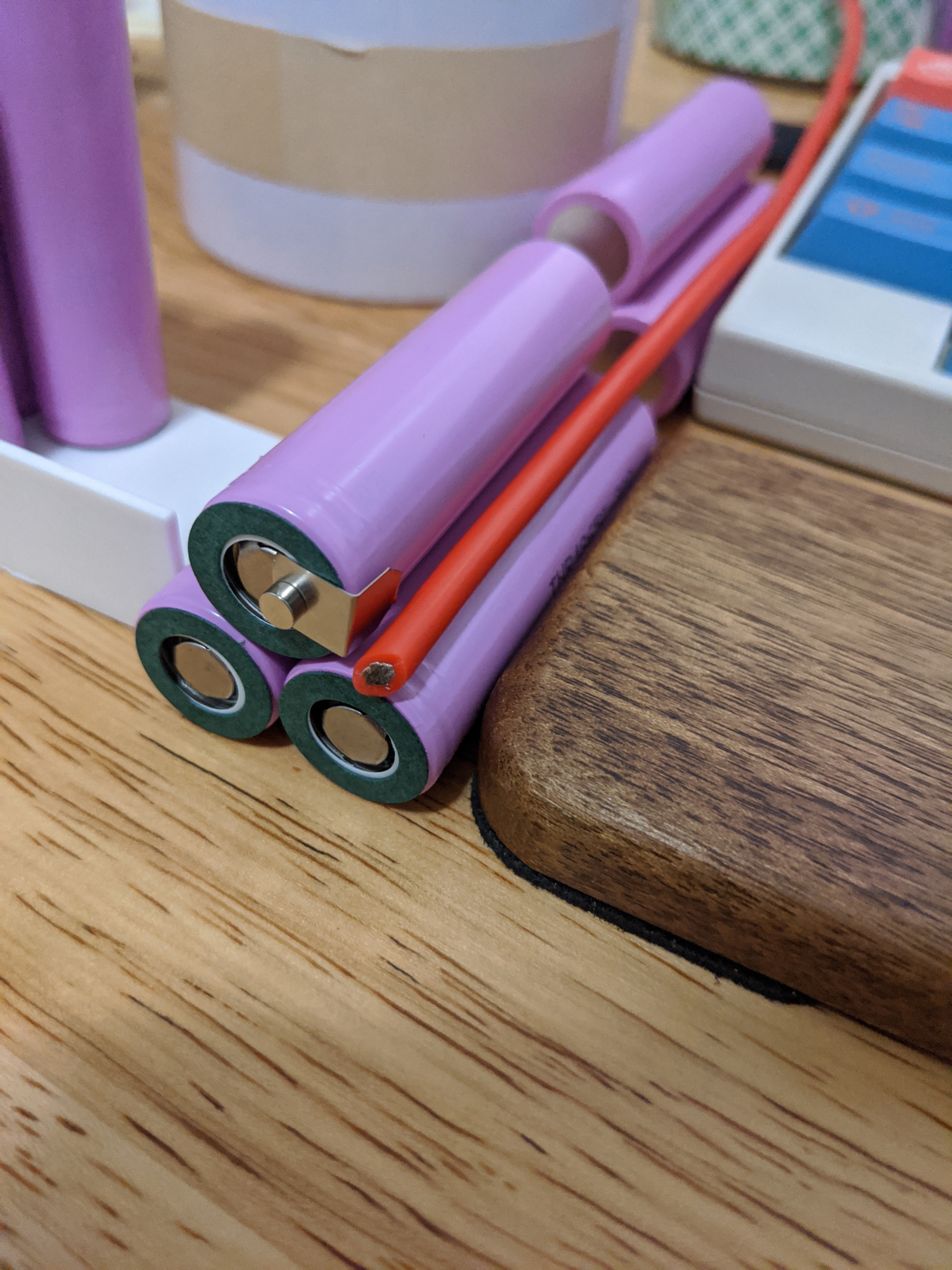

Yep, I would cover both sides series connections with it and separate all the p groups as well.
EDIT: maybe I can connect them like this? (with fish paper to isolate the positive strip from the side of the battery)

put the bent nickel on the negative end of the series connection, that way it can not short to anything.

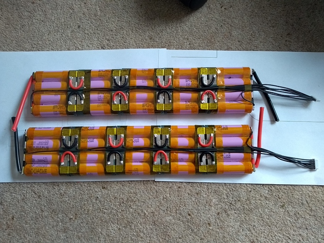

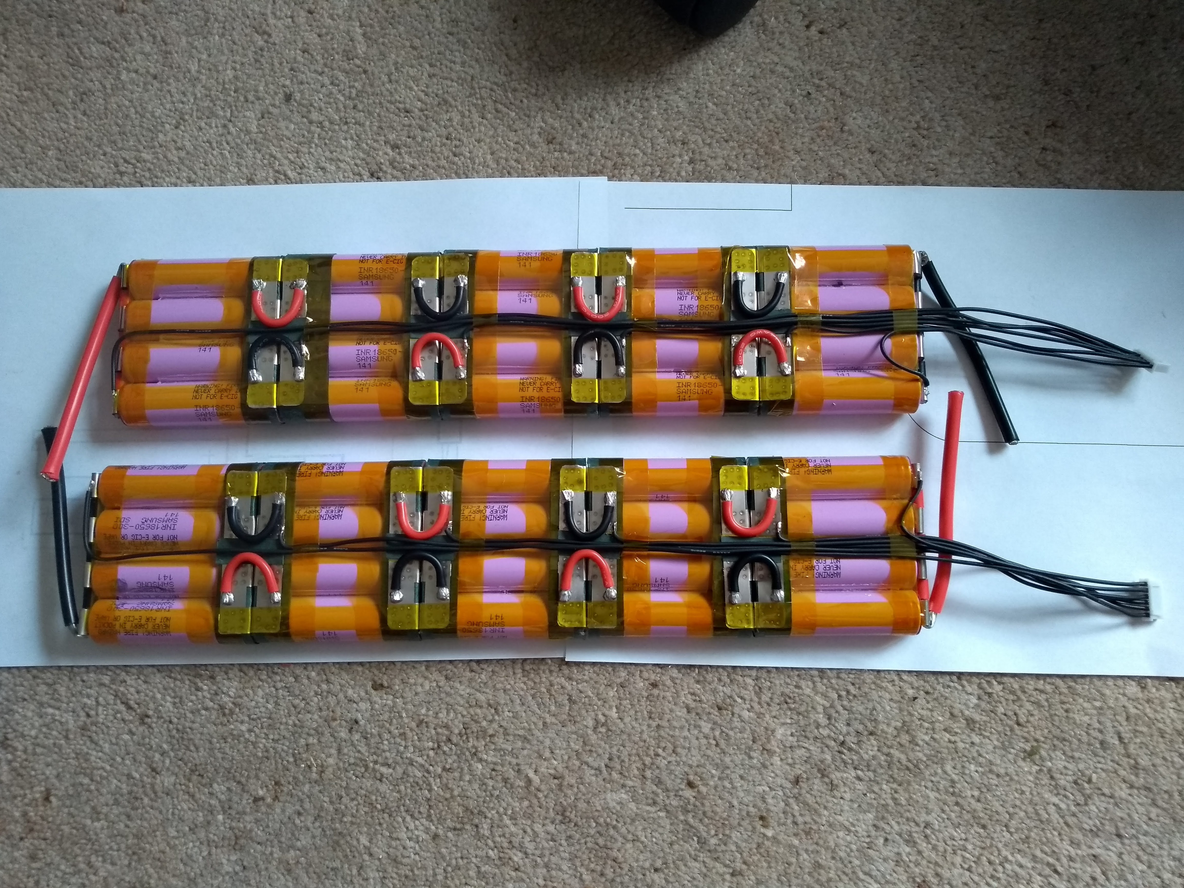

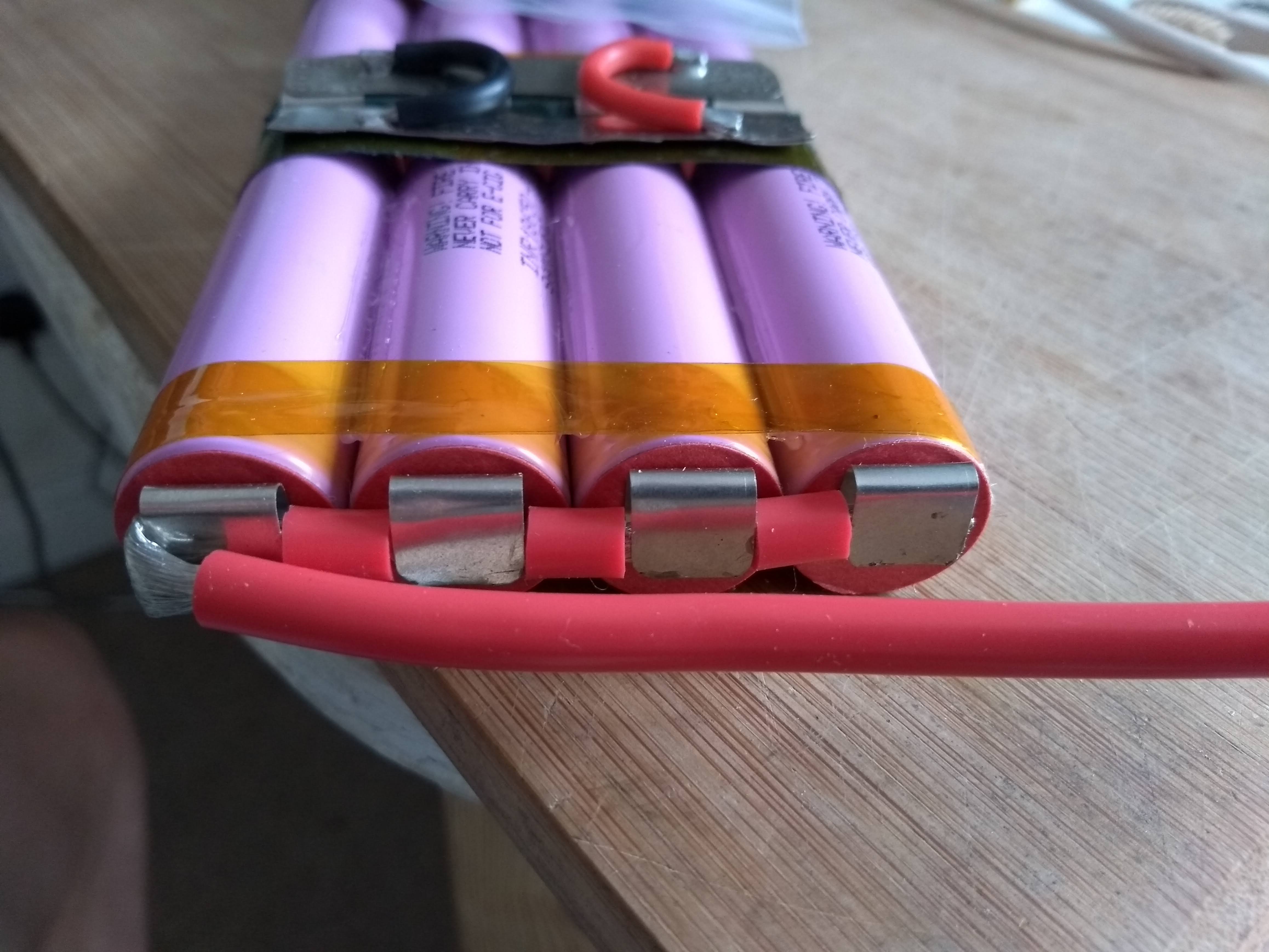

Any tips to improve this pack? Have I missed anything?
10s4p split for balance charging. Will be putting bullet connectors on the terminals and heatshrinking the whole thing. I’ve used 0.2 x 10mm nickel, 10AWG wire for the terminals and 14AWG wire for the series connections.
Thanks
Pack looks really clean and safe :ok_hand: only thing I can’t see if you did solder wire on nickel under those bent ends? I suppose you did.
Otherwise 5+
Only thing I can see is fish paper between the nickel and balance leads
I don’t think that’s problem since balance wires are silicone and more important than that, silicone wires for series connections will make sure there is no pressure on balance wire because they are thicker, so they will create some space height-wise.
I did solder behind the bent over nickel:
There is some fishpaper between the balance wire and the nickel tabs, it’s just hard to see. I will be stress relieving the terminal wires with tape or something.
This is my first build and have been through almost all the posts on this thread so I’m glad I got it right first time (other than shorting out a cell with a pair of pliers and having to replace a P-group)

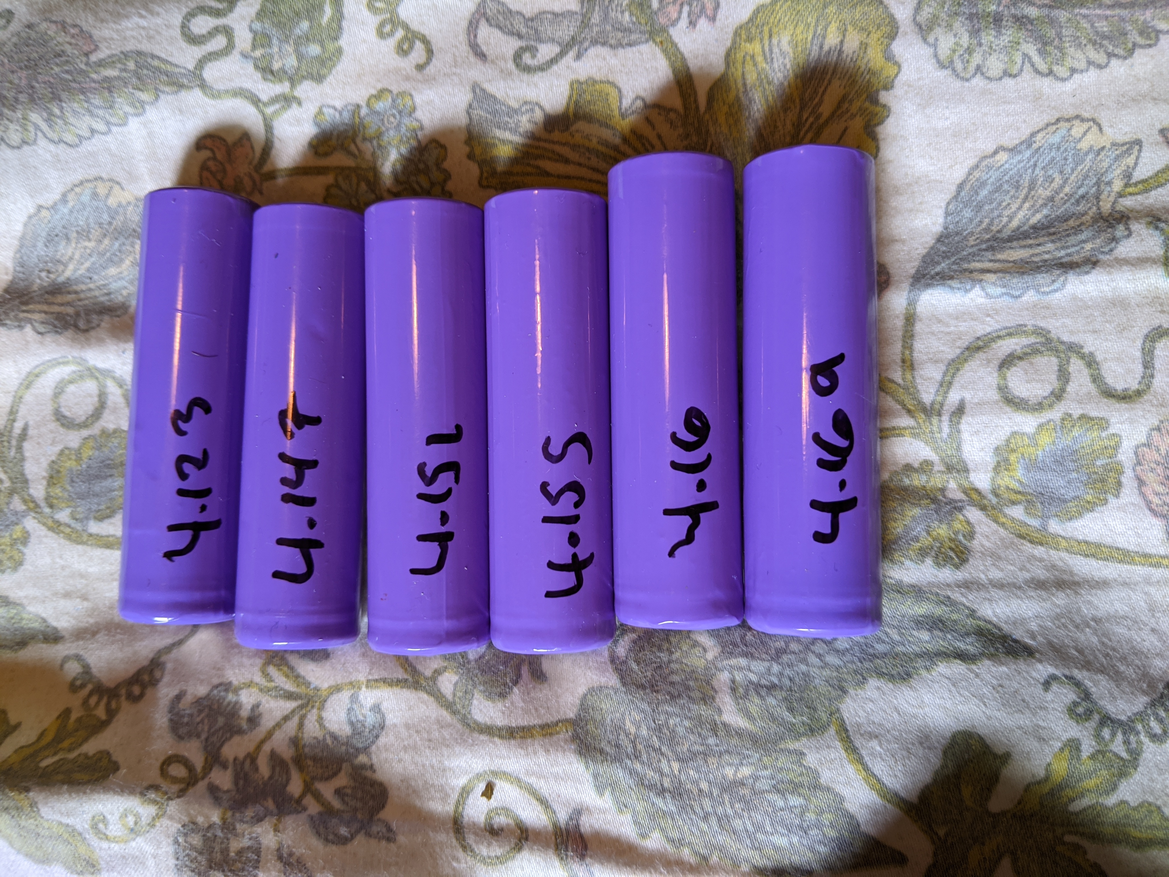

Ahhh ok so you chomp round the nickel edges after you weld them on? Was wondering about that. Also, I’ve charged my cells up with a littokala type charger, here’s the voltages:
Can I make a pack with my cells charged up like this or do they need to be at nominal V (3.7V)? Also, is this difference in voltages between the cells within a safe range to create a pack with? Thanks for all the pointers my friends!
just balance them all as close as you can.
then you can charge / discharge them to match the pack
