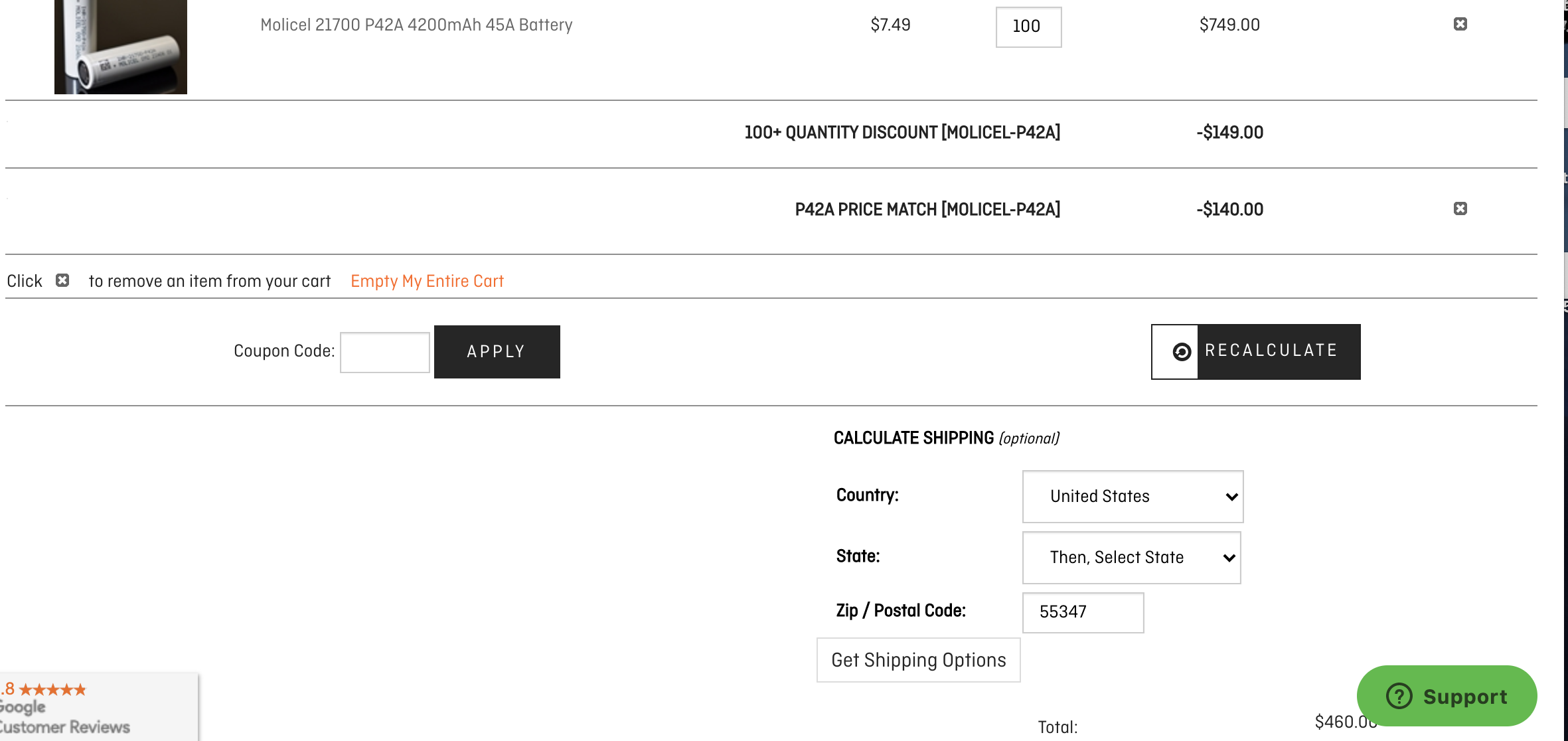

I got them from https://www.18650batterystore.com/21700-p/molicel-p42a.htm
They match liionwholesale prices if you ask them. I did and got a discount code on the same day. The code was liionp42a for Qty 50+ = Price of $5.10

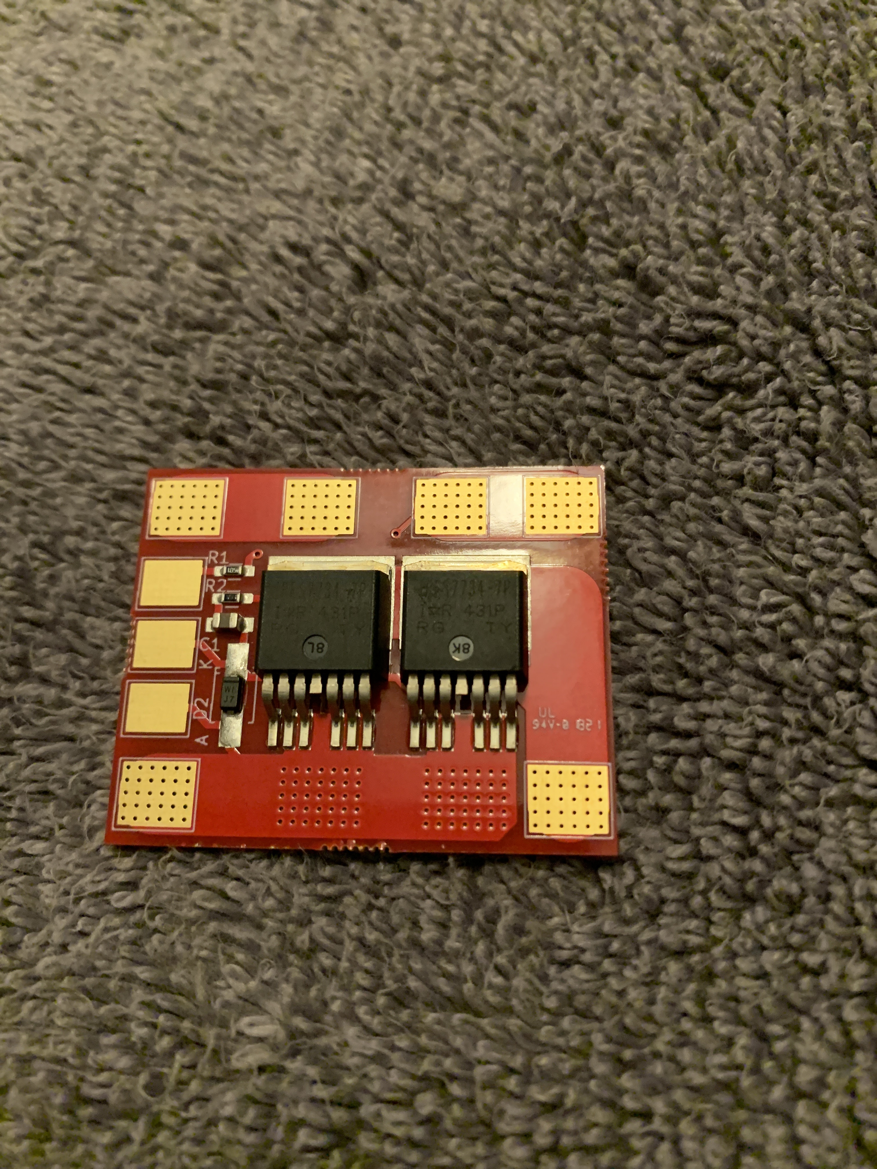

Anyone recognize this lil guy?

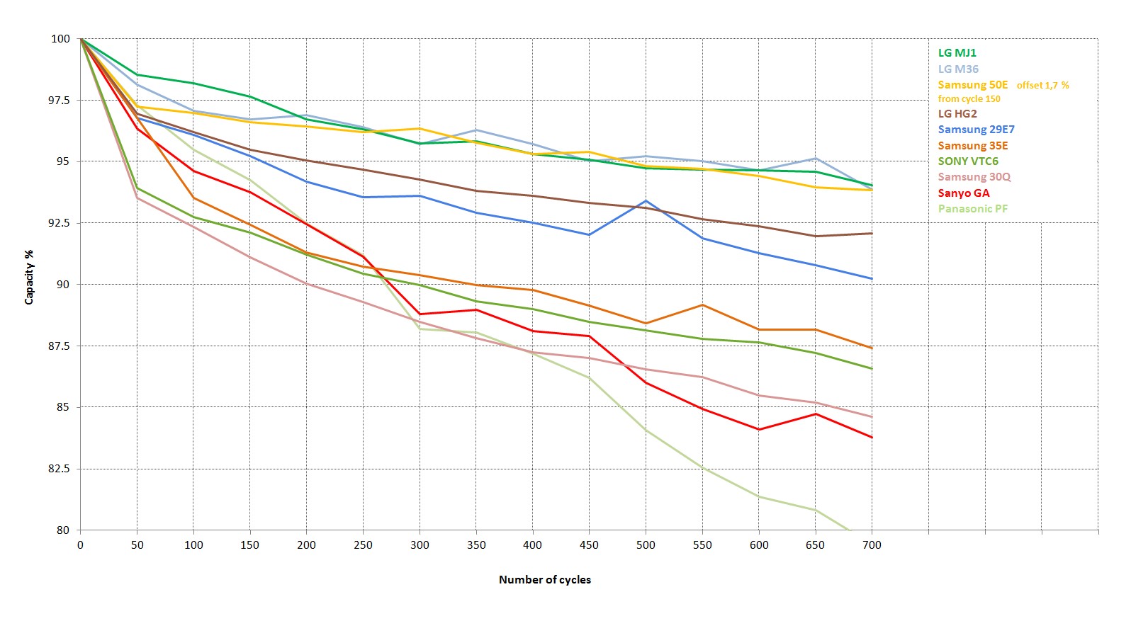

If anyone is interested on battery cycle testing I found this.
The test parameters are…
Charge to 4.1v @ 1amp
Discharge to 3.3v @ 2.5 amps
Although not exactly like use in an eskate, its the best test I could find and a little more real world than 100% DOD cycle testing you would normally find on a data sheet.
Full ES thread here.
That’s a helluva deal, $4.60/cell for 100. So tempted but I already have 150 40T’s I dunno what to do with :man_shrugging:
I’ll send the address of a safe place for those, lol

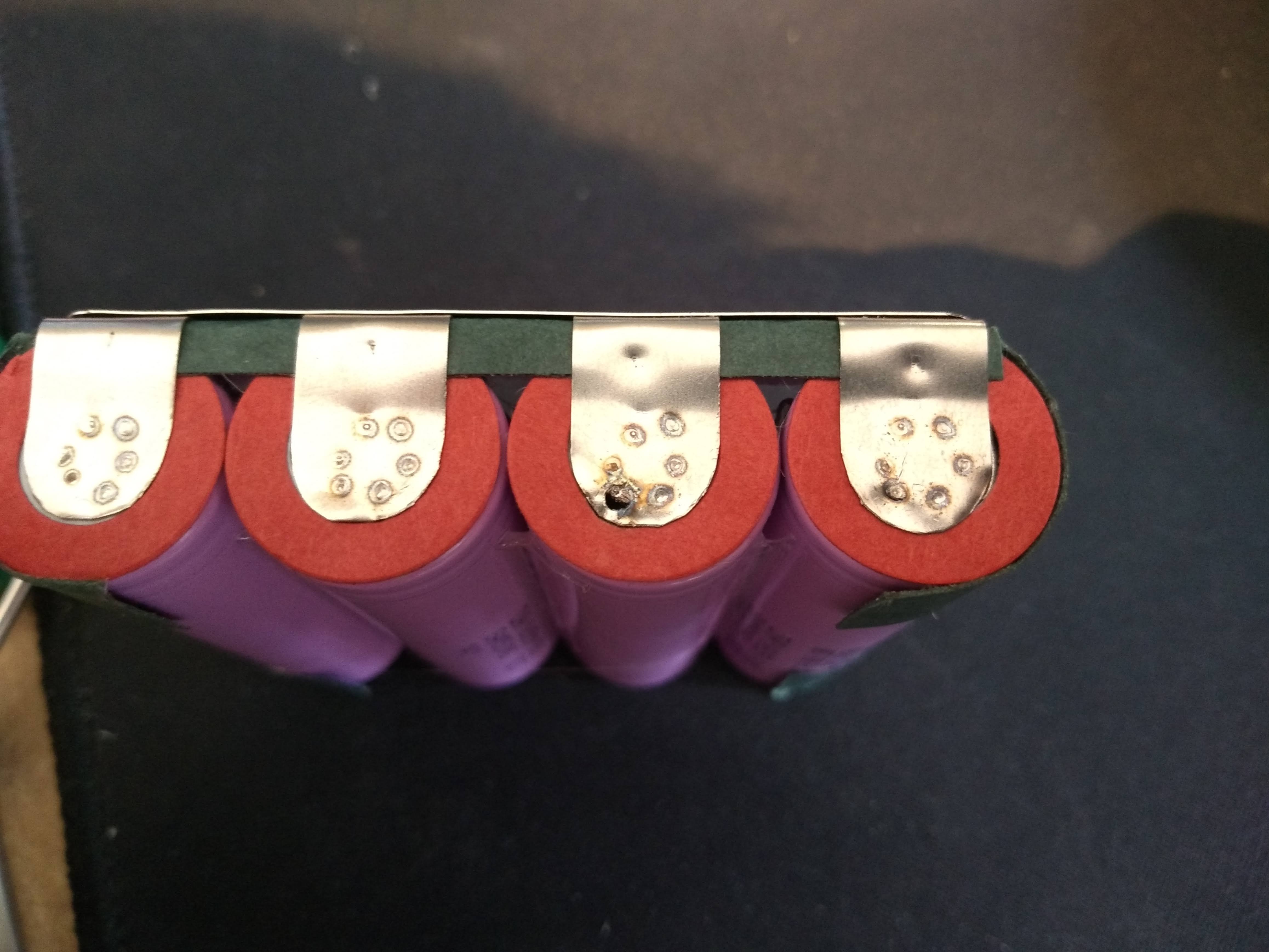

Is this a problem? I missed the anode by a little bit when spotwelding and blew through the nickel. I thought it would be fine because there is a gap between the anode and anything important underneath but I thought I should get a second opinion.
Did you measure it for me yet? :heart:
Totally fine as its on the positive end
Btw nickel does not need to cover up the whole space
I know, i probably should have left a gap so i could see the anode better but 10mm nickel strip fit quite snugly.
