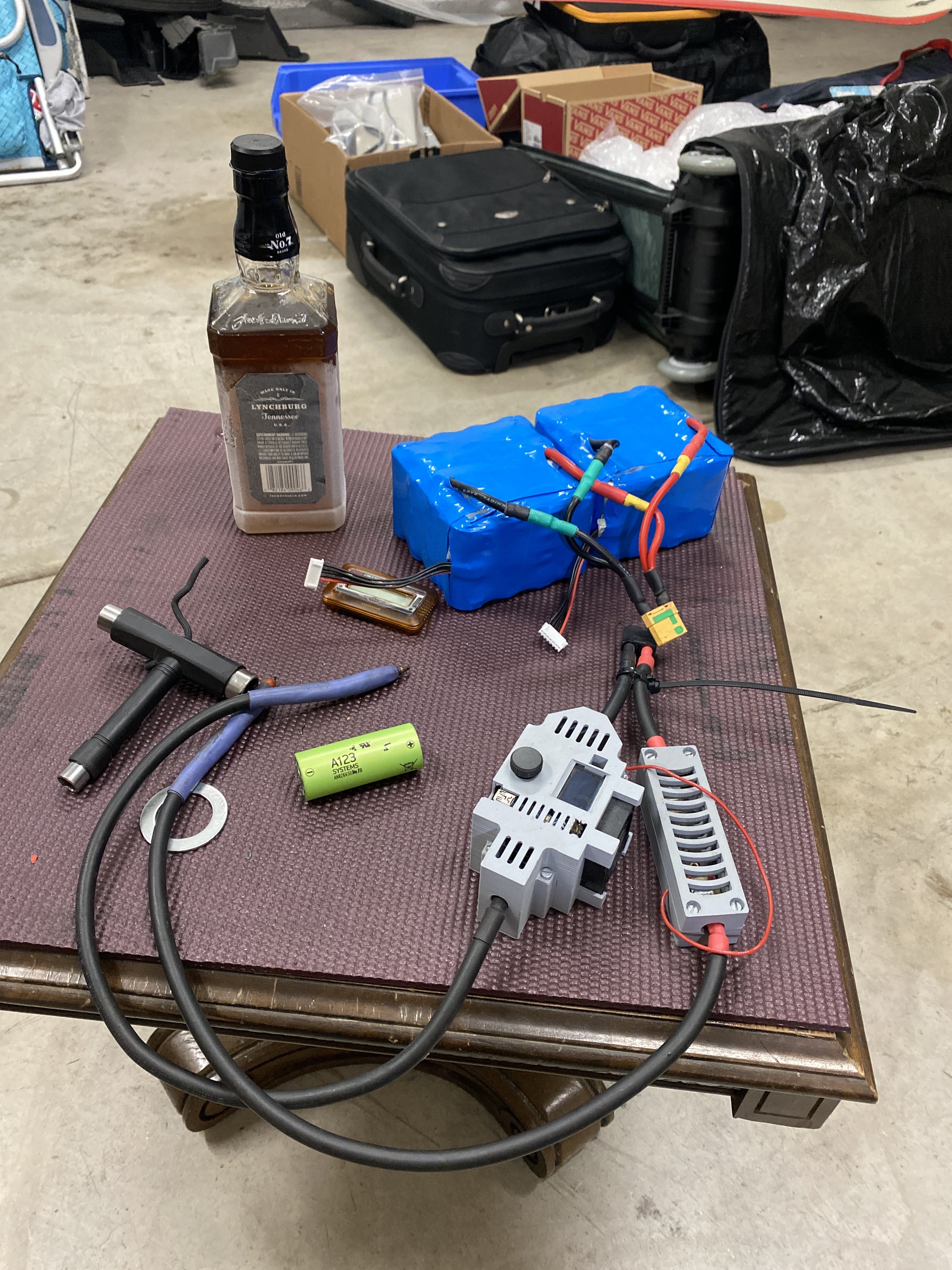

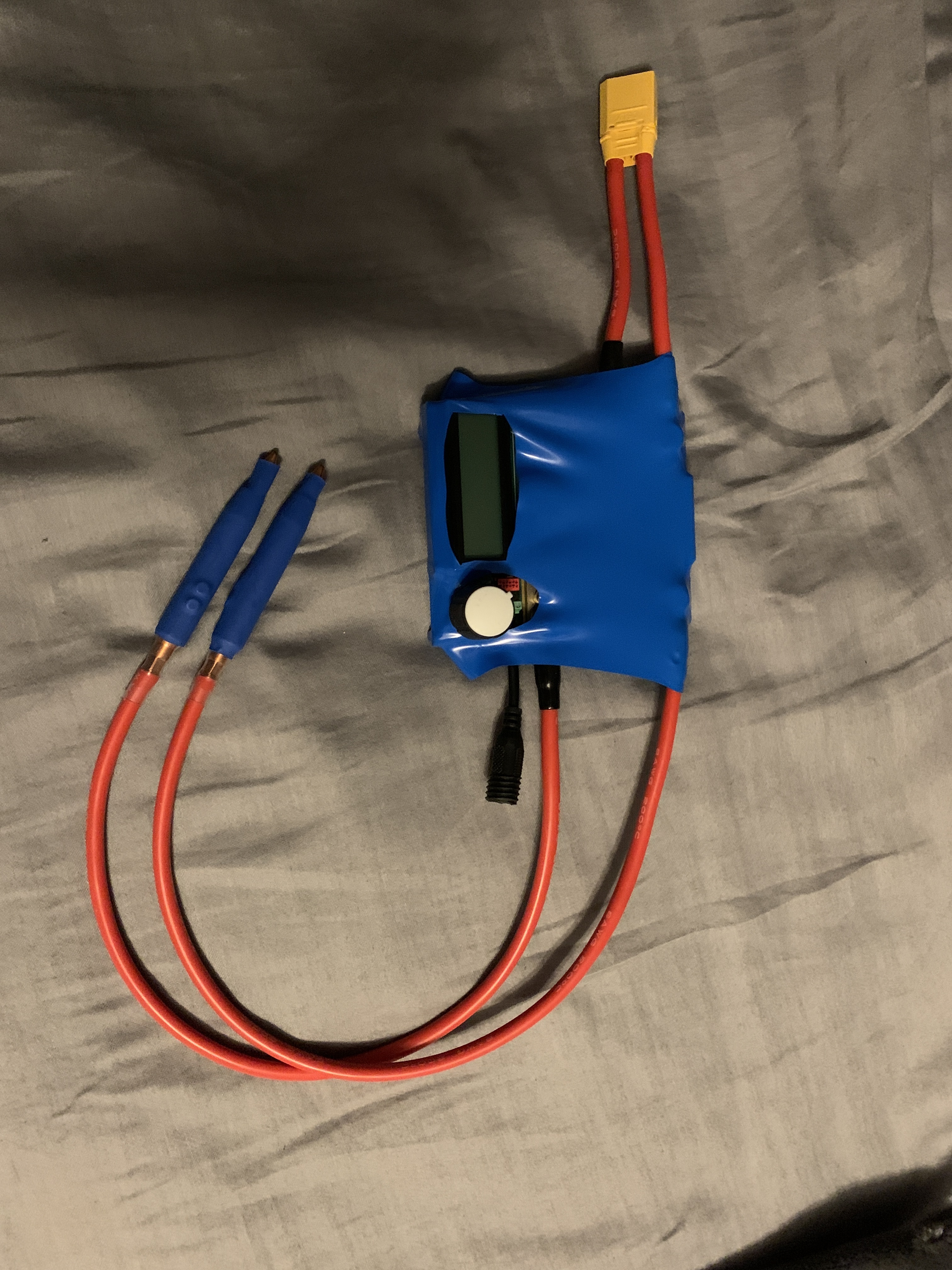

Rate my setup :joy:
Shrink wrap on the unit for zap resistance, shrink wrap on the pens for grip, 5.5x2.1 barrel for the foot pedal
seems fine honestly, I’ll prolly do the same withe the shrink wrap
smart, that thing already came out on me once
idk i forgot but it’s probably fine, it was a long list so i didn’t look at all the posts
are you the guy that asked for an enclosure?
Yup, there’s nothing wrong with the shrink wrap but it bothers me still
If you have a female port, I sent you an extra male end so you could do it too :yum:
At least I think I did…
There. I did it.
Damn, those probe wires are beef
