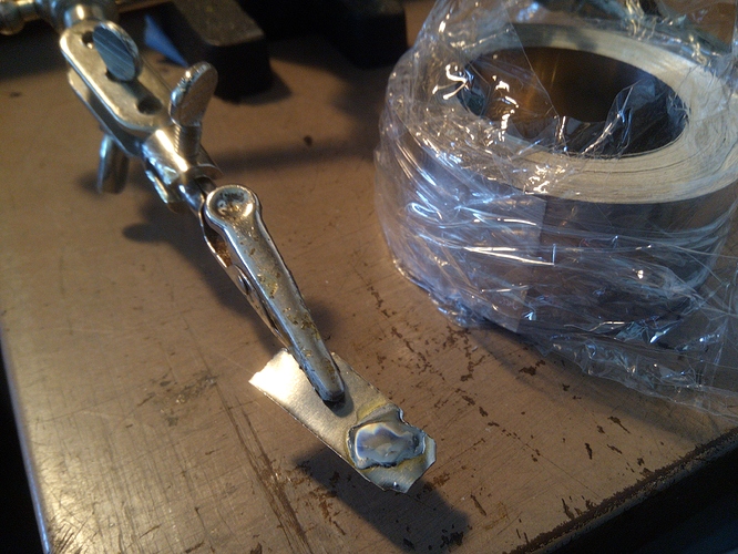

PSA: got me some legit nickel from Steel City Store on Ali Express. They have all different kinds and plated steel too so read carefully before buying. I got 30mm wide and 25mm wide. The 30mm x.2mm is particularly useful for them high amp cells
#Aliexpress US $24.50 30%OFF | 0.2mm * 30mm Pure Nickel Plate Strap Strip Sheets 99.96% pure nickel for Battery electrode electrode Spot Welding Machine
passed dremel spark test and soldering test.
