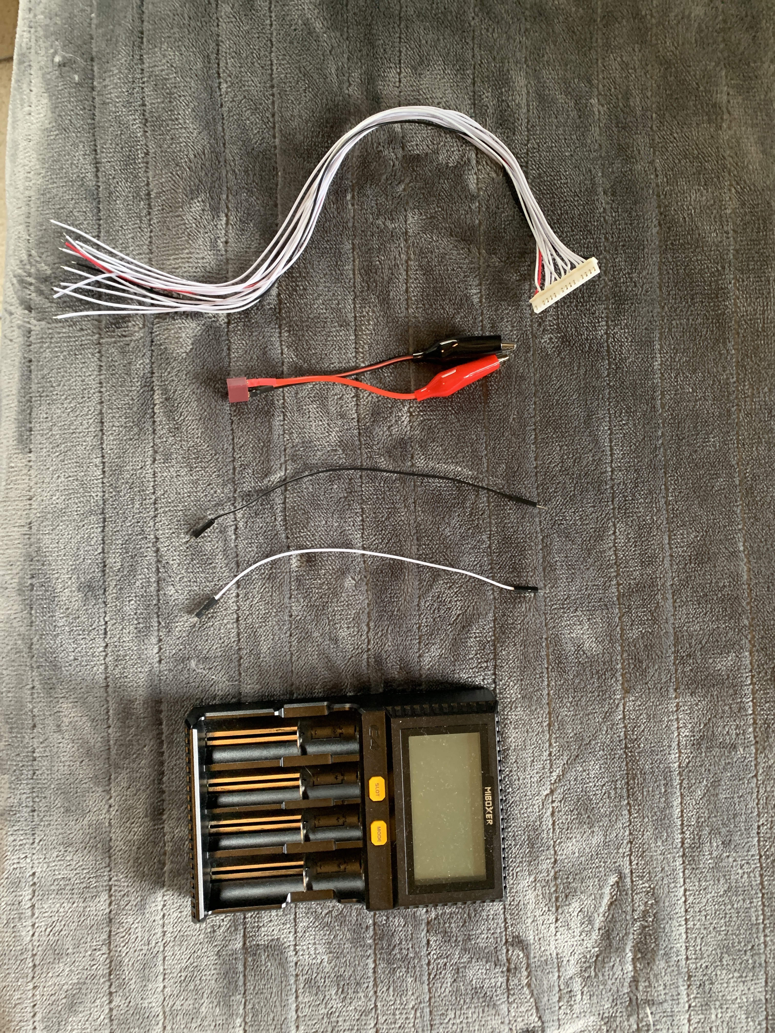

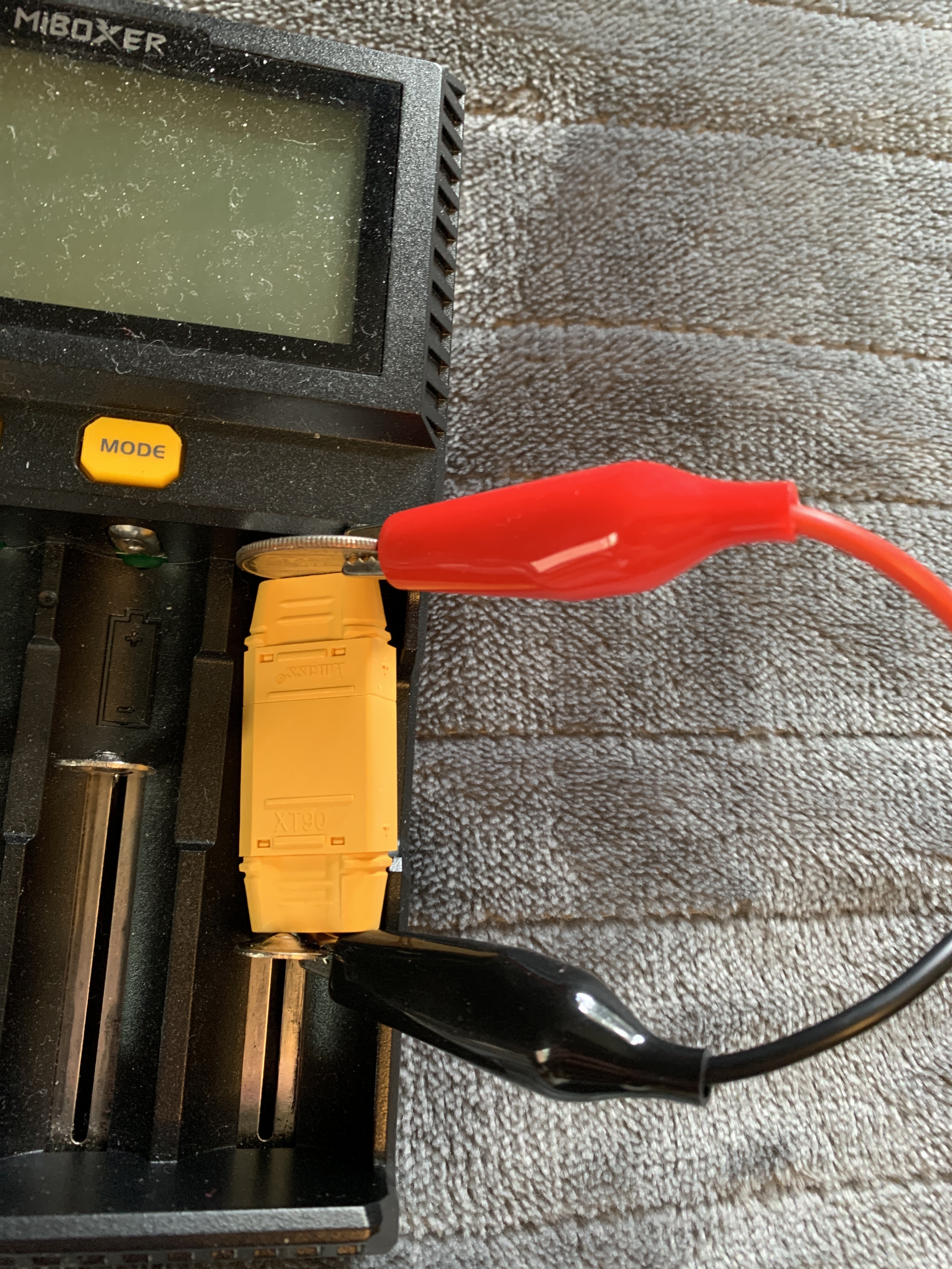

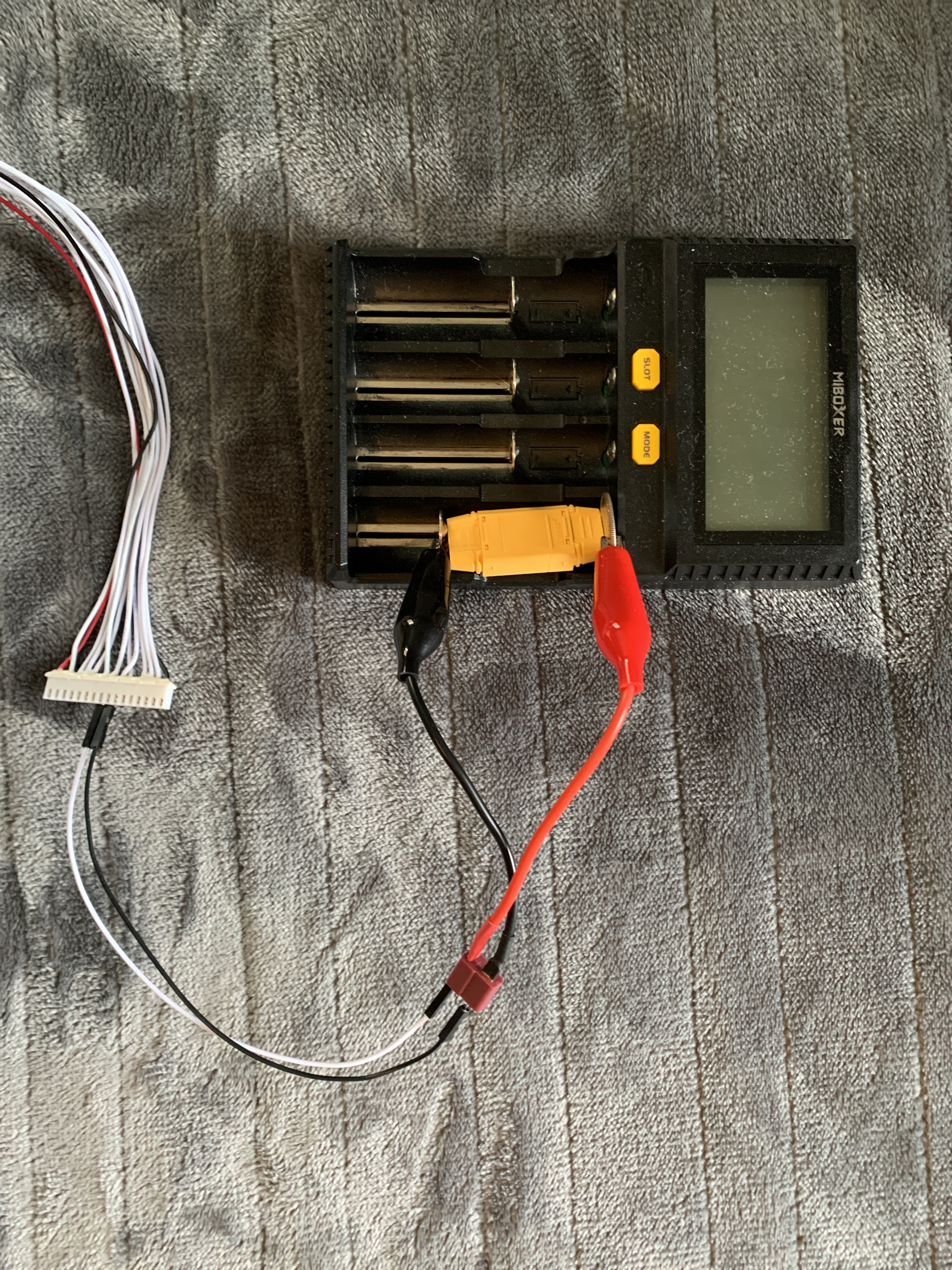

It’s sketchy as sin but I promise you this will work, make sure the charger is set to Li-Ion (4.20V) and like 1.00A or something small (it will balance better)
Only do one at a time, or you will be in trouble. It will try to get to full charge so watch it carefully
The XT90 is just a spacer, need to apply pressure on the quarter I am using to connect to positive :sweat_smile:
ahh ok, got it! I can use a hobby charger like b6max right? I got one of those lying around.
If the iMax B6 will do a 1s pack, you’re golden
It does. You have to be in ā€œcharge modeā€ not ā€œbalance modeā€ otherwise it will throw a ā€œbalance lead errorā€
I use my B6 all the time like this. :+1:

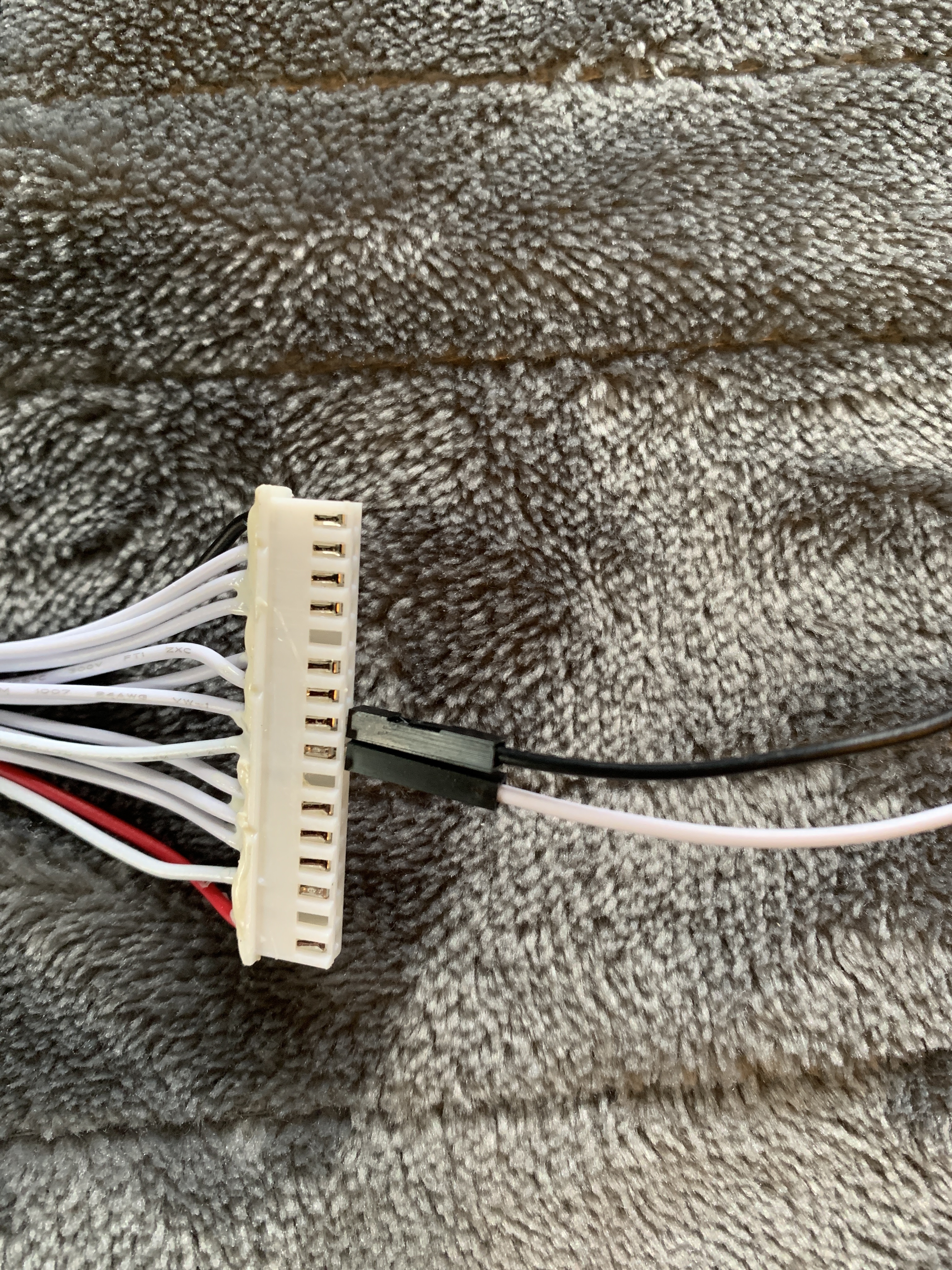

cool cool, very interesting. Thanks guys, gonna order those arduino cables and then we’ll see how goes :pray: :pray:

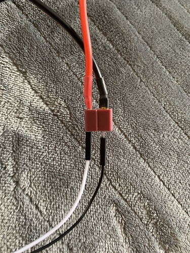

They have 3 types, M to F, F to F, and M to M…you want M to M
Amazon has a bunch of different packs of them, I got 40 of each so I could use them for a bunch of things (removable parallel packs)

yeah, you just use the main charge port, no balance connector.
Then navigate to the lipo or liion mode, then the ā€œchargeā€ mode (not balance charge) and choose 1s. It runs a test and gives you an confirmation message if you did it right.
