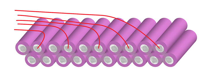

Hey guys, Im new to this battery building thing. I am currently getting a custom pack made but it made me think about how I could make my own for almost half the price. I did some research and I have some questions:
This is a diagram of half a 10s4p:
(it might be hard to see but the positives are on the top) Those red wires are from the BMS and the cells are in groups of 4
Does nickel go on both sides of those cells? or just the front side like shown here?

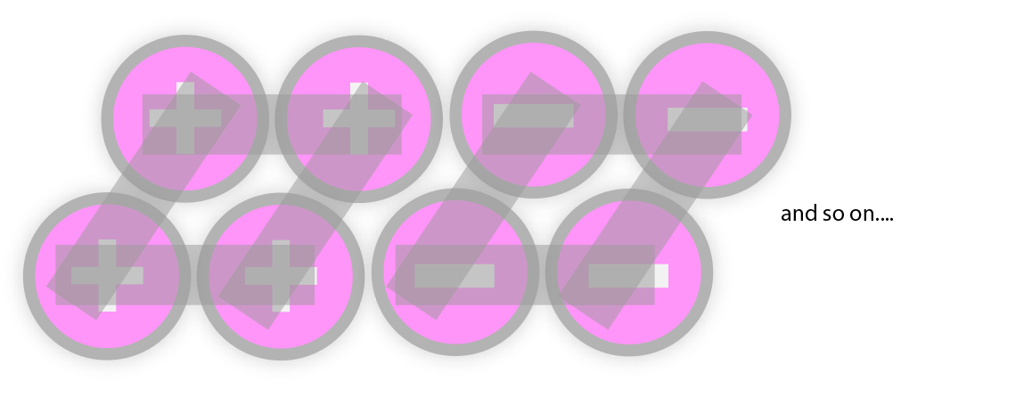

wdym the positives are on the top, the 4p connection should have all the positives facing the same way

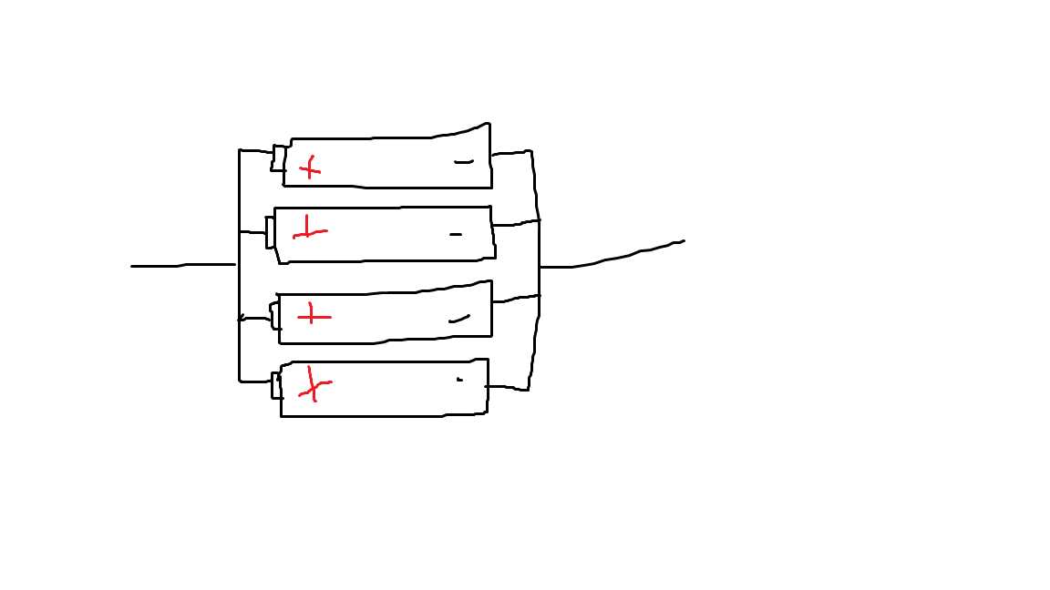

So those groups of 4 should have all the positives facing the same way? What about the group next to it? Should it alternate? I can make a diagram hold on
yes and these p groups should be connected but not on the other side
ah ok, but if you have just the negative side connected (with nickel) will it still discharge the same as the group with only the positive sides connected? Sorry for my questions
idk just mak a diagram and follow it xd i’m not the best
i know how to do it but i can’t rlly explain

show the other side please? That looks correct for a 10s2p so far
If I was you I would do the 2x2 blocks facing the same way, it is much easier to connect 2x 5s4p than 2x 10s2p
