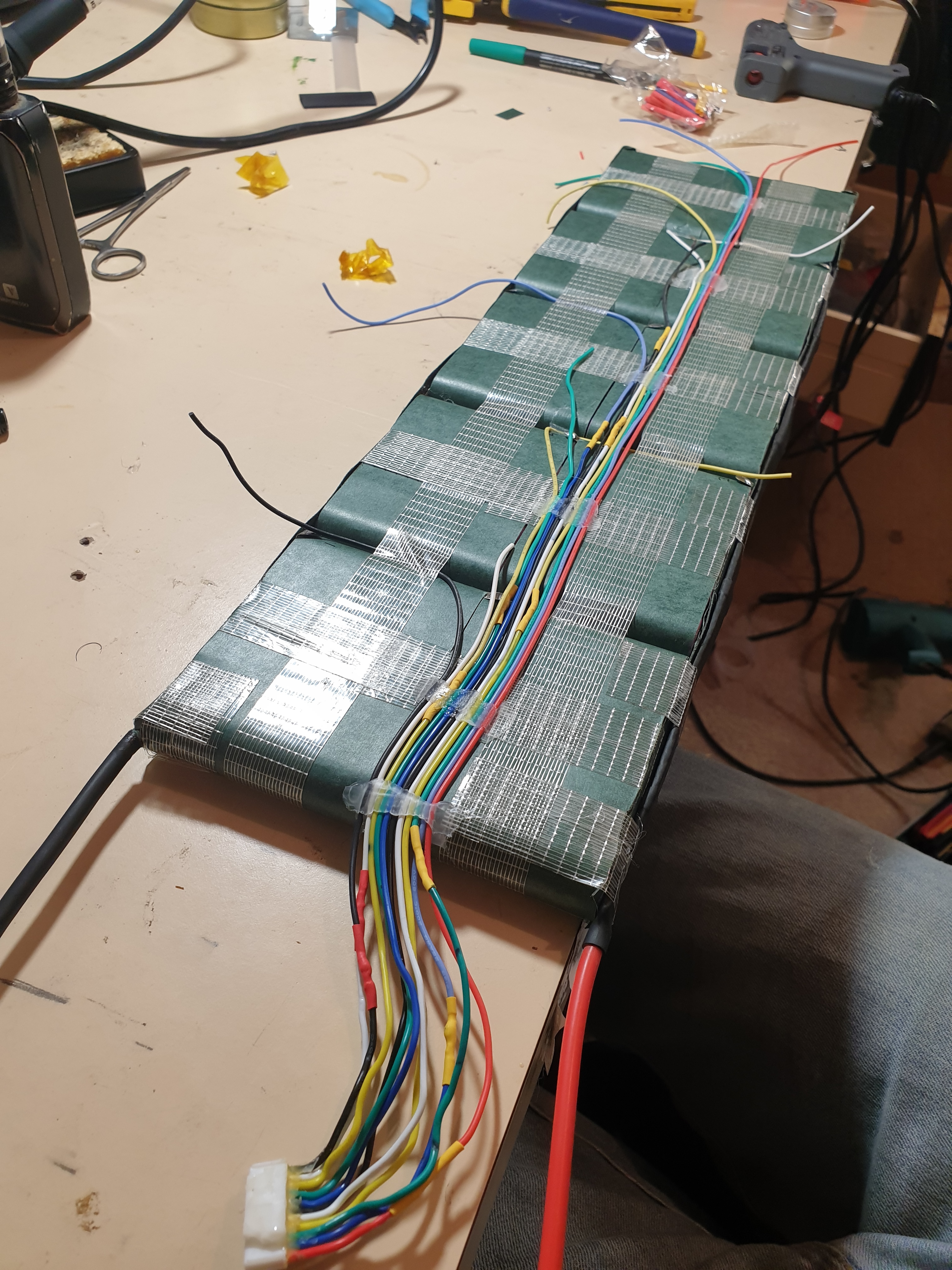

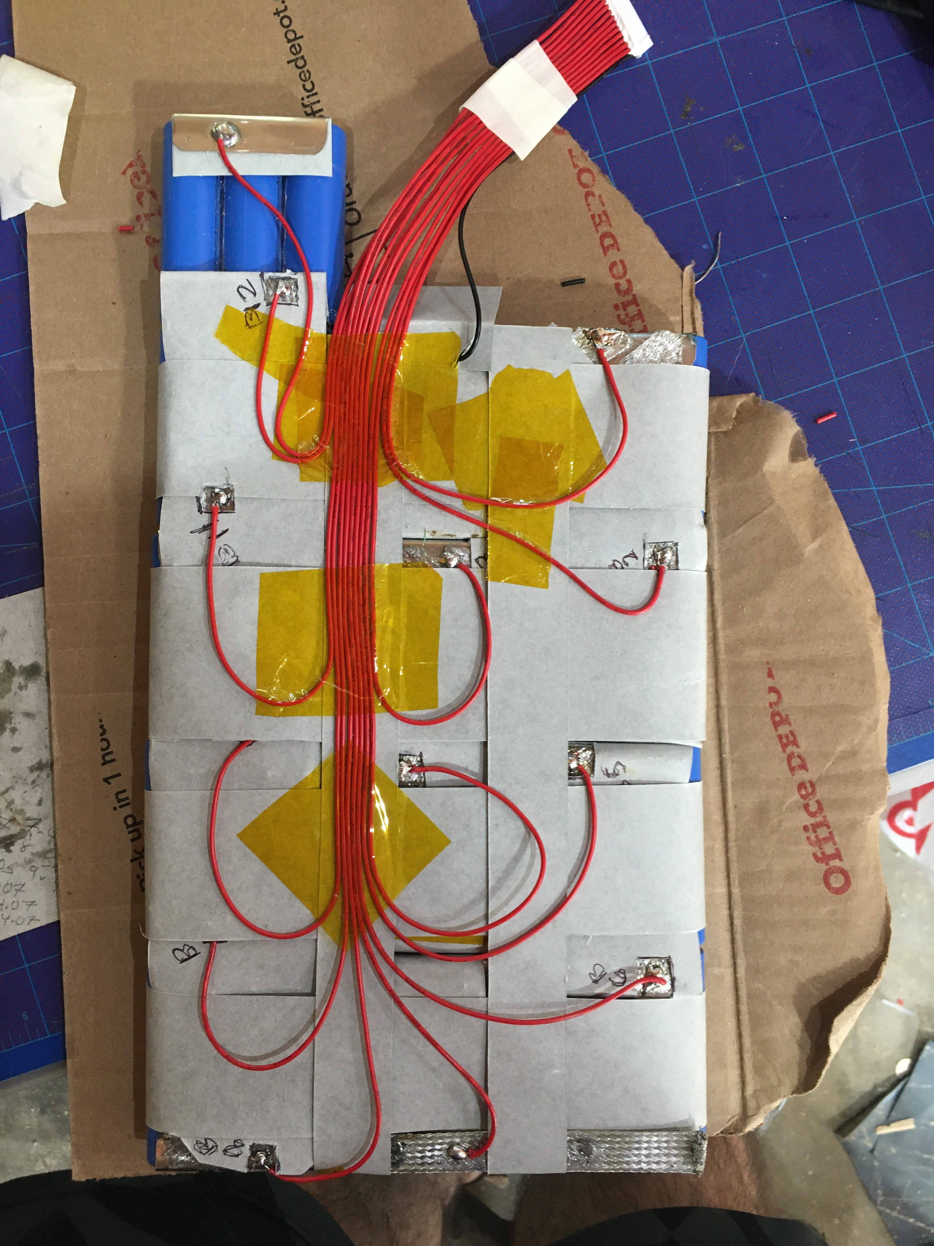

Hot tip: organise the balance leads before you solder them.
I use hot glue under and over the balance wires, a bit of spit on your thumb to squash it down and cool it quickly
:rofl: :rofl: I knoww man, I learned the hard way.
I’d just desolder and go again if i were you :+1:
oh it’s all good, it hath been fixed!
unless this looks bad to you?
That’s totally fine
Looks good. Much better :+1:
