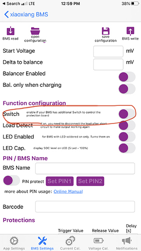

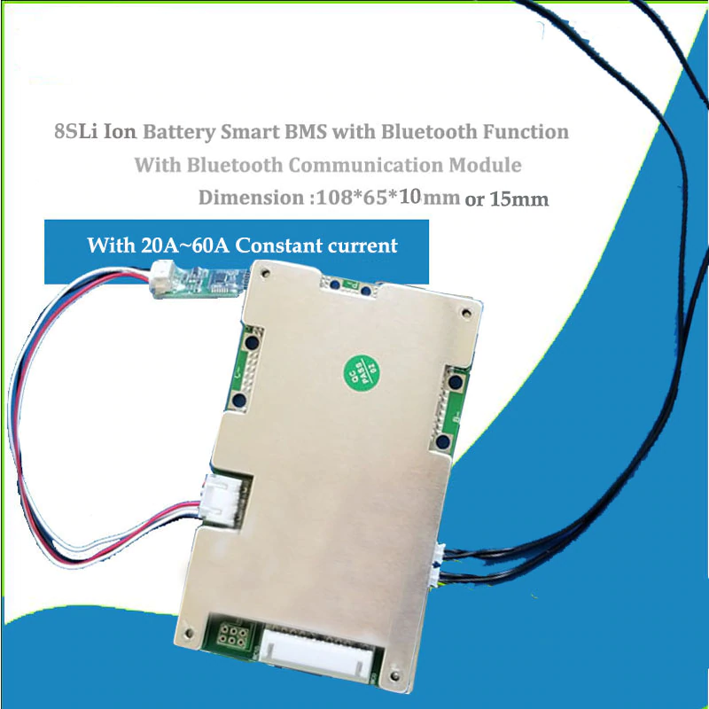

I’ve got a hb83 and built an 8s4p 30q pack.
I used this bms with an e-switch function but i can’t get it to work. The Android app lets me turn the battery on and off remotely but the switch can’t do this. (It seems i need a pc programming adapter to activate this feature which i don’t have.)

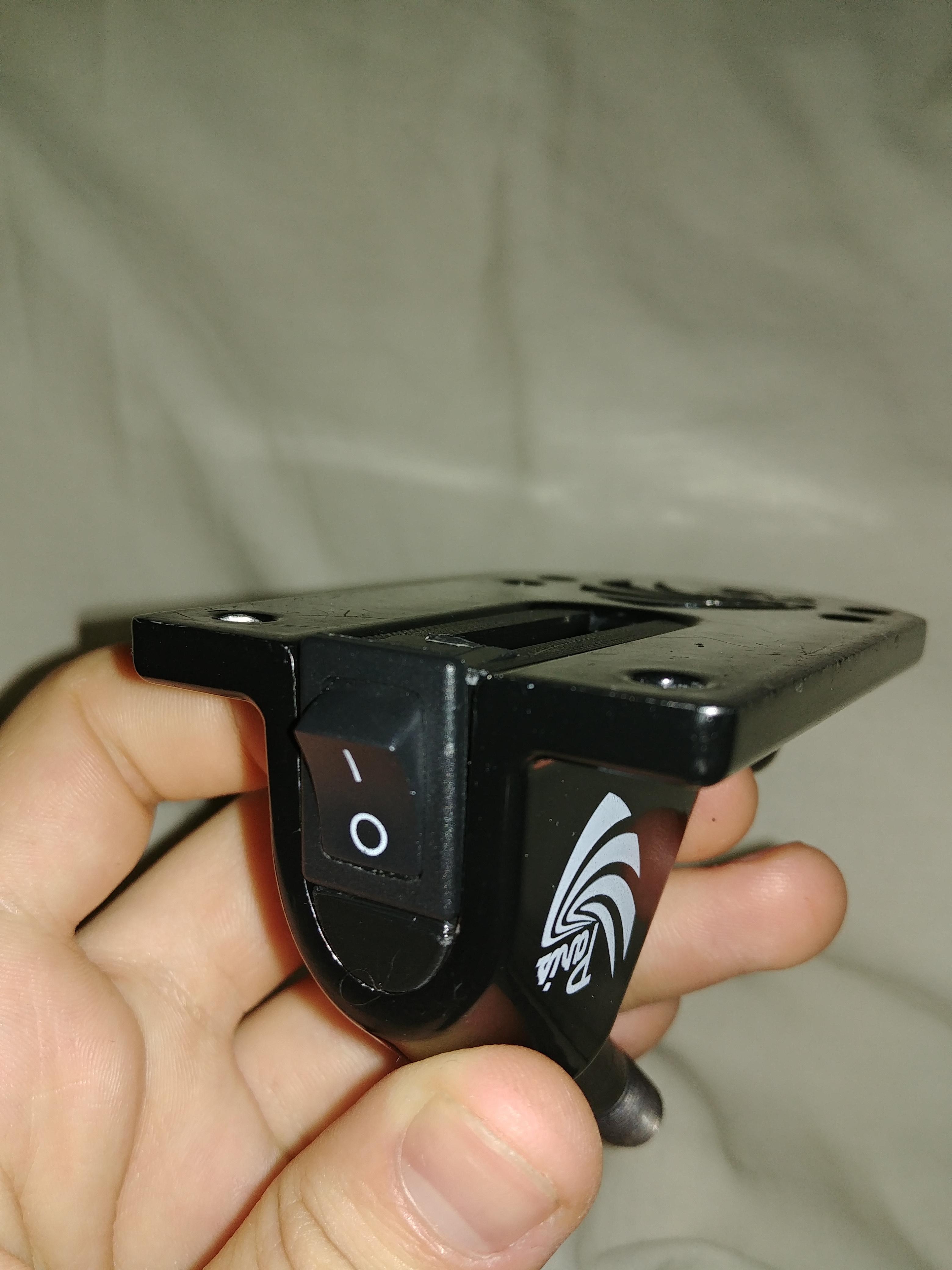

This is the switch I used. Nothing special, just on or off
Now the question:
Does anyone know how to turn the switch function of the bms on without the programming adapter or if this doens’t work maybe someone could sell or lend me such a programming thing.

Latching switch are kind of a bummer bc they like to eventually vibrate to the off position. Which feels like a hard cut (a fall to the ground).
Is that a spst switch? I see why the Bms might have one here, with Bluetooth and friends on that chip, entirely possible you could drain your battery dead if u left it near empty to go on vacation.

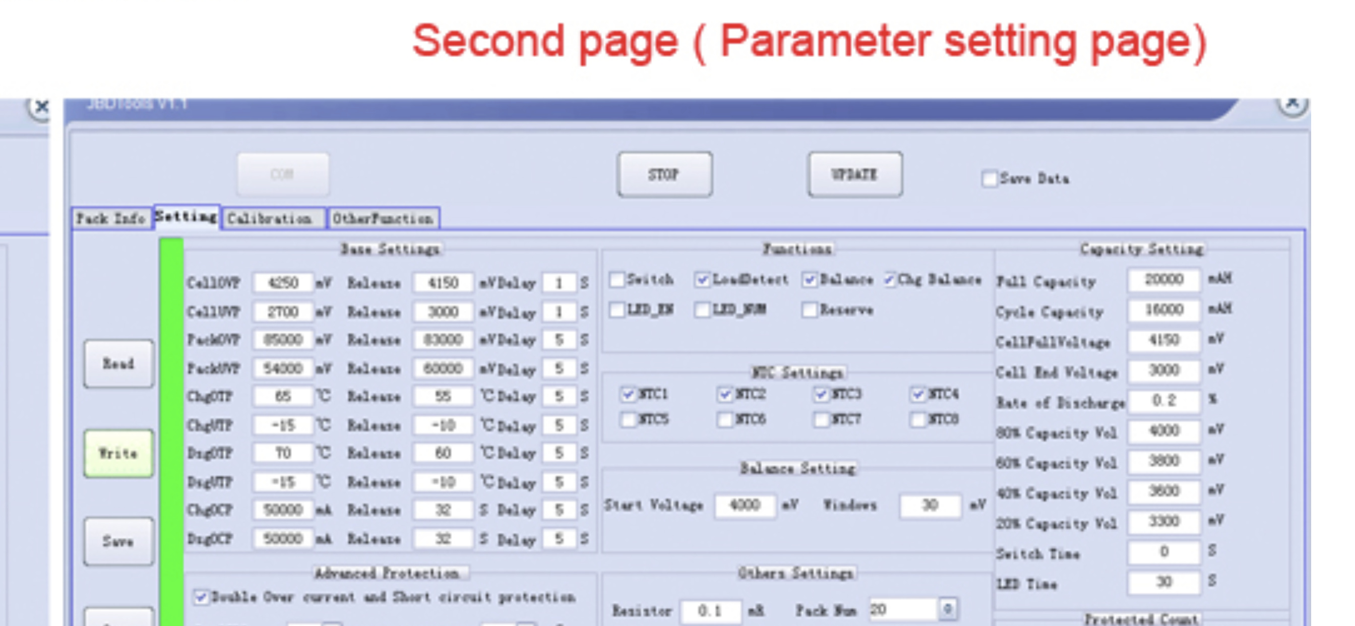

If you do get Bluetooth comms running, see the second page :wink:

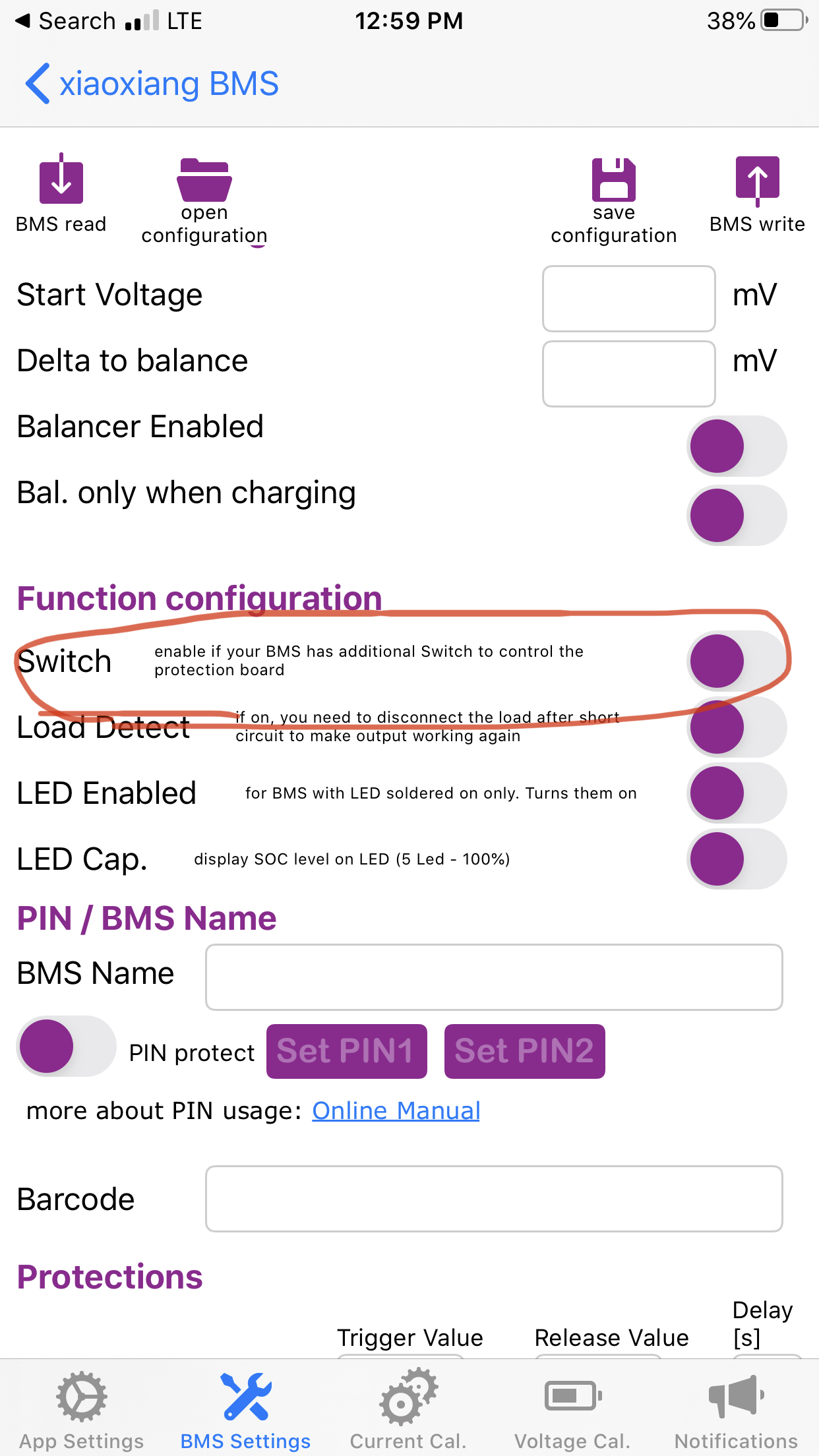

You are able to change this on the IOS app. You gotta toggle it so it’s looking for the power switch to be present. It’s also only in the payed version of the app.
This one won’t vibrate loose. It’s pretty hard to rock over :slight_smile:
Yeah I know the Bluetooth bms drain the battery a bit over time but when the board is finished It’s pretty much sealed shut so I like the idea of being able to monitor the battery without opening the board.
I’ve tried it with the paid iOS app aswell but it doesn’t work unfortunately :confused:
