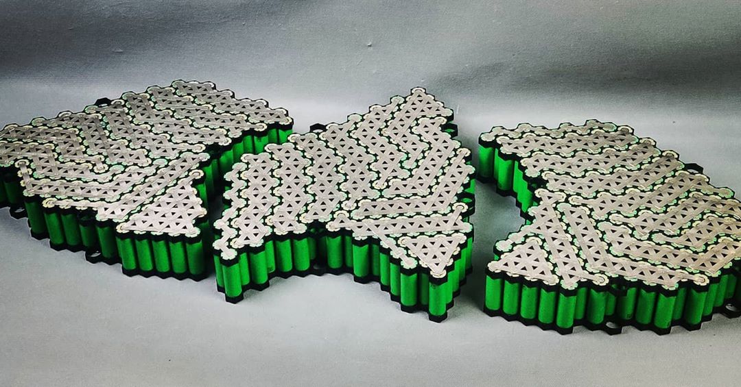

I have a single stack hummie to do here soon with some HG6’s (20650), but I think the only way to get batteries in that cutout without using a router (21700’s don’t fit) is to put the series connections on top like this:
12s6 double stack will probably leave plenty of room under a DS enclosure.

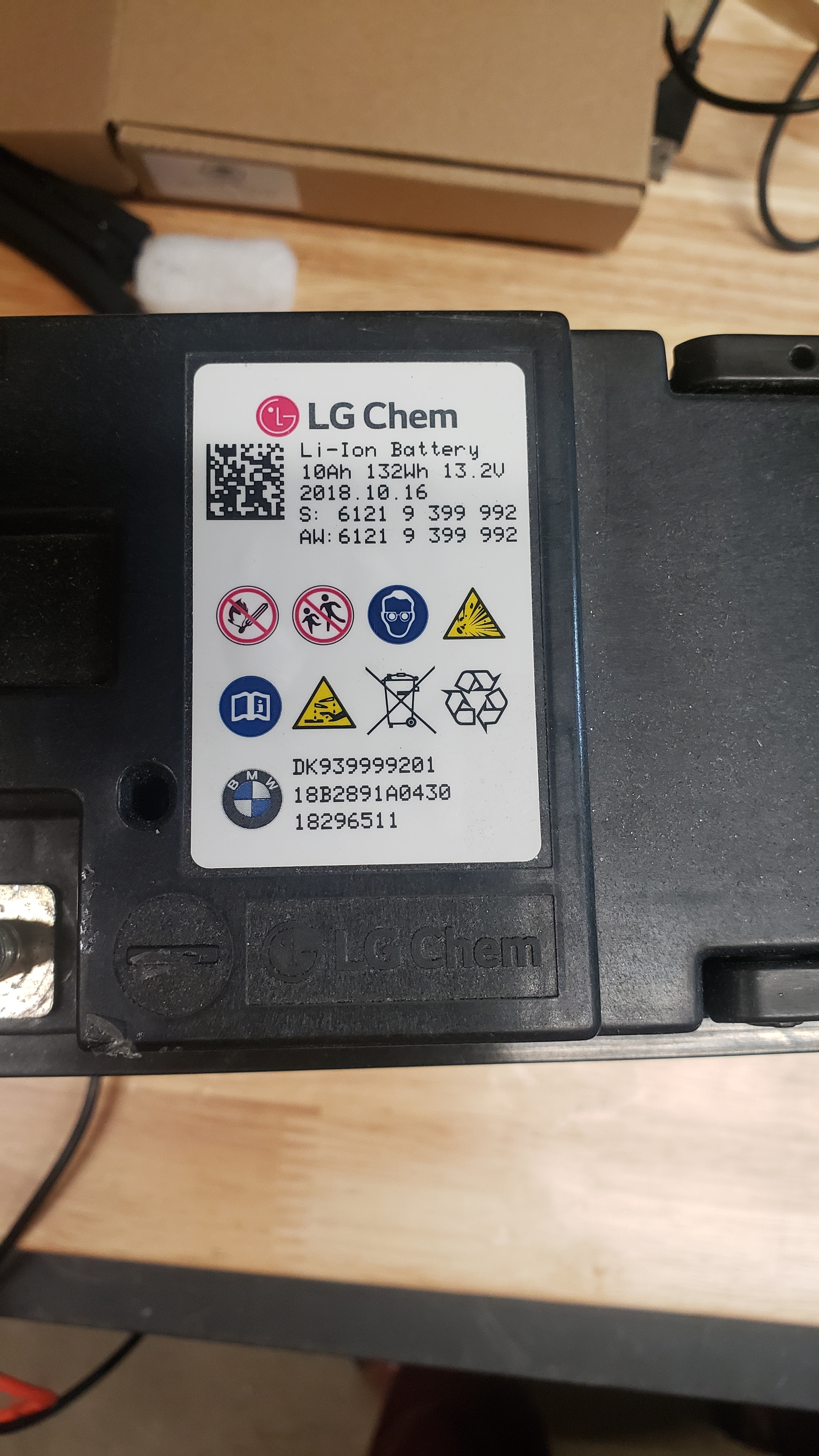

Wondering if anyone knows how I should charge this battery, says it’s a liion, but only has a possitive and negative terminal. Would a 12volt trickle charger work?
It’s an Lg Chem battery I got from battery hookup. I think it is used in some evs
