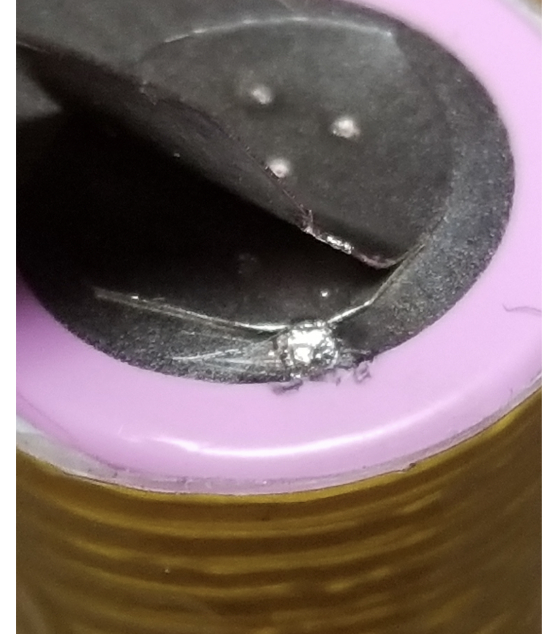

@Resonant did you end up replacing this cell or just let it how it is?
The reason I ask is because I had similar happen from time to time with my malectrics.
Might have been because of not clean probes or not right contact or something I don’t know off yet. Doesn’t matter how much I take care, I have similar happen as min once at each pack I made. It blows through the nickel and a bit into the cell surface.
My question here would be till which point it’s still safe to use the cells?
Is it legit to say it doesn’t matter as long as the cell wall isn’t punctured or can it already have an negative effect if the cell wall thickness is reduced a bit due to that wrong weld :thinking:
I have seen that happen on many other packs as well, but nobody seems to think/worry about that.
So what’s your guys opinion about it?
Pretty sure that one, my hand slipped to the part that had nothing under it, and it pulsed as it happened, may have shorted it on accident at the same time. I’m gonna run with it though, I think it’ll be fine. Though I’m not an expert.

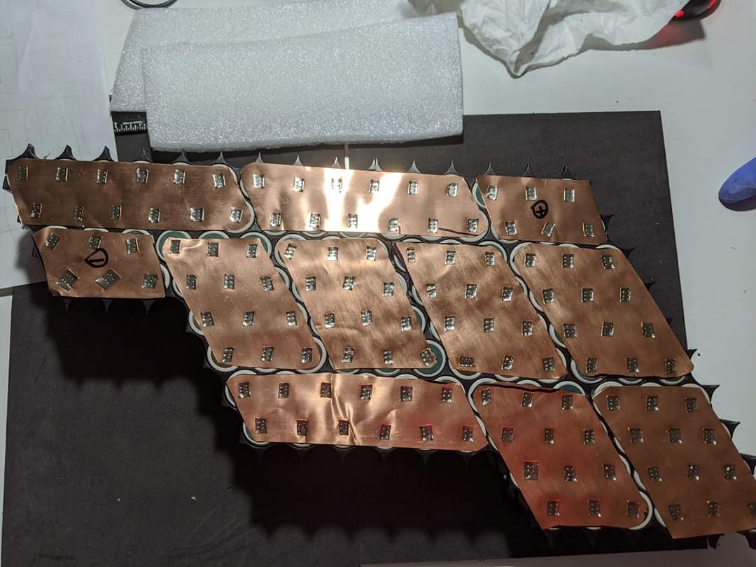

Poached from facebook
He’s used tiny little nickel tabs to weld through the copper to the cell. Genius :ok_hand:
All those super close series connections with no isolation is giving me the spooks but that’s pretty cool!
I wonder if they is any special method or setup that we can’t see. A video of welding a pack like that would be awesome.
True. Wonder what it would take for them to arc
Accidentally dropping a plate of copper on there would probably do it! Or even any tiny peice of metal.
I wonder if there are resources for finding this sort of stuff out ala ampacity charts. Would be cool to see what distances particular voltages and amperages will arc at
