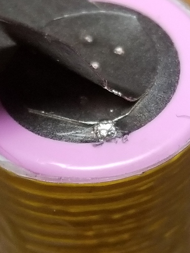

It will burn through. If I Need to make a weld like that I’ve been slipping a spare piece of fishpaper under the nickel, doing the weld and then removing it.
Put the series connections right on the cell terminals. That’ll let you weld them solid. Nickel to nickel with nothing under can be tricky for welding and a folded connection adds a lot of stress.
Do your 3 connections on the terminal. Then put another strip across all the cells to lock it in place and shunt the load to the side cells around the series connection
Ive been welding the pieces that fold over seperare on some metal, since then I’ve welded the P group then the 3 on the middle and the ends over the terminals
Though ive fucked up twice
Dont know if its fine to continue on these
What kind of welder? That usually is caused by not putting enough pressure and an air gap existing between the Tip and materials or the currents way too high
@iamasalmon @ZachTetra @JoeyZ5 like this? welds look like shit, I know =/
Yeah, I messed up didn’t put enough pressure on the second one, though the first I slipped. Would it be fine to continue on those?
I would carefully remove, grind and redo personally
