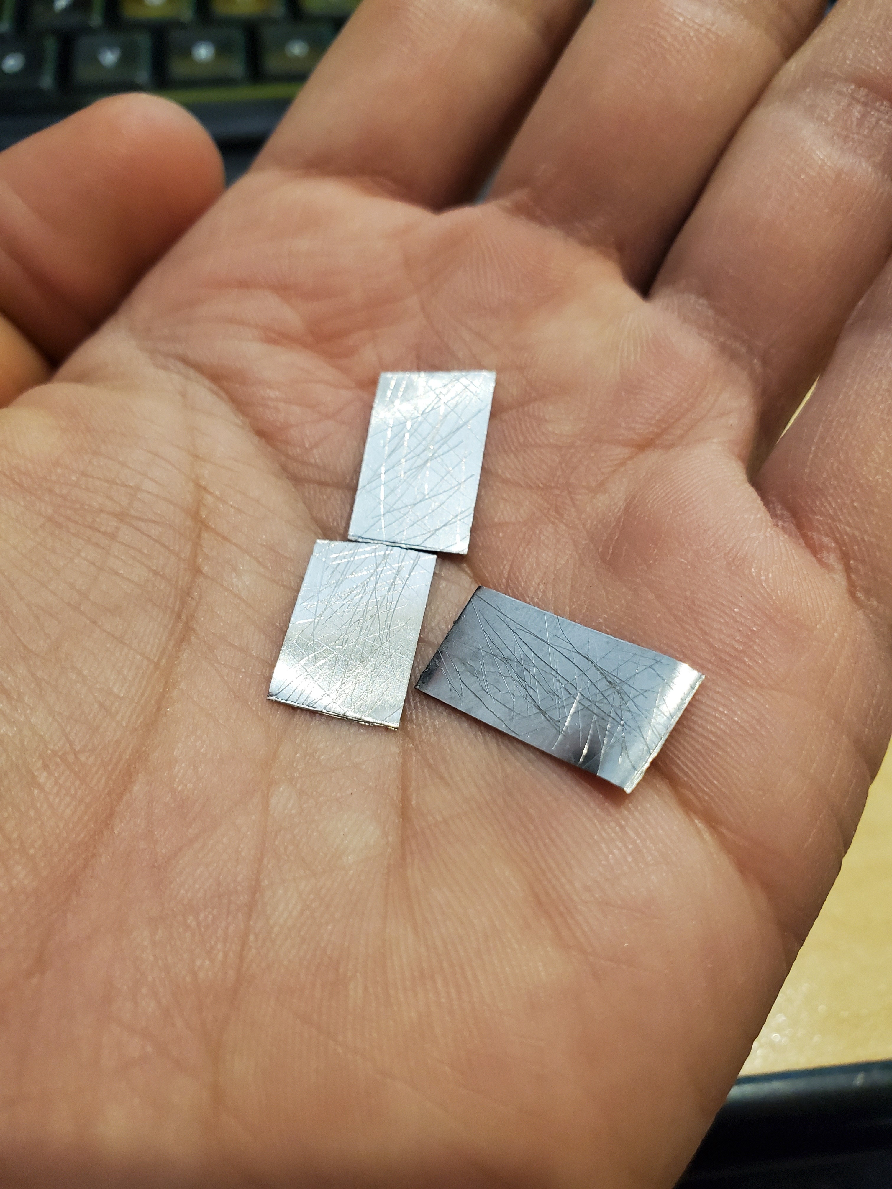

After almost a full day in salt water, looks like this nickel is a go. I might do the spark test before welding, but I am happy with this result.
Here’s the Ebay link for those who are wondering. Shipped quite quickly, US seller.
