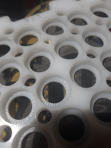

Nice holders, what are these machined from?
I have no idea lol. Some kind of plastic though. Its definitely machined as you can see tooling marks from the bit. Whatever it is, its quality made.
@BigZwatt and I got them with cells from a guy in texas. Besides that, your guess is as good as mine lol.

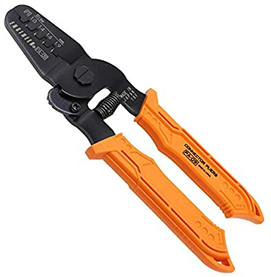

are these the crimpers everyone says are the best for crimping balance connectors?
I’m going to try and make some of these myself but I’m heading trouble finding what type of plastic is usually used. Got some HDPE to try out but I’m not sure if it’s too soft.

yes. well not everyone. but they have the hype. I vouch for them.
This is enough for me to pull the trigger :smiley:

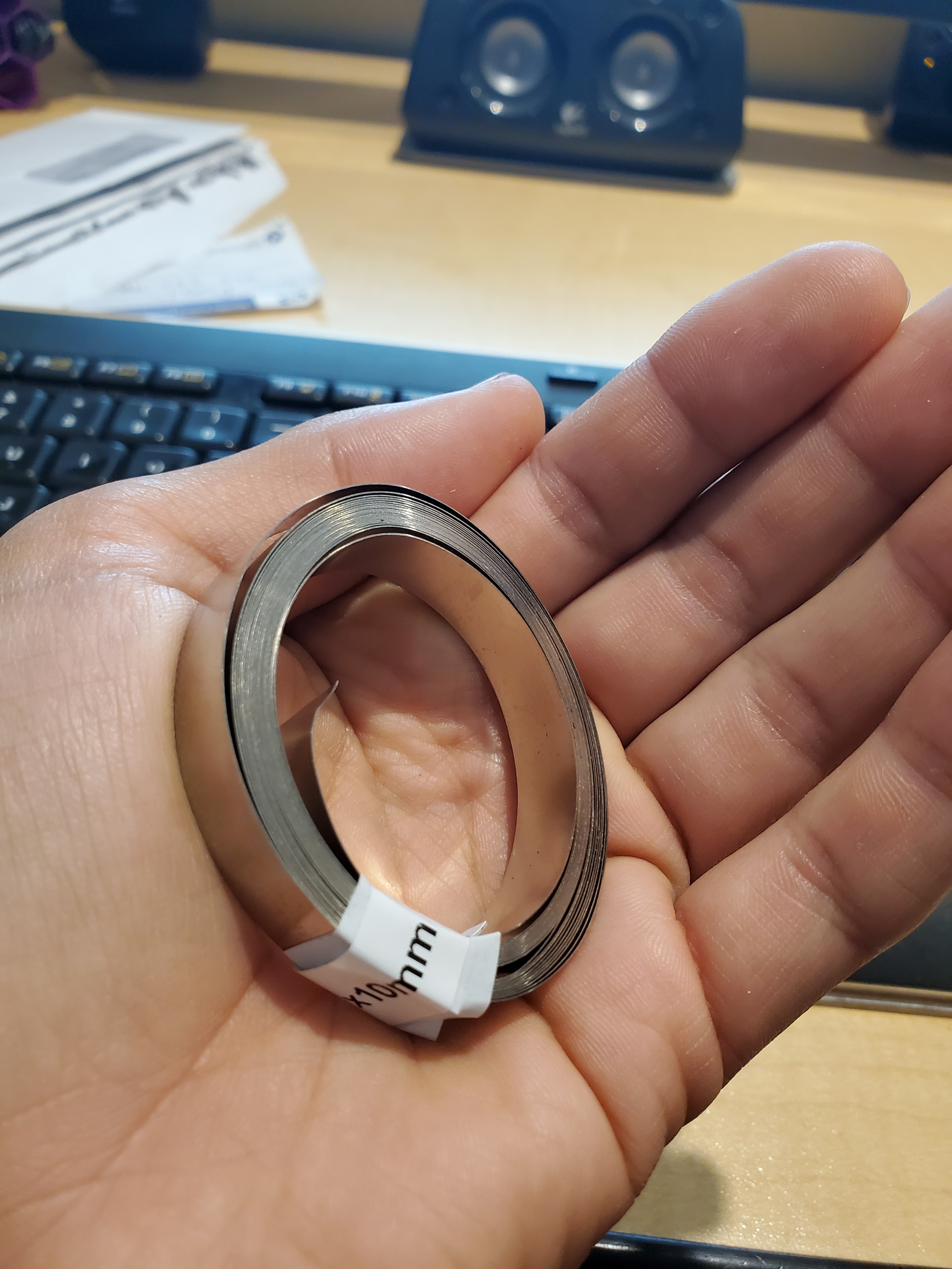

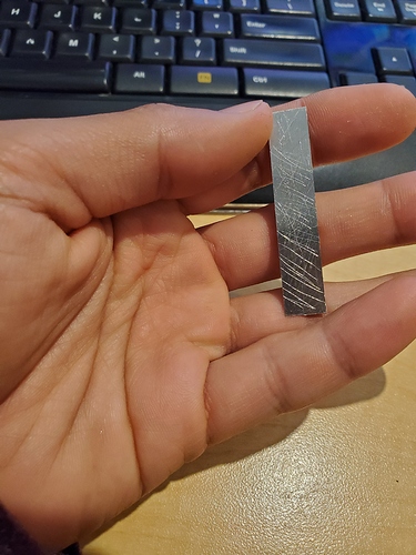

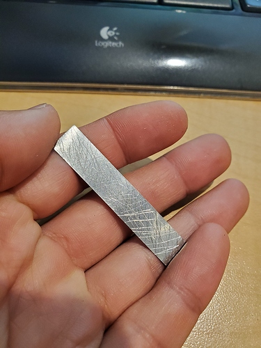

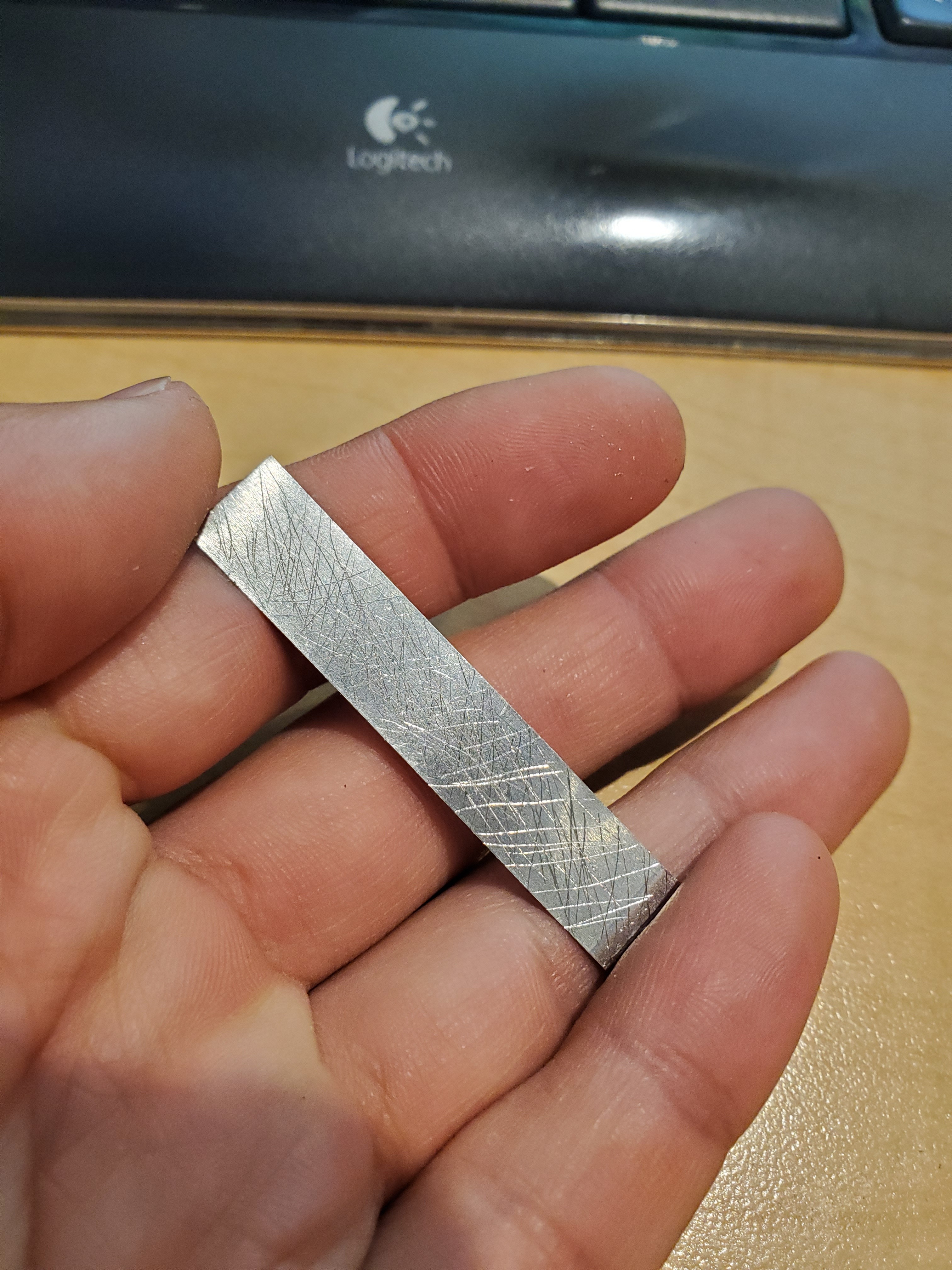

Just received some nickel strip today, scratched it up real good, and tossed it in the saltwater. How many days do you guys usually do this for?
steel will start showing rust in about 30 minutes in saltwater, but I leave it at least overnight to be sure.
edit: you can also do the spark test, hit it with a grinder, should not be sparky

I’d bet $10 that they’re Delrin if they’re machined.
