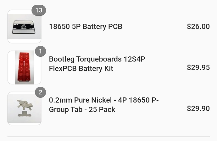

1-2-3…16?!
Is someone testing a Storm Core?
No point not being prepared is there?
You never know your luck.
