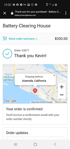

Got 300 coming too!

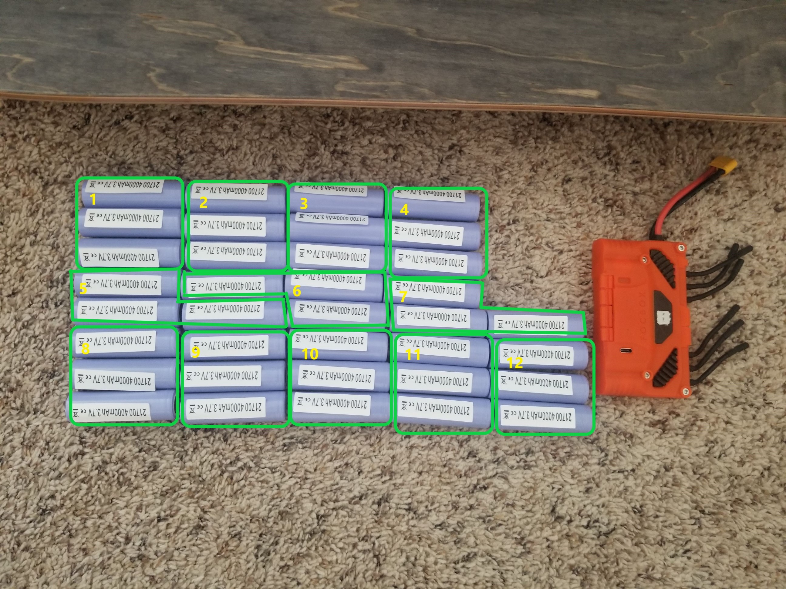

Had to get really creative with this one…now let’s hear it fellas
Lol, great job!

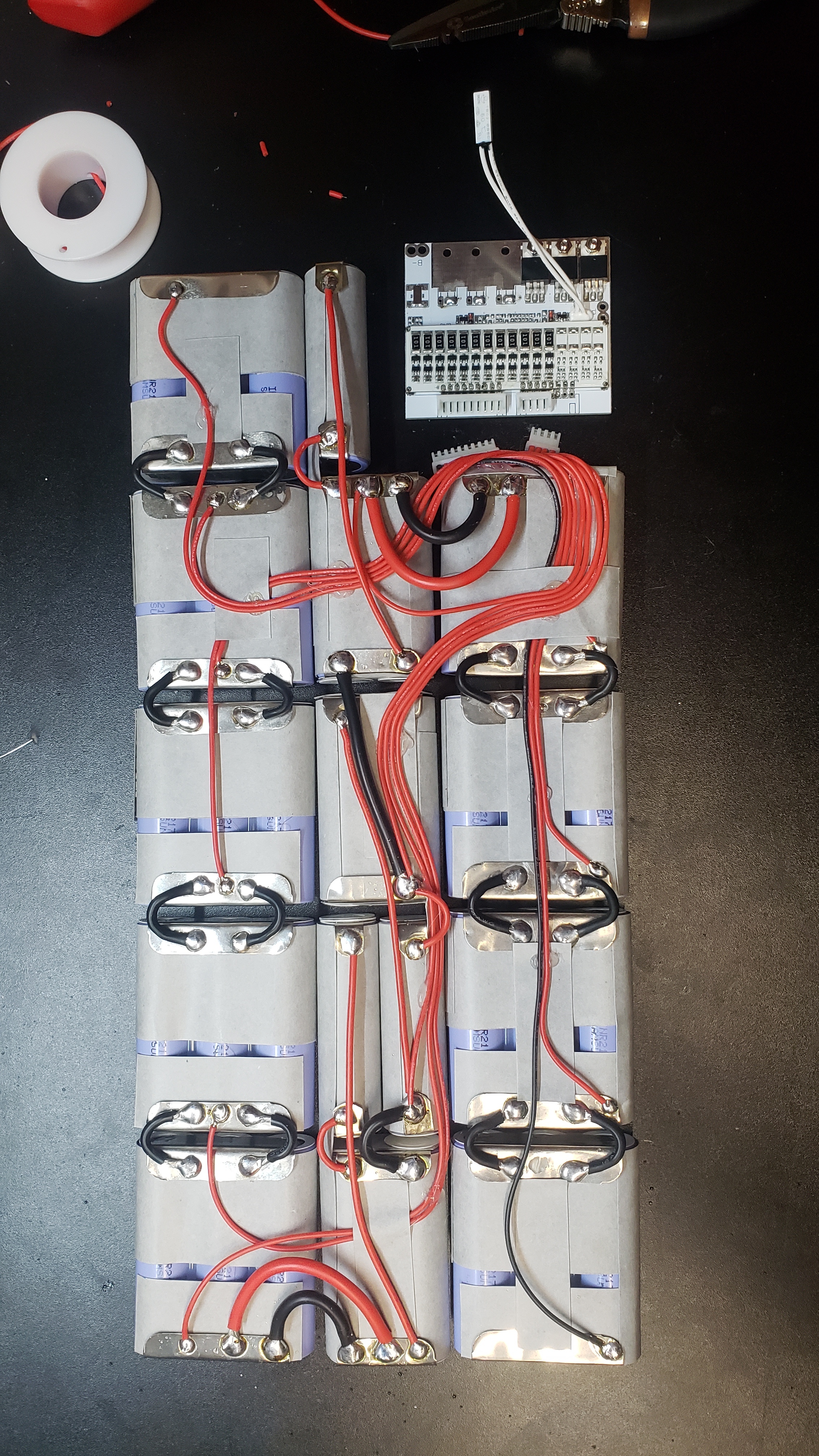

The balance wires seem to pass a lot of nickel edges tho. I’d be getting creative with some fishpaper if i were you.
Yeah, battery could only be 8 cells wide, but had to be atleast 12s3p, I think this is the last time I’m gonna get this creative lol :sweat_smile:
What in the duck :rofl::rofl::rofl:
Yeah trying to see what I can fi about that
Lol :call_me_hand::sunglasses:
That middle group of L shaped p groups was hard to figure out
Clearly. lol. It didn’t fit if you turned the cells 90 degrees?

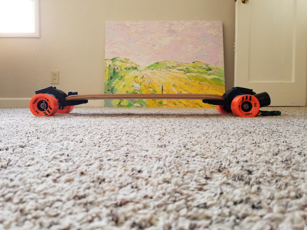

No it’s a short deck, something from Gbomb, let me see if I can find a pic

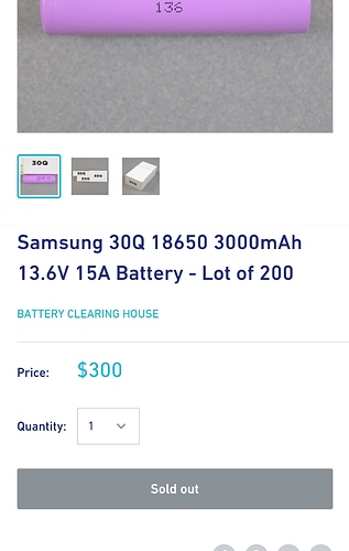

100%. Batteryclearinghouse is legit and has delivered plenty of cells to users here
Those Gbomb mounting brackets take up alot of space
Not sure why pictures loaded like that, but you get the picture. It’s not a traditional set up

Well il be! I used to work on Alameda!

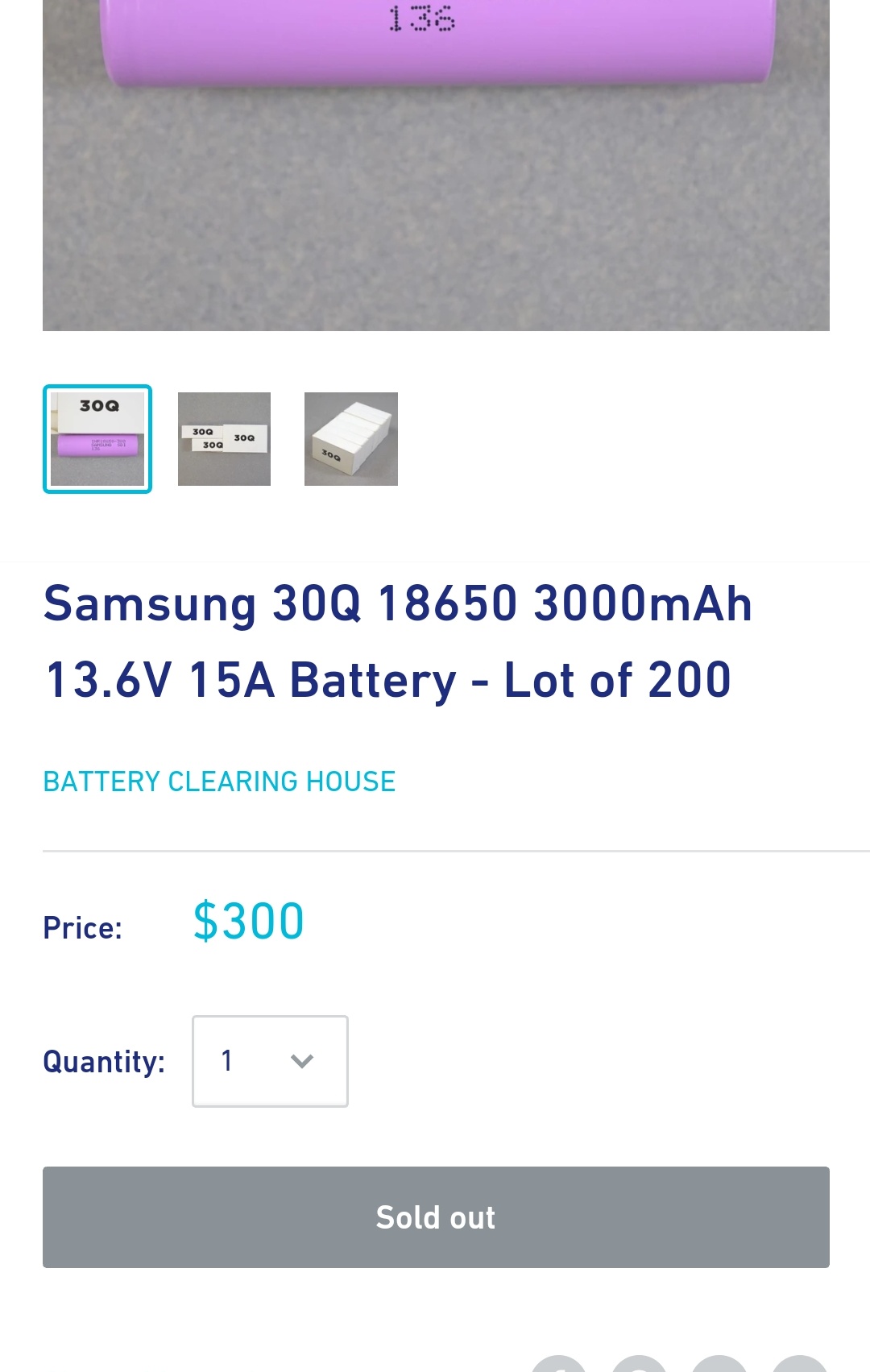

“Cycle life: > 250 cycles”
no pics of the terminals
wait i cant see This listing is for 200 Brand New Samsung INR18650 Batteries
oh I see this is some sort of guarantee
and they’re sold out folks
sold out!!
