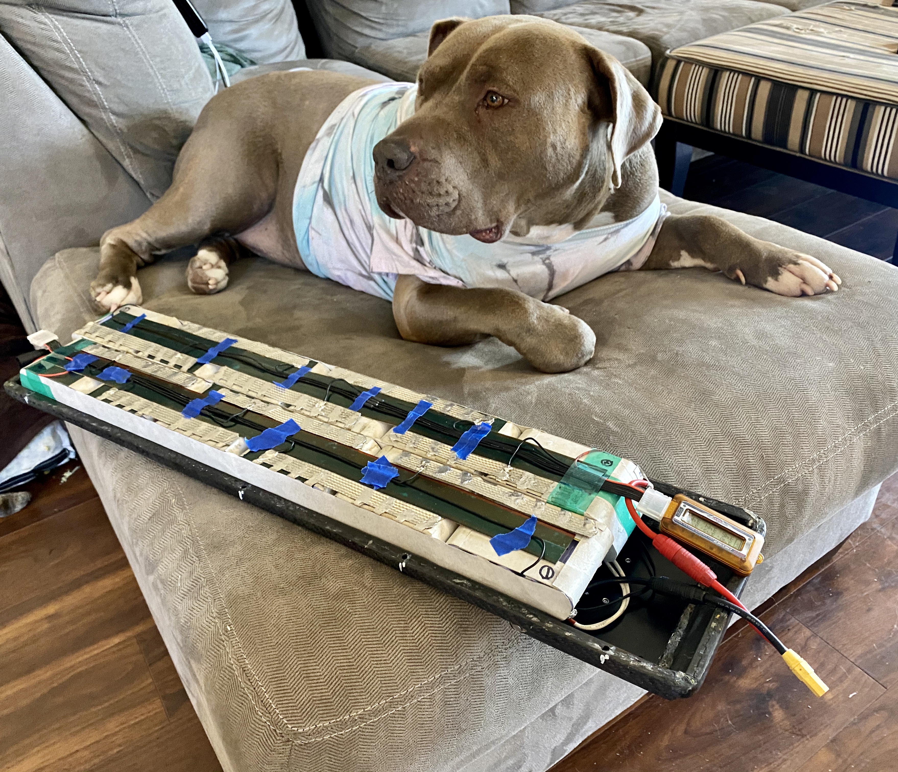

@batterybuilders @EEE, if I have to use an unreasonably long balance lead, should the red wire be the shortest?
This pack is a being wired as a 6s pack with 7 wires to use an external balance charger.
I know some Gensace lipos are configured in an extra long 12s config that also has long leads.
@Jansen done.
Standard charge rate is 2a a cell per Samsung 40t Spec sheet. So I guess I need a 20a charger for (6s10p)*2.
In raw cells, it’s 8.4kg (18.5 lbs)for 120 cells at 70g each.

Sooo tempted by those cells! Were you able to spotweld to the tabs? How did you make the connections?
@whaddys
This is my spot welder undo button.
These foil crimps worked great, got them off @Arzamenable, not sure where he got them but I think these are the ones. .
https://www.digikey.com/product-detail/en/te-connectivity-amp-connectors/329657/329657-ND/2259050
The problem with these cells is they’re so huge. 10s 2p where a 12s5p made of HG6’S fits with room to spare. The box it’s going in is 12" x 6" x 4.75"… barely any room left for a thin PB&J sandwich
Oh wow! I did not realize how big they were!! Daaang!
