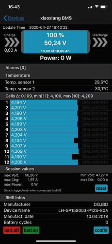

Hey guys… So I upgraded my battery from 12S4P to 12S6P and was not able to test out the whole setup because I did the upgrade in the winter time. I also decided to not fully charge the board before winter hibernation mode.
So today I did the first full charge and it came out like this:
Is this anything to be concerned about ?
I will try to use the board this week to get a discharge / Charge cycle in the mix…
those cells are out esp. group 11. leave it on charge for couple more hours and monitor it.
hey… sadly my BMS and charger combination wont let me charge it further as it automatically turns off
what do you mean? the BMS can still keep on balancing even if the light is green on the charger
